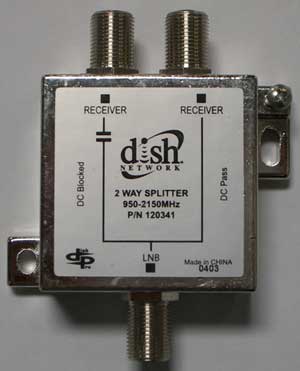

just get DP single LNB and get DP splitter it looks like legacy 21 switch put it behind 222 it should work

DP SINGLE LNB, and a DP approved satellite SPLITTER (not the separator included in the receiver) at the receiver. The check switch will show like this:
119
ALL
FEED
It's a valid configuration. Both polarities will be present and there won't be any diseqc conflicts since there's no switches in the system.

What is a DP Approved splitter? Do you have any links to see it?. This is something I havn't heard of yet?
This basically turns a DP SINGLE into a DP DUAL. No switching and voltage is constant on DP.
here is what i was talking about. we us to use them before DP duals came out
So you are saying if I don't have a quad LNB then I can take 2 duals and 2 DP Splitters and run them to say....4 311's? and they will all work fine and pass DNS QA's?......... They are the same as a 21 switch?
