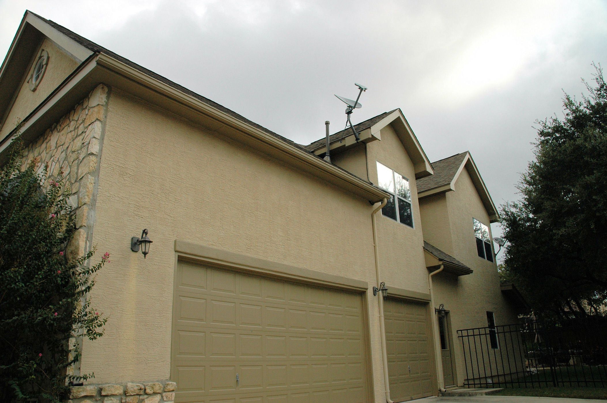

I was wondering if there is any way to get to the mounting point from an attic area? Even if you had to drill through the concrete and wood you could install some kind of blocking or bracing internally that would support the dish. I know that my installation was beyond the capabilities of the D* installer. Granted it was too high and too steep of a roof pitch for them. Took me a couple of weeks but I finally came up with the idea of calling a local firm that advertised they did home theater design and installs including custom cabling, satellite, computer wiring, etc. Figured they might have or know a private installer they used and trusted. Bingo! They referred me to Bob and a week later I had my new Slimline up and running. Among his many talents he does stuff like replacing navigation lights on television and radio towers. Heights don't bother him and he has the equipment. Yes, it cost me $400+ for parts and labor (had to buy my own Slimline) but I'm set. After it was installed I went back to D* and we worked out a package to offset some of the expense I went through to stay with D*.
