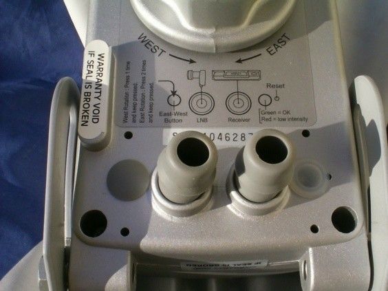

Here are some links and specs on this popular motor have a look before the setup, always a good idea to have your true south satellite already stored in your receiver using a fixed dish before adding a motor......

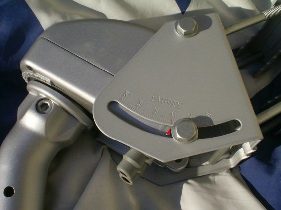

Beware as one side of the SG2100 is marked for ELEVATION and the other is marked for LATITUDE.
