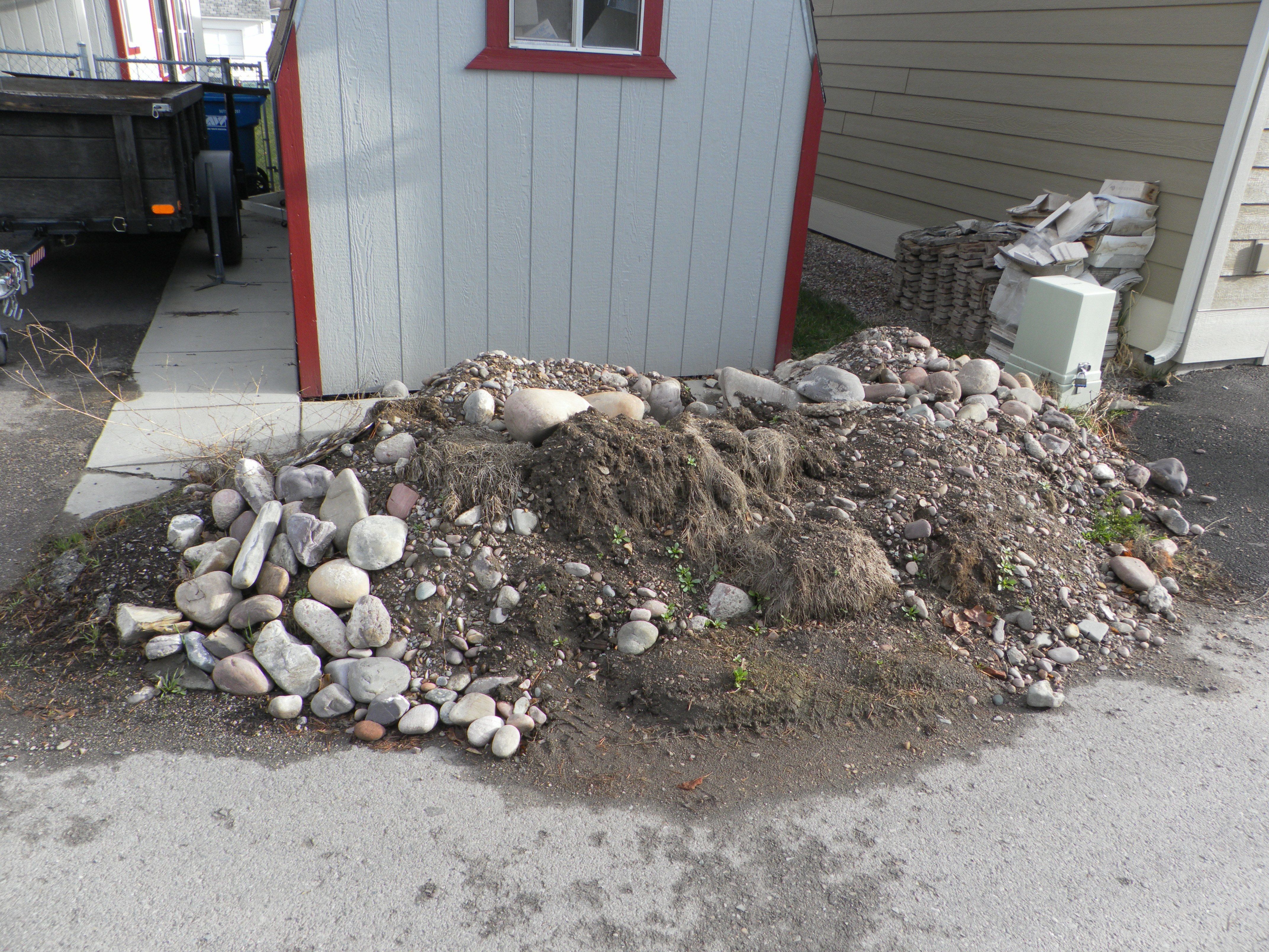

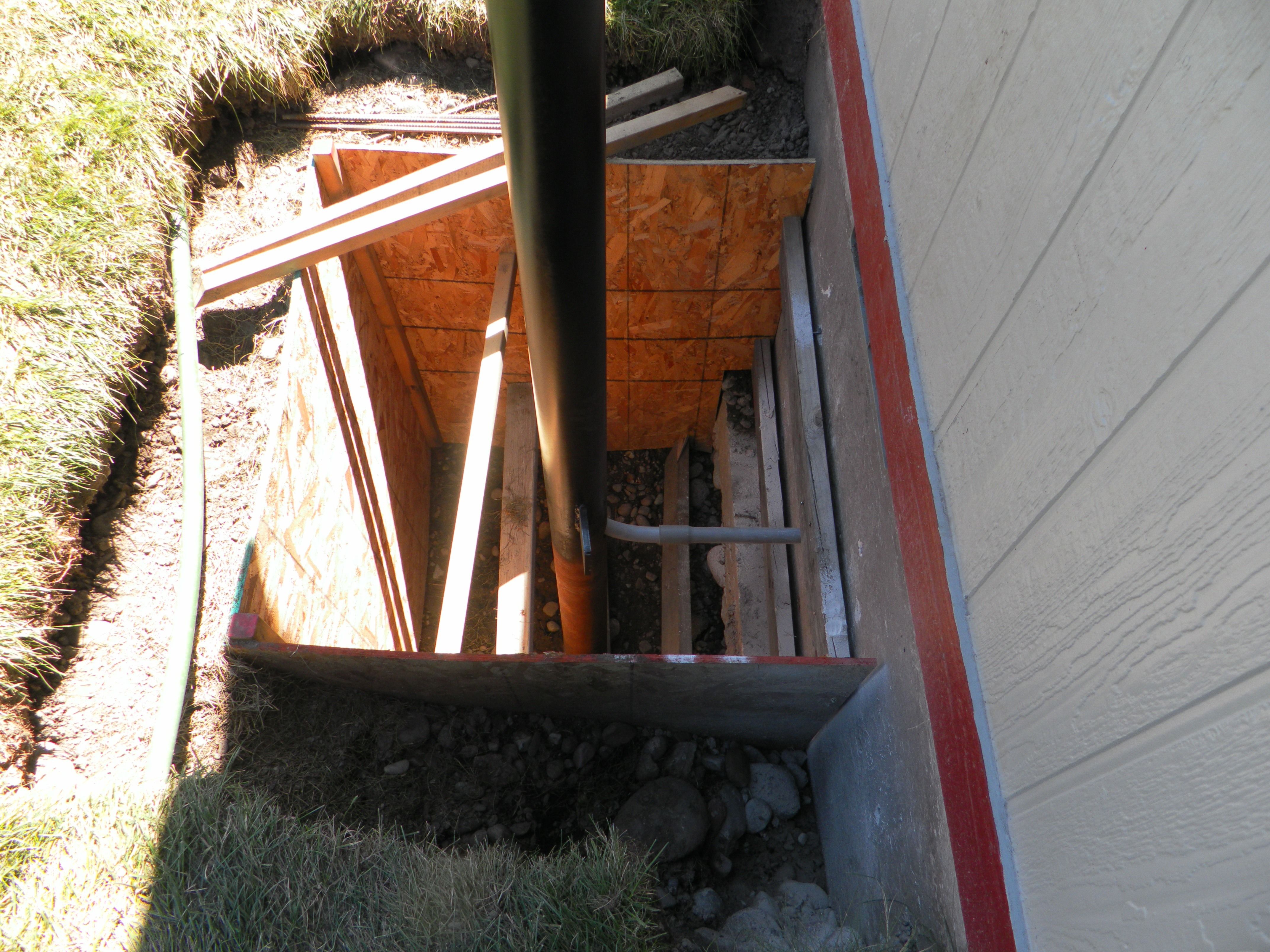

Depends on the kind of ground you are digging in. In my case the ground would cave in to easily. I had to use a form. But the rocks were so big I wished I used a backhoe.
That crater of yours looks exactly like the hole I dug by hand for my 62ft ham tower! I forget how many yards of concrete I poured that day.
Here I only had to dig 3 1/2 ft post hole for my 7 1/2 ft C Band. No rocks. Two bags of quikcrete.
