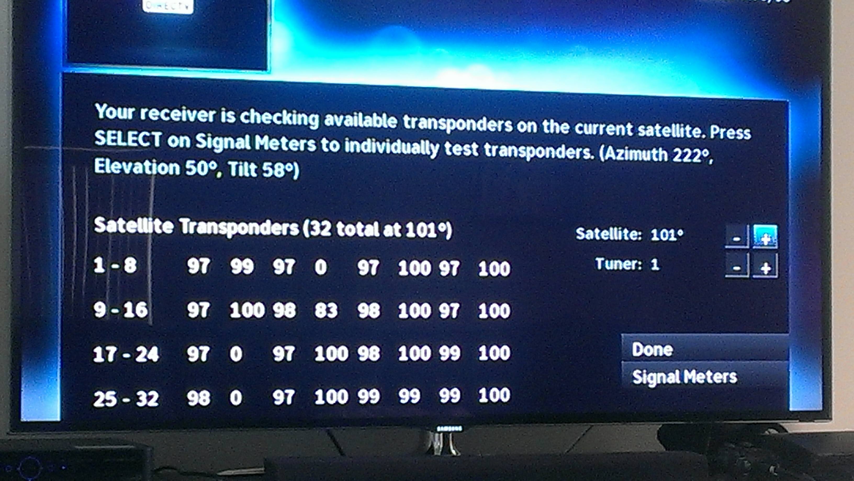

Please have patience with me =) I'm trying to install a Slim 3 Satellite, and connecting it to a H24 Receiver. I get signal for Satellite 101, but am not getting any HD Channels. It's a multi switch, and I have the BBC's connected. I'm also only using ONE tuner at the moment.

I assume you mean you have an HR24 since you say you are only using one tuner.
What are your signal strengths on 101 (list ALL transponders)?

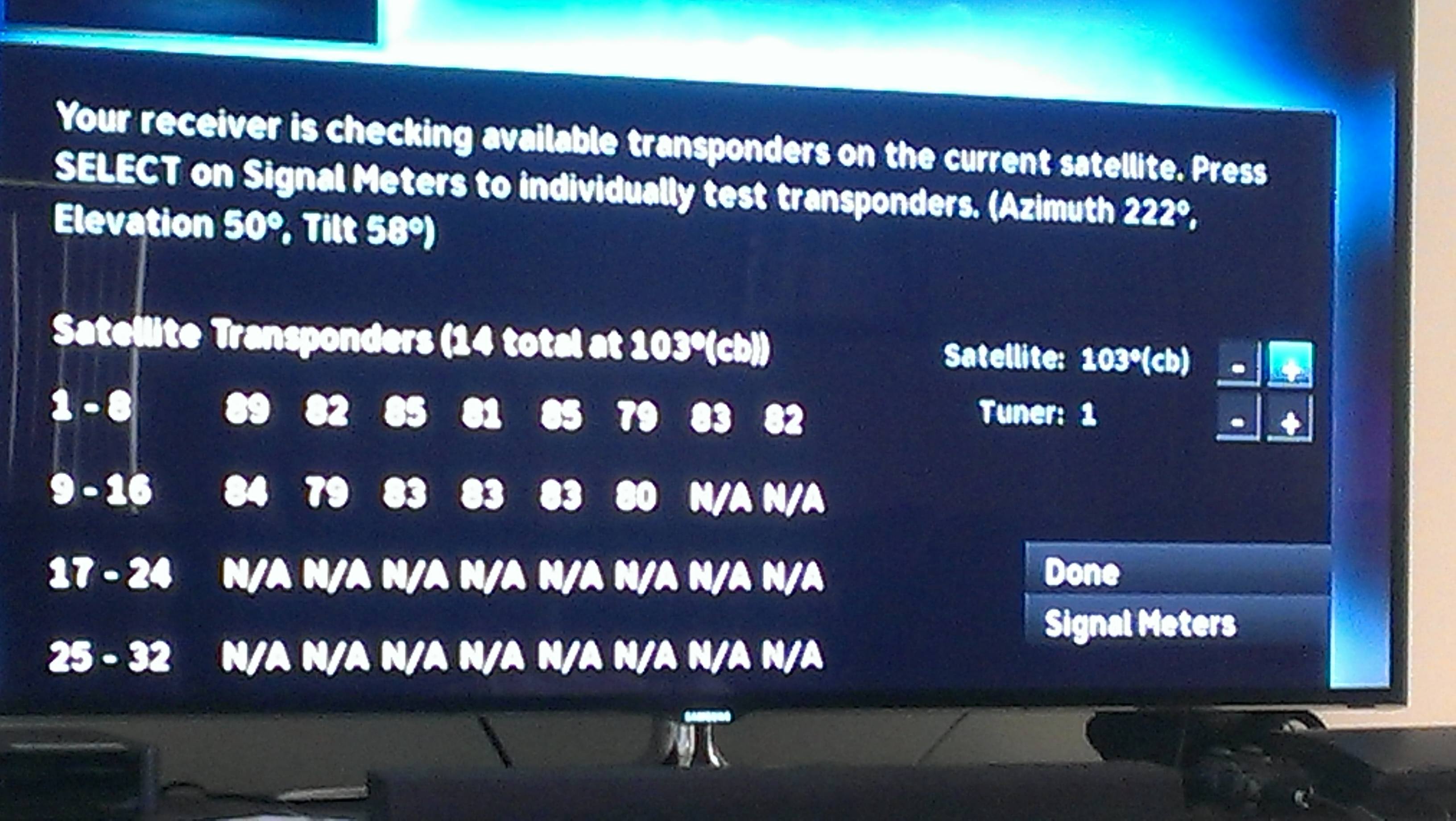

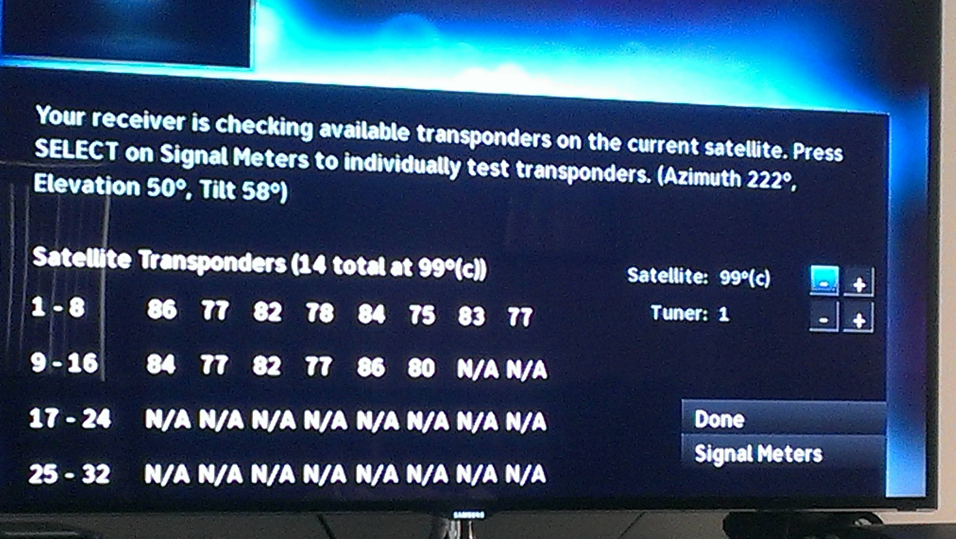

Similarly for 99 and 103?

Signal Strength for 101 is:
99c and 103bc I get:

A plumb mast is perfectly vertical. If not, it can affect the signal strengths. Did you set the dvr to use only one tuner? Check to be sure you have the hd channels set to "show hd channels". With those signal strengths, you should be able to view them. They could/should be better, but they are good enough for now.
Agree, those signals are sufficent to get video.
