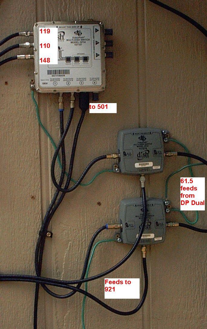

SO, the cheapest way out, is D1000 with the old DP-Twin feeding the DP34. Run 2 feeds from the 129 DP-Dual LNB that comes with the D1000. Those 2 feeds go into a pair of DP21s to drive the 921 with 4 birds - just like my sig shows, except I'm still on 61.5 instead of 129.
This means he can keep the Legacy box (which must be using a DP Adapter into the DP34 right now).
He has to swap in the old DP-Twin because a DPP-Twin has trouble feeding a DP34.
As for hooking up the DP21s, put a DP34 output into DP21 input #1 and the 129 feed into DP21 input #2. Repeat with the other DP21, and run their outputs to the 921.
Here's a labelled pic of my setup. Please no criticism of the cables - I just grabbed some junk jumpers off the van to hook it all up. :D
