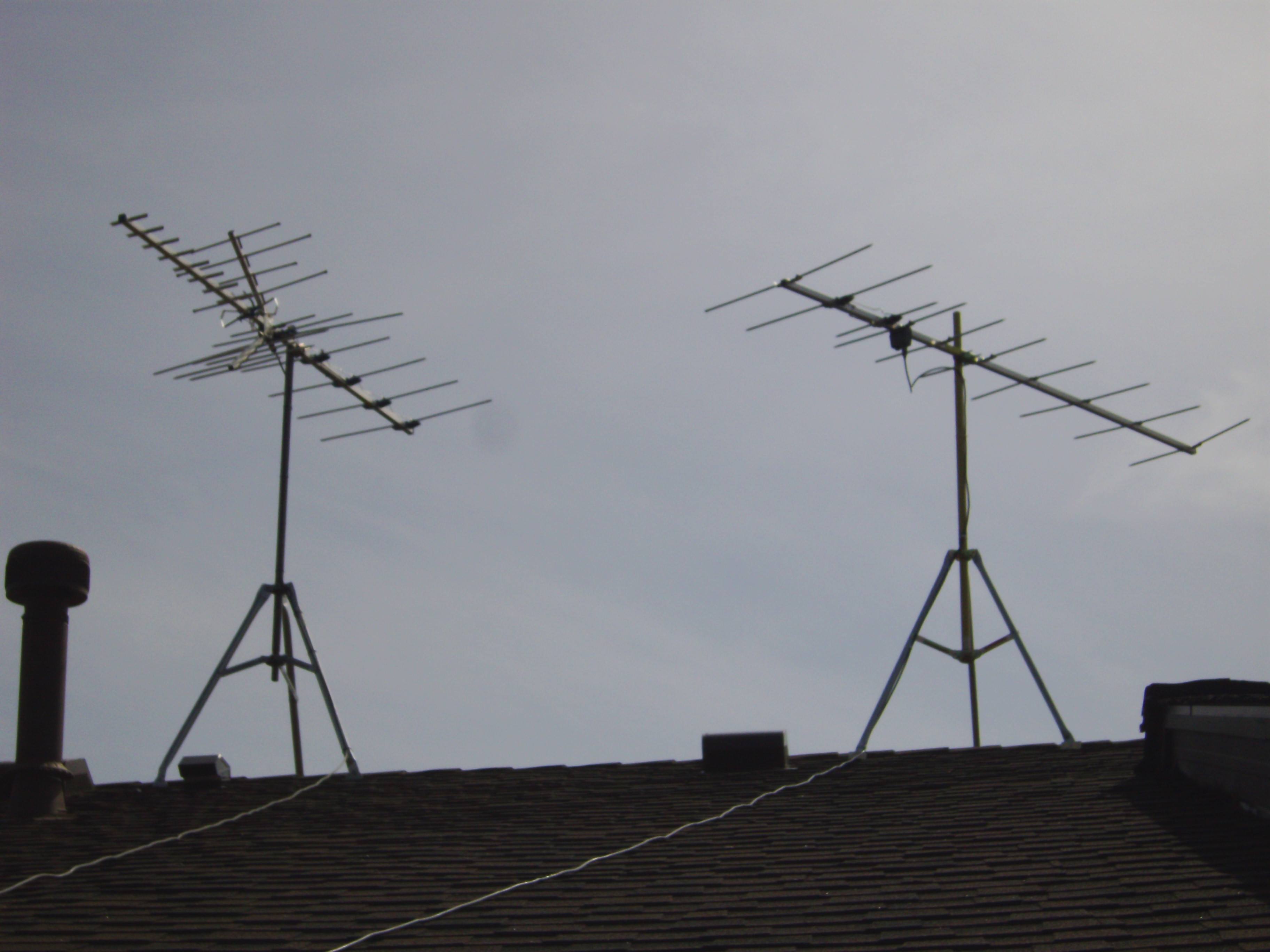

Here is my HBU33 (the one on the left)...I've since upgraded to the HBU44 which is pretty big
(the other is for a VHF station 72 miles away that I can get)

Since you live in an apartment you should only go with a flat antenna. Not only would the elements on a long yagi be at a likely dangerous eye level the large antenna would invite trouble from your landlord. I used to live in an apartment complex where any outdoor antennas were grounds for eviction so it might be worth looking into first. Even if that is the case there are plenty of stealth antennas that are a flat panel antenna in a plastic box. It would blend right in with your dish and average folks wouldn't even recognize it as an antenna. If an outdoor antenna is really ok then a flat 4-bay like the DB4 Iceberg mentioned above should work great for the locals.
