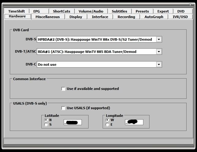

I have a windows PC with two Hauppage tuner cards in it.
I have an HVR-1250 ATSC OTA tuner - http://www.hauppauge.com/site/products/data_hvr1250.html
and a WinTV-NOVA-HD-S2 - http://www.hauppauge.com/site/products/data_novahds2.html

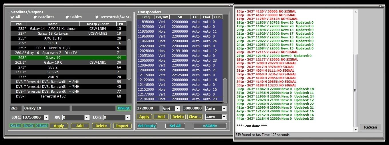

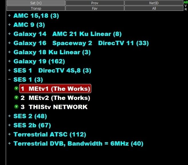

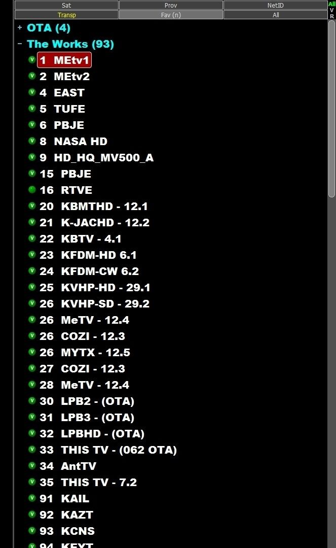

I've posted some screen shots below.
Anyway, here's what's been happening. A week or two ago I tried to watch Doctor Who on EBRU G19. There was no signal. Hmmm.. I checked and the weather was clear, it was cold outside and everything else was coming in fine.
Then I recalled that the plastic over the LNBF (it's a Direcway) had disintegrated and maybe ants had gotten into it again. A few years ago that happened and shut it down. Or maybe a spider made a web in it.
So I go outside with a can of compressed air and blew out the LNBF, just in case. It was dark and I couldn't really see anything in the tube but blew it out anyway. I went back inside and bingo, the channel was back on.
So I watched a few episodes and all was well. Then a few days passed where I didn't watch. I saw Doctor Who was on again so I switched to that dish and once again I had no signal. Well bummer.
I go back out again with the compressed air and hit it a few good shots but I didn't get a signal this time. Then I thought maybe it had to do with the big changes they made on G19 at New Year's so I downloaded a current .ini file for Galaxy 19 and tried to rescan the satellite. Horizontal transponders all came in but not one single vertical transponder would scan in. Well it was like 11pm at night so the next day I went outside and took the LNBF off the dish, thinking it had either bugs or water in it. I took it completely apart and got to the circuit board inside. The pathways were all clean and clear and the circuit board was also clean and dry. I could see nothing at all wrong with it. So I cleaned everything up extra clean, like new and put it all back on the dish. Still no signal on vertical. So I was thinking MAYBE the switch was bad. I replaced the 22khz switch but that didn't do it. I swapped out the Discque switch but that didn't do it either.
I then removed the switch completely and just ran it straight through, still no vertical. Then I took my little meter outside, it's that little handheld meter that also has a screen and a tuner built in. I hooked it straight to the dish and I was getting all of the horizontal and vertical signals as if nothing was wrong. It worked perfectly as it should. So then I go into the house and I remove the wire from the back of the PC and connect it to the meter. Still working perfectly, getting everything as it should be. I put the wire back on the PC and then it's back to no vertical again. :wtf:
The very same tuner card however was tuning MeTV, Movies! and Bounce plus the other stuff on SES1 C-band. Weigel stuff on SES1 is vertical. Why would it tune C-band vertical but not KU vertical?
Both signals are fed to the same tuner card over the same wire.
The other tuner card, the ATSC OTA tuner card had no issues at all, it was functioning perfectly but I wanted to mention that since it is an integral part of the whole thing.

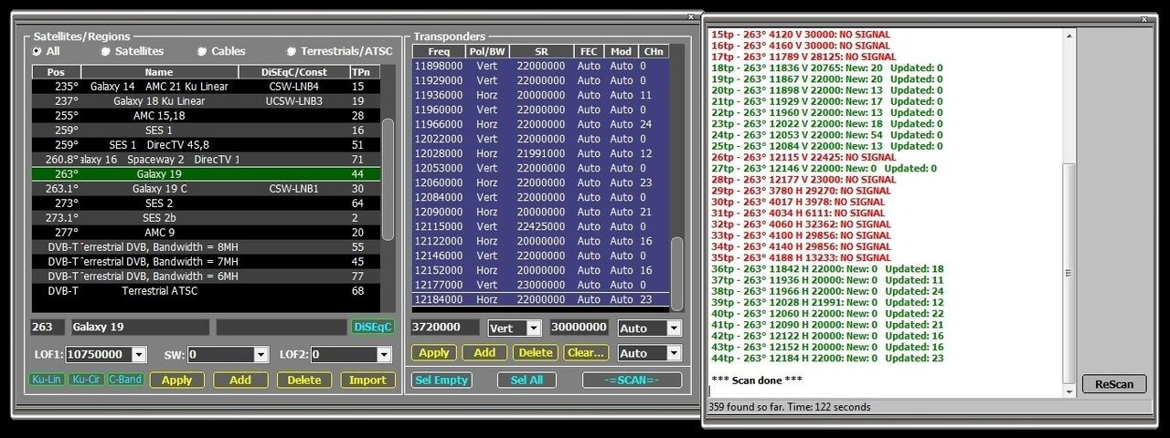

I tried numerous times over the next several days to rescan G19 and every time I would get only horizontal transponders on KU but when I put my meter on the wire it picked up everything perfectly.

I assumed that the KU circuit in the card must be flaking out so I gave up on it for a few days and decided I need to start trying to figure out how to replace it. It seems these cards are not very easy to come across anymore. :cry:
I was about to compose this post and I wanted to get a few screen shots of it showing how it wouldn't scan any vertical transponders so I ran the scan again and all of a sudden it's working again! :wtf:
Now I'm totally confused. I don't know what to do and now I don't trust this thing. I'm sure that it's either the tuner card or the app. I know of no way to test to determine if the app is at fault.

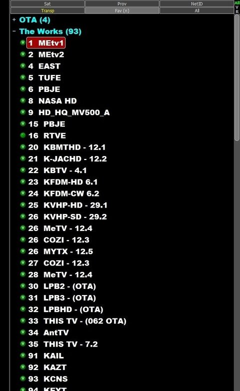

(The channel list shown below has a lot of old, dead channels in it that I haven't gotten around to cleaning out yet.)

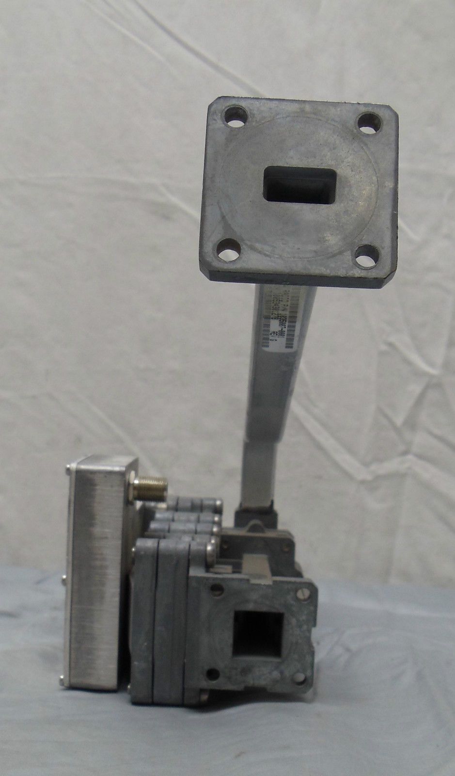

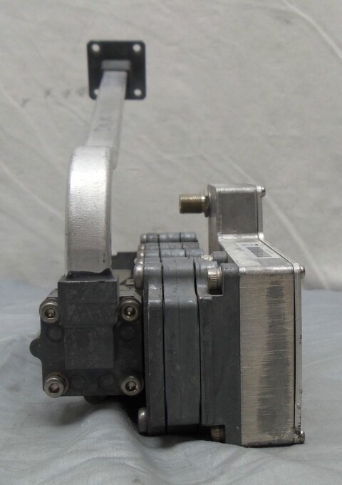

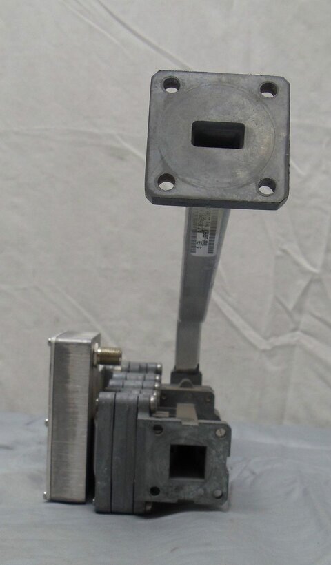

The problem sounds like a polarity voltage switching issue. 13v = Vertical and 18v = Horizontal. The point at which the switch is made is around 15.5v. Now if that threshold has changed in the LNB and dropped to under 15v and the PC tuner is putting out a bit more than 13v vert then the LNB would appear to work only in Horizontal polarity with the PC tuner and not other STBs. You would need to measure the voltage output from the pc tuner to verify this, or swap out the LNB?

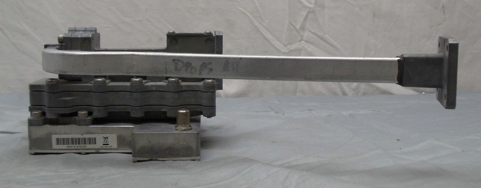

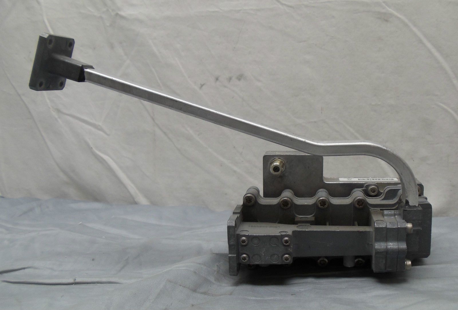

Hmmm.... So what you're saying is that it still could be the LNBF? And, it could maybe be the tuner card?
Today the silly thing is working as it should. So I'm totally lost as to what's going on.
Today it's raining and really nasty, cold weather so I'm not going to mess with it. Maybe later in the week if it dries up and warms up.
This is the closest thing to an actual winter that we've had in quite a few years and it's not at all conducive to outdoor activities.
Considering that it uses it's own weird LNBF that can't be swapped out for anything except an exact same type. I was lazy because of the rain so I borrowed photos of one from ebay where I found a replacement for about $40.
It's so weird that it works great sometimes and other times, not at all.
I am baffled as to why it would operate the C-band stuff just fine but not the KU.
I'm thinking that maybe I should put together a different dish that will accept a standard 40mm LNBF. I have a PLL type I can use.

The fact the C-Band stuff works ok and it's just the KU is what really makes me think it's the LNB.

I hope it's just the LNB.. If that's all it is I'll be happy. I would rather not shell out for another tuner card at the moment.

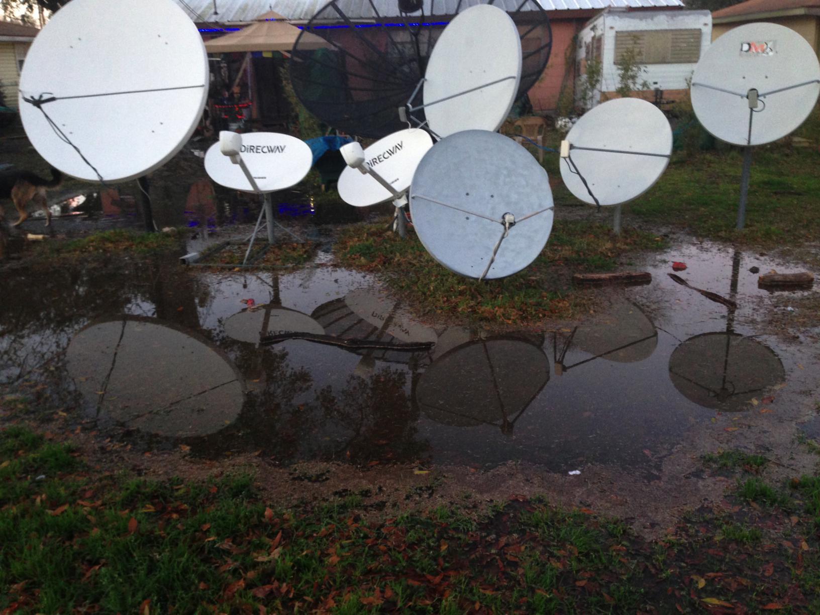

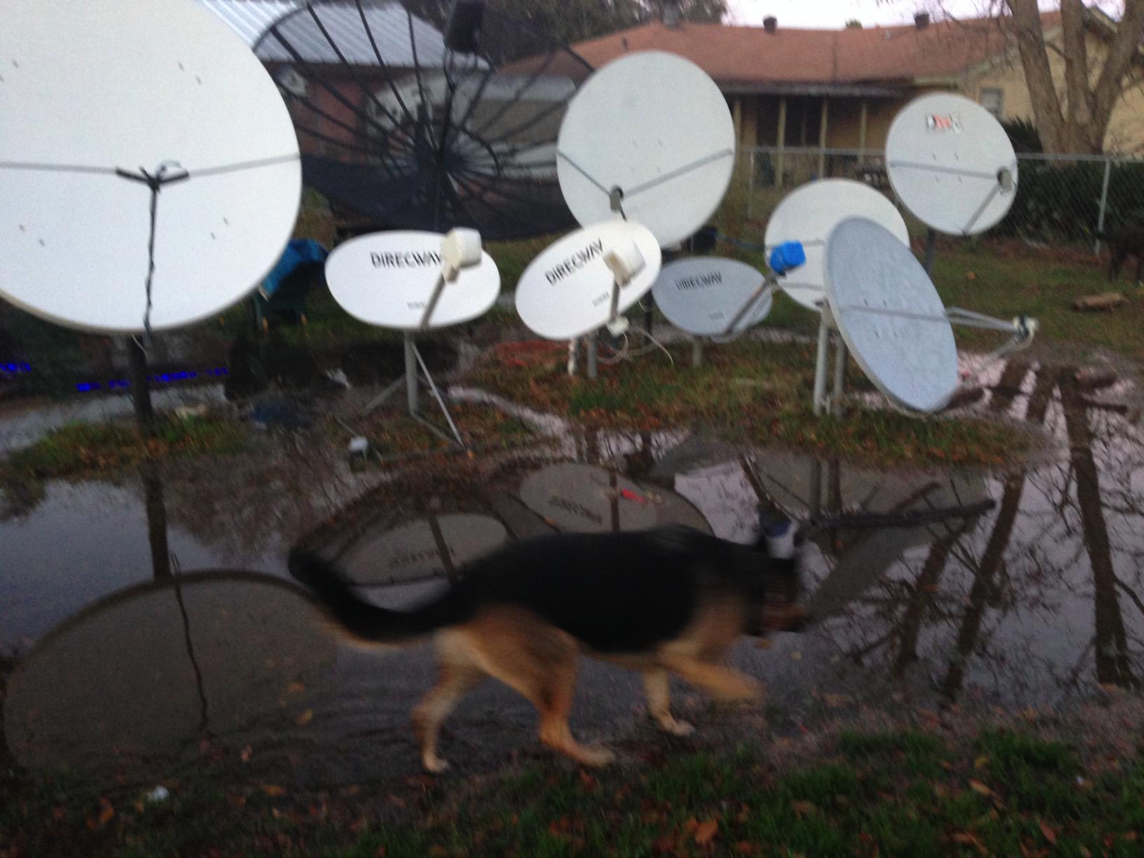

There's nothing I can do about it for a few days, we've had two days of cold, heavy rains and it will take a good while for my yard to dry up where I can go mess with anything out there. :(

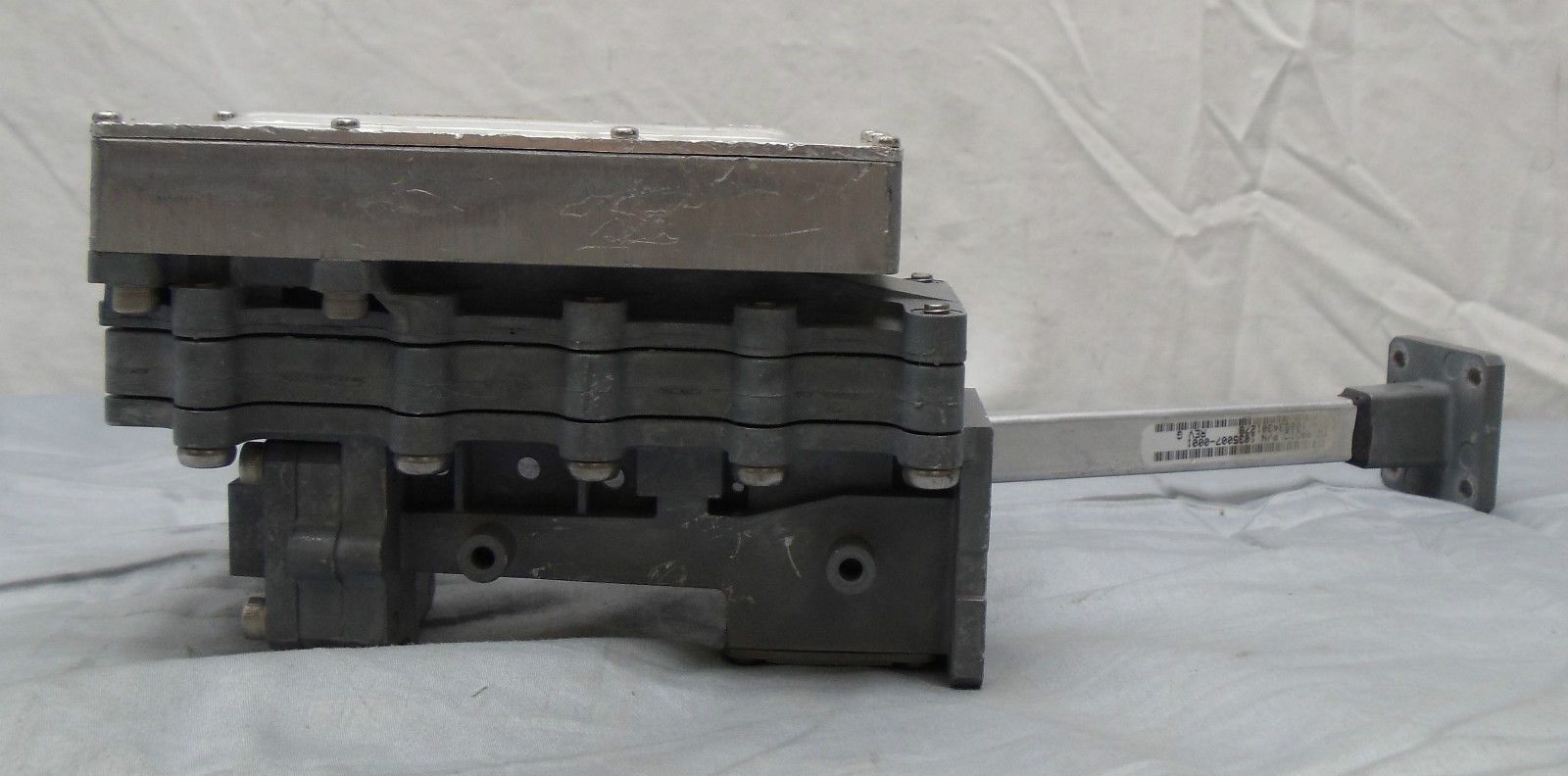

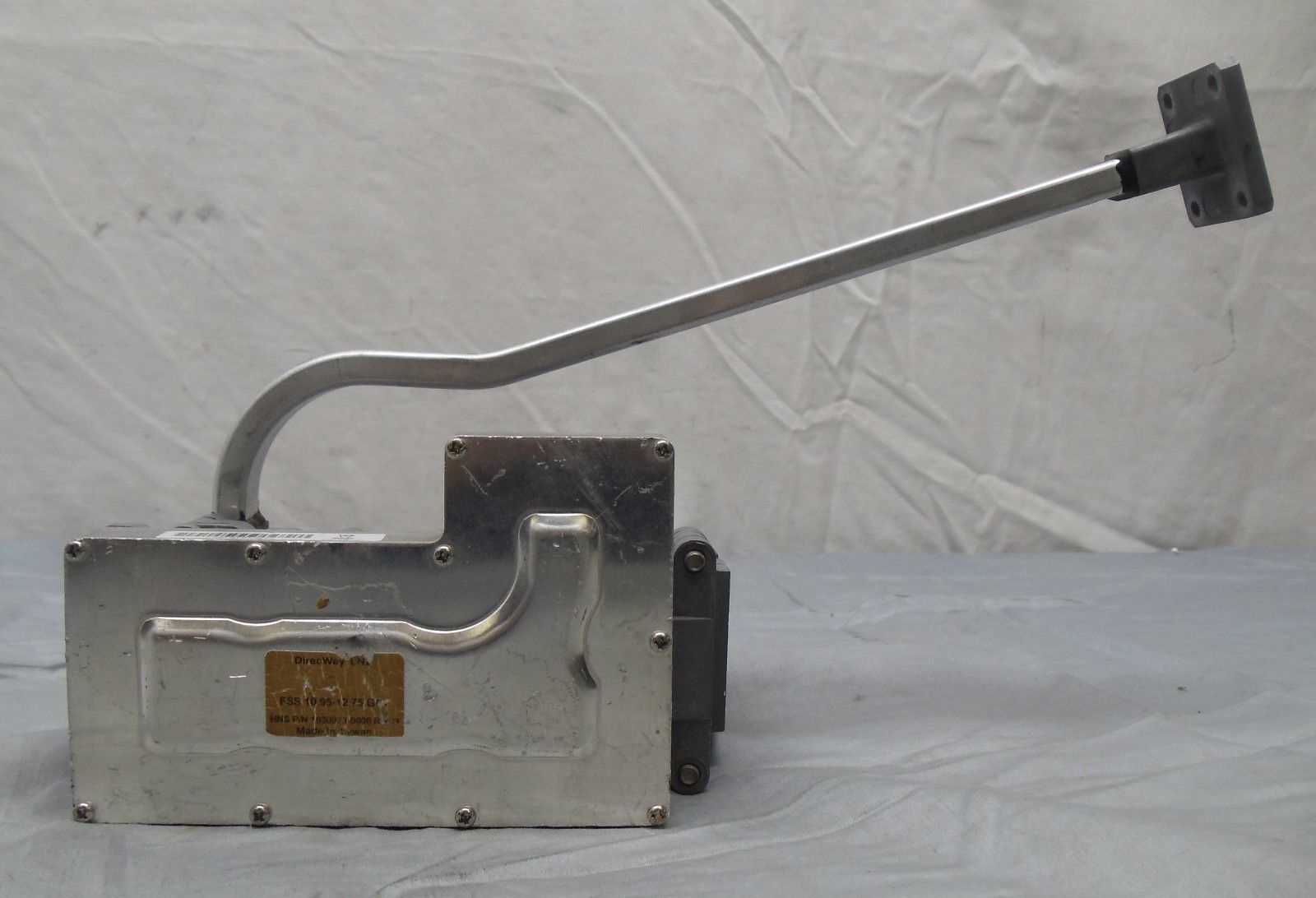

I think what I'll do is take the arm/LNBF off another Direcway that I'm not using at the moment. I think the dishes and arms are nearly the same though I know they made at least three, maybe four variations on their LNBF and transmitters.
I have four of the dishes and three of them have three different LNB's. I'm hoping it's ok to change the entire arm since you can't change just the LNBF except with an identical type. VERY ANNOYING design!

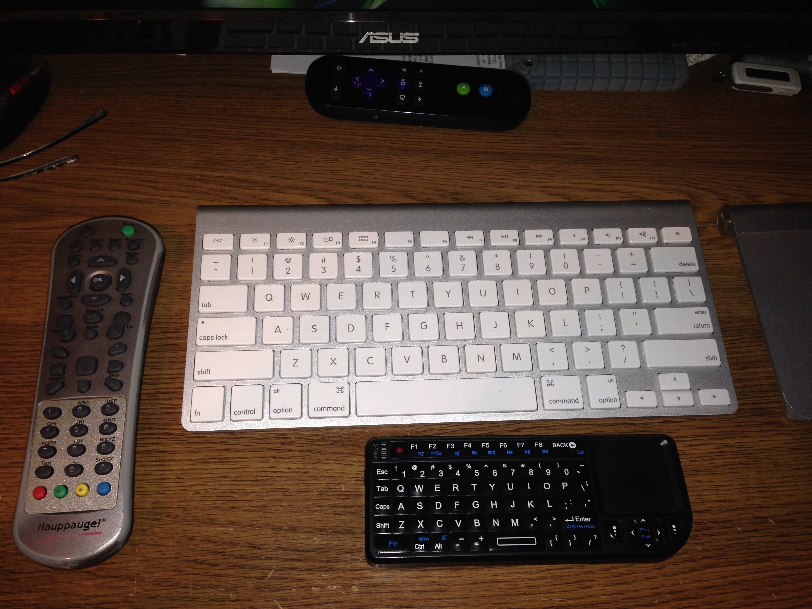

One thing that has been extremely annoying to me with the Hauppauge cards is that their remote controls use a strange "code" sequence in the IR signals. Universal remotes are unable to replicate it accurately, even the learning type don't like the weird code that Hauppauge uses. The Hauppauge remote is very weak and wimpy, you have to get pretty close to the eye for it to work.
When I was trying to use it to provide whole house video I was using those stupid remote cone pyramid repeaters to operate the thing from other rooms. Well, the cones were picking up something from somewhere, I could never figure out what but it was receiving some radio signal which caused it to transmit a continuous nonsense IR signal that severely interfered with it's proper operation. I could see this because they have visible red LED's to show you what they are doing. I could move them around and it would help a little but it never would stop completely. Aiming the remote at a cone had to be done in under 8 feet. Any further and it just didn't respond, I guess because the remote isn't bright enough. Other remotes I have are so powerful that I can operate them from under my blanket! The IR is so bright it goes right through the blanket and works the TV from 10 feet away. That's how they all should work.
When I became a Dish subscriber I found that they don't offer a radio remote for my tuner so I bought a little UFO looking thing http://www.amazon.com/gp/product/B000C1Z0HA
and it's been excellent for use with my Dish system. But it absolutely will not work with the Hauppauge remotes. What a massive disappointment. :mad: I've come to the conclusion that Hauppauge is it's own weird BS that doesn't like to play well with anything else, period.
If for no other reason than my dislike of their remote control issues, I would happily replace the thing. Actually I should just go ahead and do it, especially after reading what you've had to say on the TeVii and the 3/5 problem.
I would love to have a card that uses a remote that isn't hostile to being cloned so I can use a bigger, nicer, higher power, illuminated remote that won't mind having a Next Gen transmitter added into it. And to be able to get Movies! and whatever else is out there with weird FECs..

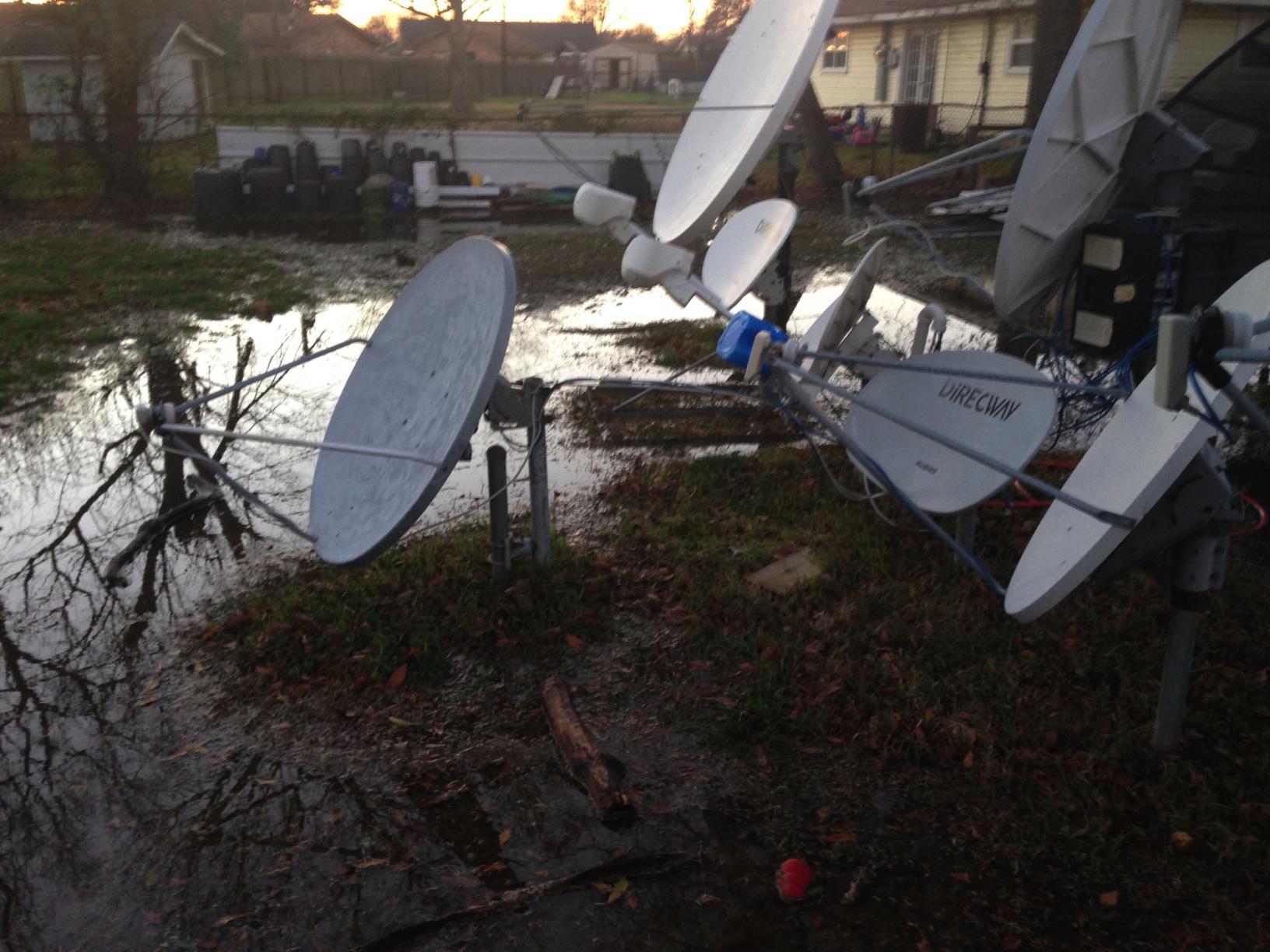

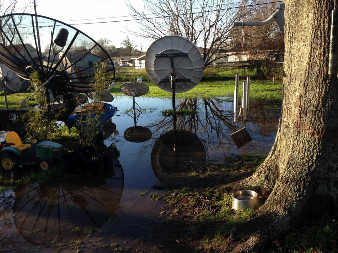

So everything is still at a full on dead stop. My yard is flooded with freezing water that won't likely drain off for days. We've had THE MOST MISERABLE winter in years and years now and there's no real end in sight. We are supposed to warm up a little this weekend but the weatherman warned not to get used to it because our roller coaster yoyo ride is not even close to being over yet. :mad:
I really never thought I would see the day but I'm here to say that I'm really, really tired of this weather and I'm ready for spring already ! Not summer though! Just spring.. :)
I don't know when I'll ever be able to get back outside and get things done. I have soooooo much to do out there but not in this weather !!

I'm definitely very dependent upon the remote control. The keyboard & touchpad for the PC is like itty-bitty. I bought a FAVI ultra tiny little thing, it works really well but it's not exactly very practical.
My problem has always been operating the thing from other rooms. Arrrrrgh !!

As to the remote, I've always been very unhappy with their oddball remote that doesn't play well with others. I would love to get away from their idiotic remote. I would love to have one of those fancy remotes that has a touch screen, I forget the brand but they are a little pricey but very cool. Harmony, I think? If I could have an RF remote, that would be the ultimate! I despise IR remote controls with all my heart and every fiber of my being! Dinosaur technology from a bygone millennium. And all the methods for converting IR to RF are lackluster at best. I've had pretty good luck with the little UFO thingie I mentioned a few pages back, I forget the brand but it won't work in remotes that only use two batteries. You have to have four batteries for it to work right, or at least that's been my experience.

Well the winter blockade continues, still too nasty to work outside, my yard is a swamp and a mushy mud stye.
I can't do ANYTHING outside.. :cry:

If the weather will ever break and let my swamp dry out I need to get out there and do some major overhauls on my stuff. I bought a bunch of 3" PVC pipes so I can dig up the old 1.5" pipes and run more cables through them.
I'm having all the trees cut down and I have to take all my dishes down which is going to be a huge pain in the butt. Well, everything is going to get a big overhaul.
I have new LNBFs to install and test and report on as I promised the wonderful folks at Satellite AV.. :D Thanks guys! Y'all rock !
It's been so frustrating this winter, being unable to do anything outside. I have sooooo much to do!
Well I think I might have just saved myself $100...
I have installed the dual output SL2PLL on my "lawn chair dish" which is the HH dish on my MicroHD. As expected, it works flawlessly.
And here's where the dual output came to my rescue. I have been having trouble with my PC, Galaxy 19 going in and out on the vertical. Hrrrrm.... :mad:
So I ran a wire from the second output over to a spare input on the switch for the PC and fooled the PC into thinking this was a different satellite (so I wouldn't have to delete my existing G19 setup)
I scanned this alternate G19 setup and BAM! Everything works fine.
So now I have two Galaxy 19 configs in my PC and I can pop back and forth between them.
The original, not working right.
The new one, working like a champ.
So I am convinced that the LNBF is gone kaput. Time to change it out. I just hate that Direcway dishes use proprietary parts. That's gonna be tough to find replacements.
But it's a low priority and until then I can piggyback off the other dish with the SL2PLL...
