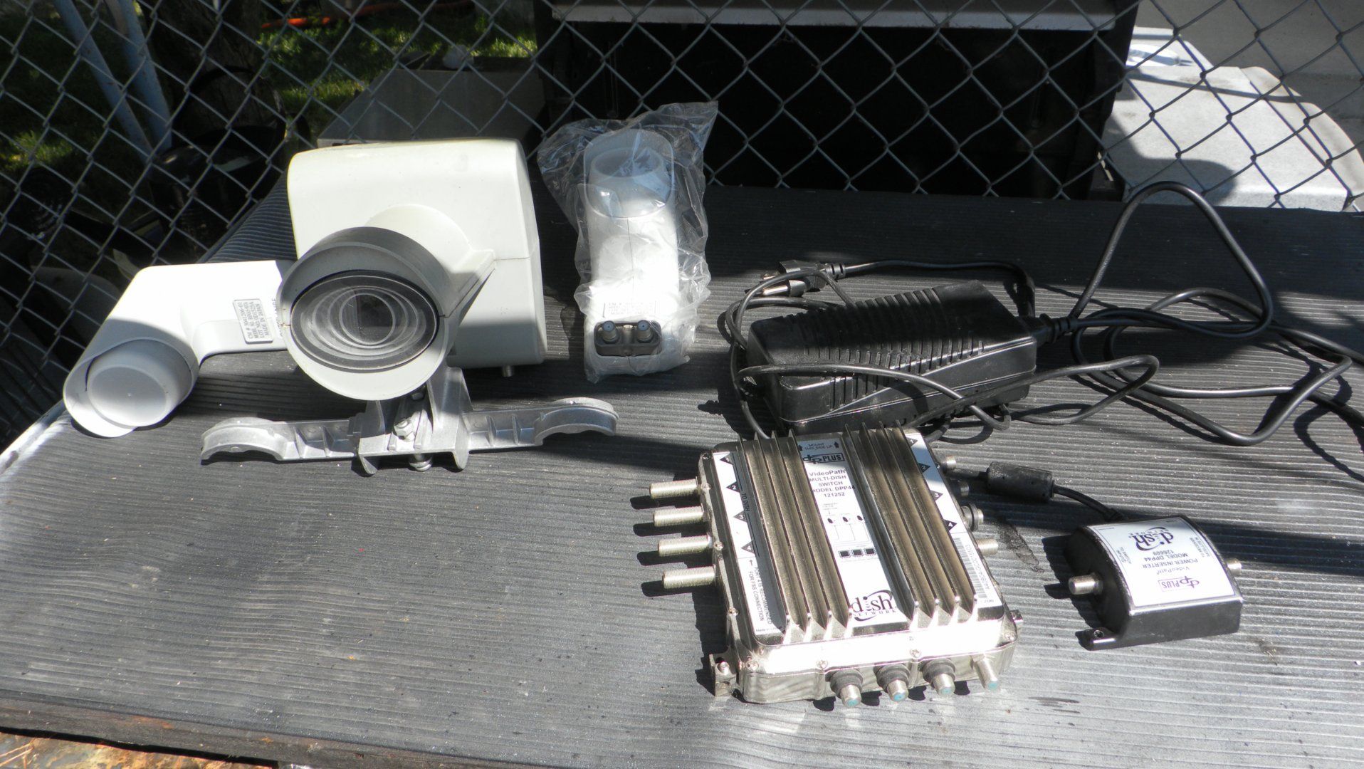

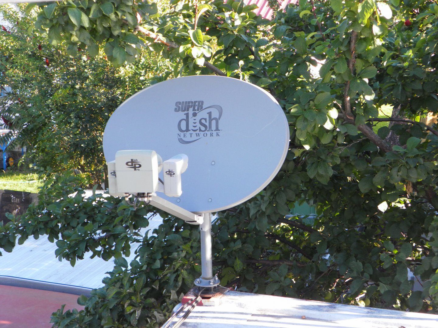

The 118LNBF with a couple side car LNBFs. You also need the DPP SW44 with power inserter. Out west we had another option, the old 121 Superdish with a 118 repoint kit. (they have different brackets)I have one of those up wired FTA style without the DPP SW44.

If you have a Hopper 3 you will need a DPH42 switch with the 1000+ dish.

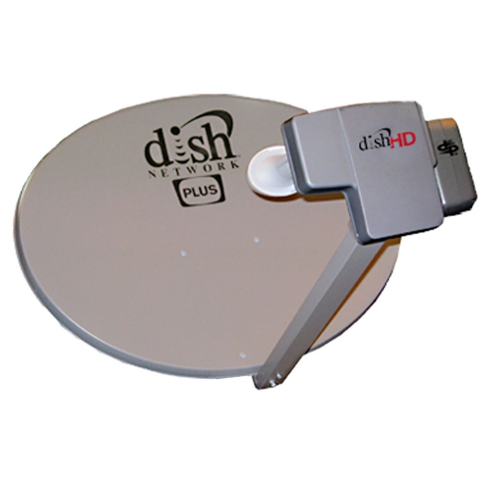

That's the old version. The newer one looks like this

Yes. The main difference between the old and new versions is that the new doesn't need a 44 switch. You can still attach the new(they've been available for a few years now) dpp lnb to the old gray reflectors though.
