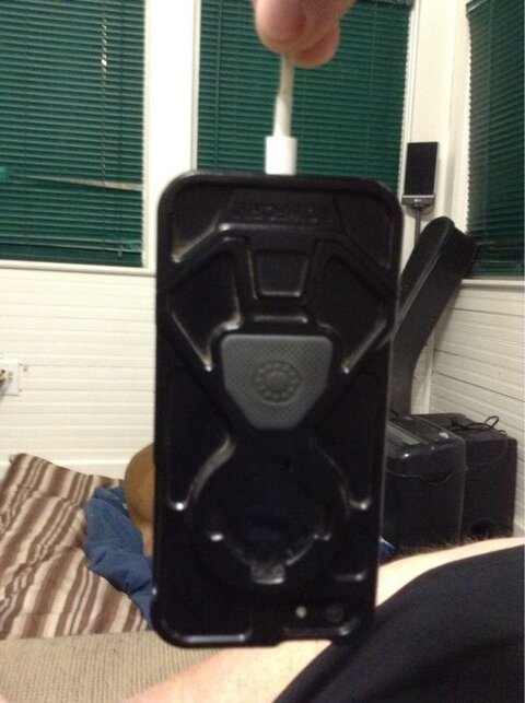

You're connector port must be or something. Mine stays in tight, it's hanging in the pic there. Do you have a case that is not large enough for the lightning cable end to fully insert itself in the phone? The three cables I have all fit snug.
