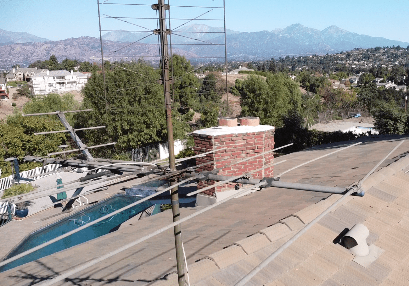

I'm in Covina, CA about 16 miles away with a clear view of Los Angeles' Mt. Wilson with all the transmitters on it. I have an OLD rooftop unit going into my HDhomeRun Extend tuners. I've been getting terrible reception of KCBS 2.1(31). The tuners report signal strength of stations with RF numbers >13 at about 60% and those <=13 at 95%. I took a pic with my drone and it looks like there's some sort of uhf antenna on the mast not even connected to the main antenna. Can I just connect these somehow to improve my reception, or should I just fork over a few bucks and get something from this century? (recommendations appreciated!)

I could not see the picture until rabbit73's posting. The old lower antenna certainly is the correct type for the LA area. It of course includes lower VHF which is used for some lesser known channels as well as VHF high and UHF. It does look a bit corroded but some sandpaper could correct that. I would also find tune the direction as the wind may have moved it over the years.
The upper UHF antenna is indeed not connected. I see no benefit of trying to add it into the mix and it would in fact likely cause problems. It appears to be pointed in a slightly different direction, possibly towards the old analog channel 24 in San Bernardino.
Ypsiguy beat me to the punch as I typed. While his recommendations certainly are valid, I feel that would be massive overkill for 16 miles from Mt. Wilson with clear line of sight. While I would put some work into the existing lower antenna, if I were to simply replace it a medium sized VHF-high/UHF would likely be the option unless some of those channels that broadcast on 2-6 were of any interest or I wanted to future proof any further channel repacking.
16 miles from the towers with a line of sight should be pretty easy. That old antenna looks pretty oxidized, I'd recommend replacing with something like the Winegard HD7694P. It looks like someone used white coax, that's really meant for indoor use - the insulation will get brittle due to UV exposure so I'd replace it as well.
First thing I'd do is replace the coax with new RG6 and a new balun.Then make sure any other connections (splitters,ground blocks,etc) are clean and tight.Then do some peaking and tweaking and see where you stand.The antenna looks to be in decent shape but if that coax is 50 years old too it's time to go.If it is that old there's a good chance it's RG 59 and that isn't doing you any favors for UHF.If there's any RG59 in the house that needs to go too.

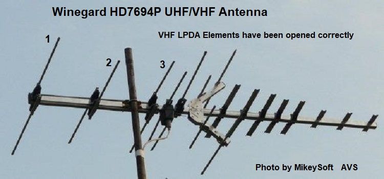

Winegard has revised the instructions for the 7694, but they are still confusing. The VHF-High elements are an LPDA (Log periodic antenna) and must be unfolded correctly. The elements must alternate for max gain.

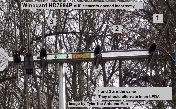

even Tyler the Antenna Man got it wrong:
