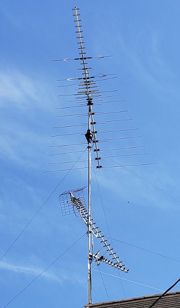

Here's a picture showing my antennas where you can easily see the size difference. The top antenna, the Winegard 8200, covers low VHF very nicely, as well as high VHF and UHF, where the XG-91, below it, designed for UHF only., does not receive low VHF at all. It does work for a high VHF station that's 5 miles away, but the signal is low. You really need that big antenna to watch low VHF channels.
Thanks for the size comparison. I'm not going to invest in another antenna just to get one channel. If I did, I'd buy one of the longest ones for the most UHF coverage, which would run over $100. My 4228 is fine for me. Everything else from Huntsville and Nashville that I need to pick up is UHF only. An antenna that big is too much weight for the setup that I've got.
