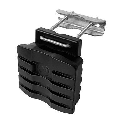

That's a dual preamp, NOT a simple UVSJ combiner.
dfecarter I just put the Clipsal UVSJ in my setup the other day, it's not hurting the signal at all. It's POWER PASSING on BOTH Uhf and VHF. IF the Televes is the Dat Boss LR antenna with a built-in preamp, it'll pass power to it. I use one myself.
IF the Newark VHF antenna is passive (NO preamp), it'll short out because it'll also pass the power from the Televes power inserter up to that side. Look at the instructions that came with the Clipsal. There's a coil inside that you can clip the end on the VHF side, and it will stop passing power up to it. That should solve your problem.
OR, you can put a Dc block (looks like an attenuator) on the VHF side, if you have one handy.

The Televes product page is VERY misleading then because they absolutely do say you can combine ANY two antennas using it. :rolleyes
You can, however as I said, it's a dual preamp. A UVSJ (Uhf VHF splitter-joiner) is a passive device that has nearly no loss. The OP does NOT need a preamp combiner, he needs a UVSJ.
I get what you mean. Just saying IMHO Televes should me a little more informative about actual usage and requirements if they are expecting upwards of $100 out of you. :rolleyes
