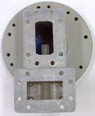

Check to make sure both feedhorn throats have the plastic intact, they may not move but not knowing how old your feedhorn is one of them may have deteriorated with heat and age. Should look like this picture.
I have that exact same Chaparral feedhorn, on both my 6 and 8 foot dishes. They perform rock solid with Norsat LNBs.
