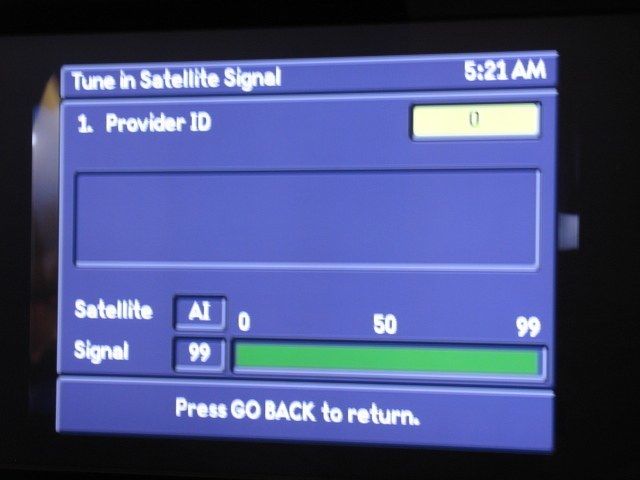

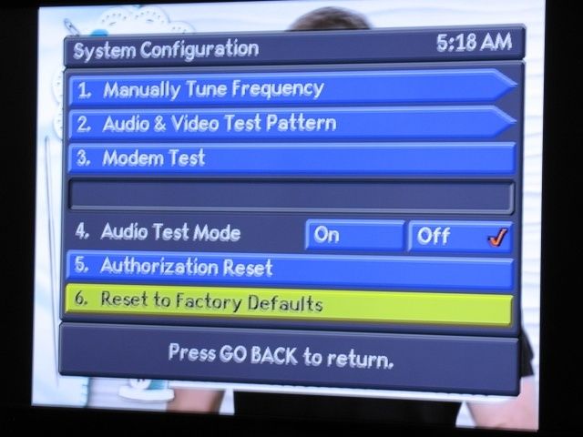

I setup my fleabay bought DSR410 on Friday. Just to be certain I opened up the unit & replaced the coin cell with a AA size 3.6 volt & holder(Rat Shack). I used a Dremel tool with a thin cutoff wheel to cut slots in the tamper-proof screws, then replaced them with metric Philips heads(Ace Hardware). I know that some here don't approve of a battery without permanently attached leads, but this will get me by until I can get some for this & my other 4DTV units.
Tech support at Skyvision suggested that I might have to do a Master Reset(options 6,7,7,8 then 6). It kept losing authorization & reverting back to cable box settings when unplugged. The 'satellite tune in signal' (options 6, 3, 1) strength bar kept failing. even with a 10 ft dish!
After replacing the battery & doing an MR it accepted the hits OK. Note that the sat ID is AI.
I was informed today that it isn't important which designation is there, X4 or AI, as long as the strength bar reads around 50 to 75 & you're getting your channels. Thee 99 reading is with an ASC241 LNBF on the 10 ft dish.
A Geosat Pro C2 dual output LNBF with the zero at the 9 o'clock position & an Eagle Aspen powered 4x8 multiswitch works well with the DSR410s on a 7.5 ft motorized dish. Signal reading of 99 again.
