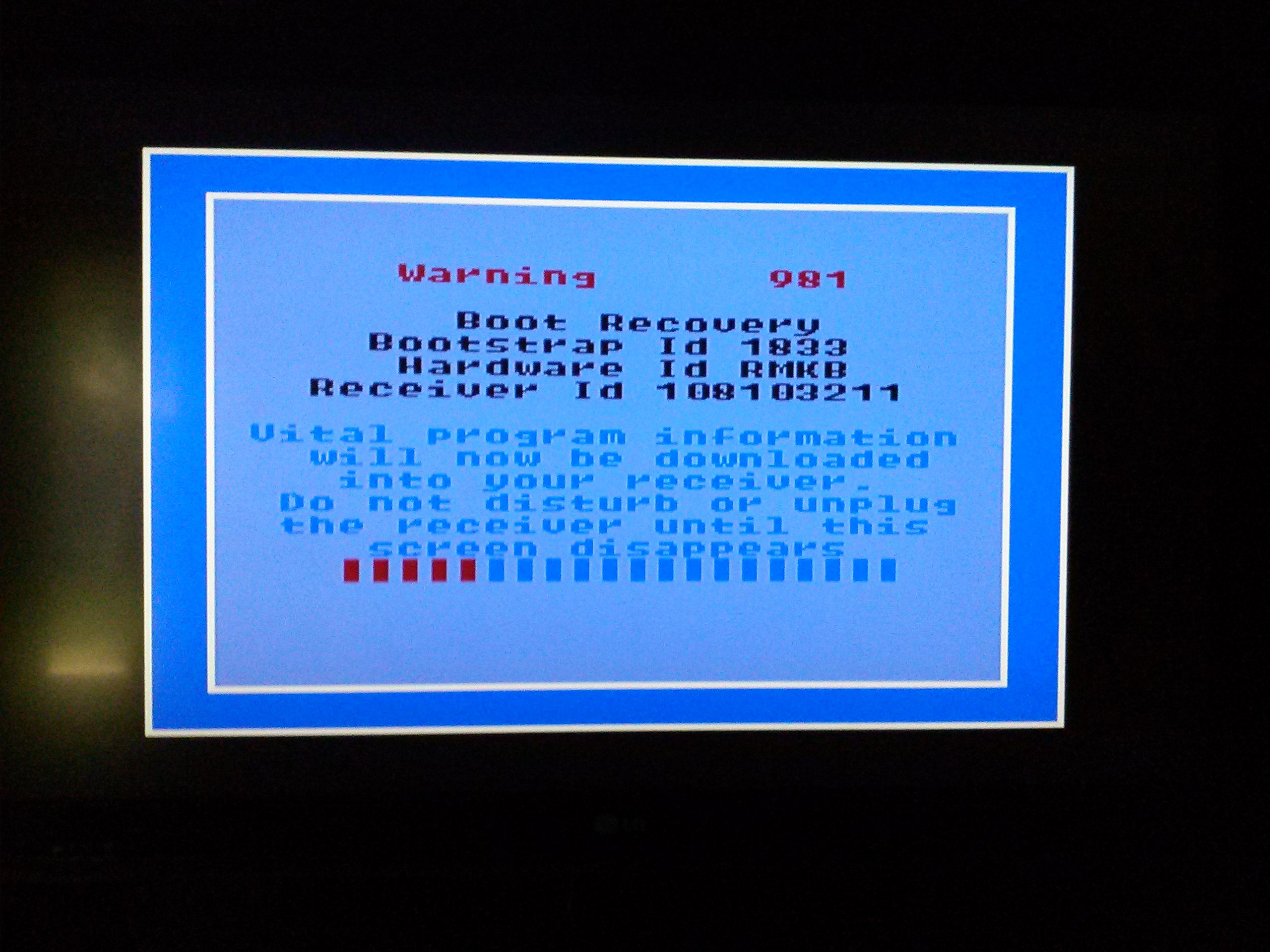

After turning on the tv for the past 3 mornings I noticed that I wasn't getting a signal from the 722k. Just a blank screen. So, I opened the front panel(each time) and pressed the power button to reboot.
Upon rebooting, I see this message on the screen: https://lh4.googleusercontent.com/-...AAAABNs/RH-fdWhgums/w667-h500-no/CAM00040.jpg
This morning, after seeing that message and rebooting the device, I now see this message: https://lh5.googleusercontent.com/9d6IJCxVD49ADQsO4UHXL4dBf6eZXP-VTU3iC0I-ZKA=w667-h500-no
What do I need to do to solve this? Help!!! :)

A quick note about the AVR. It is not in the same compartment as the 722k. The entertainment center has two glass doors with a solid piece of wood in between. As far as I can tell, there isn't any heat escaping from the AVR to the 722k's compartment. See attached photo.
Also, 7 hours have gone by and still no change. The red status bars are still at 5.
I predict it will stay there forever, and keep doing that every time you try the power cord reset. Try flipping the separator cables going to TV1 and 2 inputs, and see if it completes in a reasonable 15-20 minutes.
