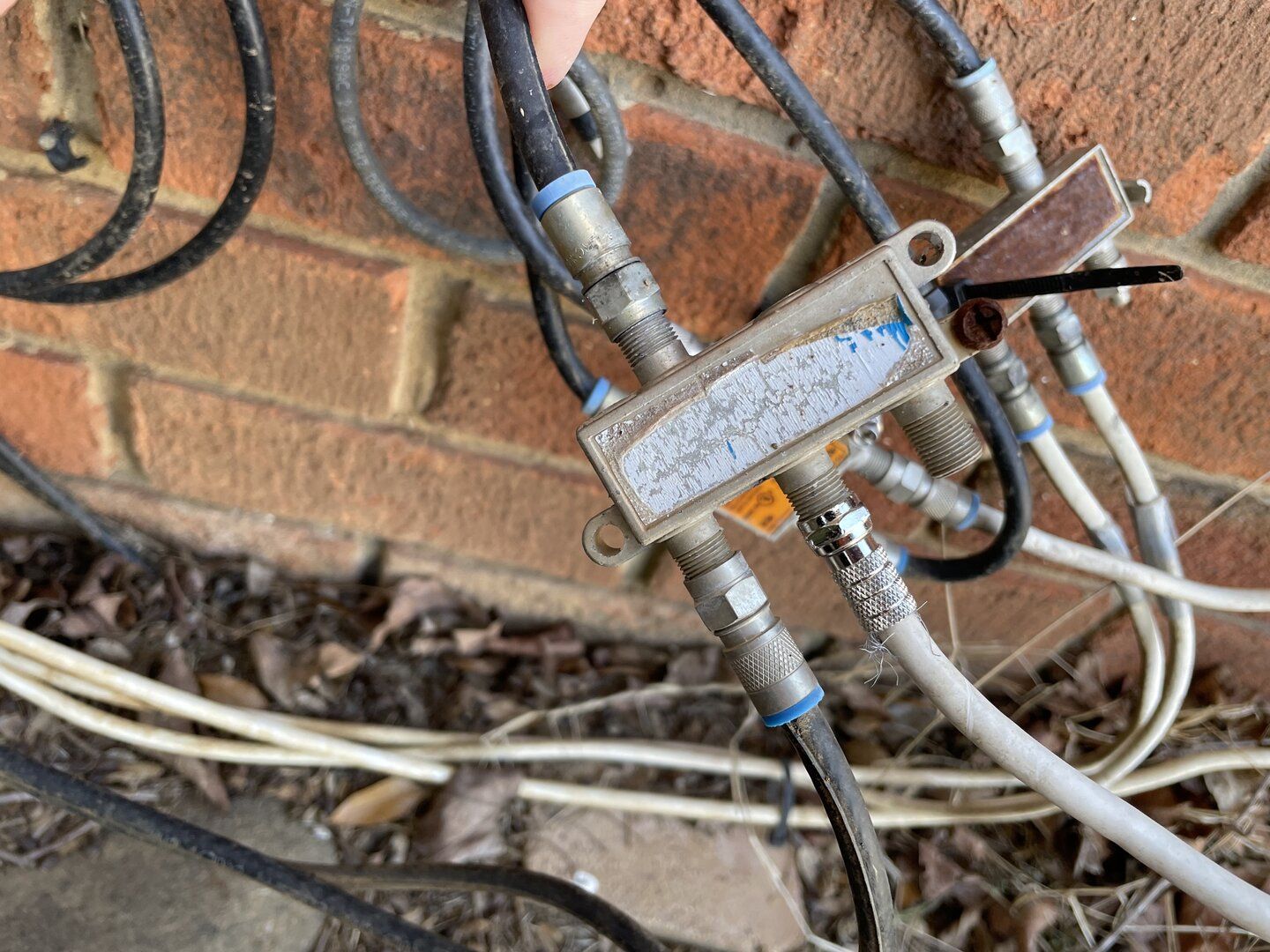

I only have 1 coax going to the porch. Here’s a pic of the mess I have. The cable coming from the dish runs into this thing with the orange label and then goes into the splitter. View attachment 156232

Then the cable comes from the orange labeled device into a splitter. I basically just unscrewed the cable going to the bedroom and screwed in the cable going to the porch (white cable).
So from dish to the orange thing (hub?) and from there to the Hopper, and presumably you didn't disconnect that. Then from the other side of the orange thing you go to a splitter with 3 outputs?
I would plug the porch cable directly into the orange thing and see if that fixes it. This will obviously unhook any other Joey's you might have around the house.

Then the cable comes from the orange labeled device into a splitter. I basically just unscrewed the cable going to the bedroom and screwed in the cable going to the porch (white cable). View attachment 156233
Hey Hipcat is that one of your installs? LMAO and JK of course..
Sad part is I see that crap all time..
Can't stand people who don't take pride in their work.
Even people who don't know sh*t can spot a good install from bad if everything is neat, straight and uniform.
HipKat
HipKat
Aug 25, 2017
14,171
24,651
Pekin, IL
Yeah, I'm very anal about how things look. Probably comes from when I was a contractor doing remodels and things like that where I just got used to everything being nice and straight and neat
