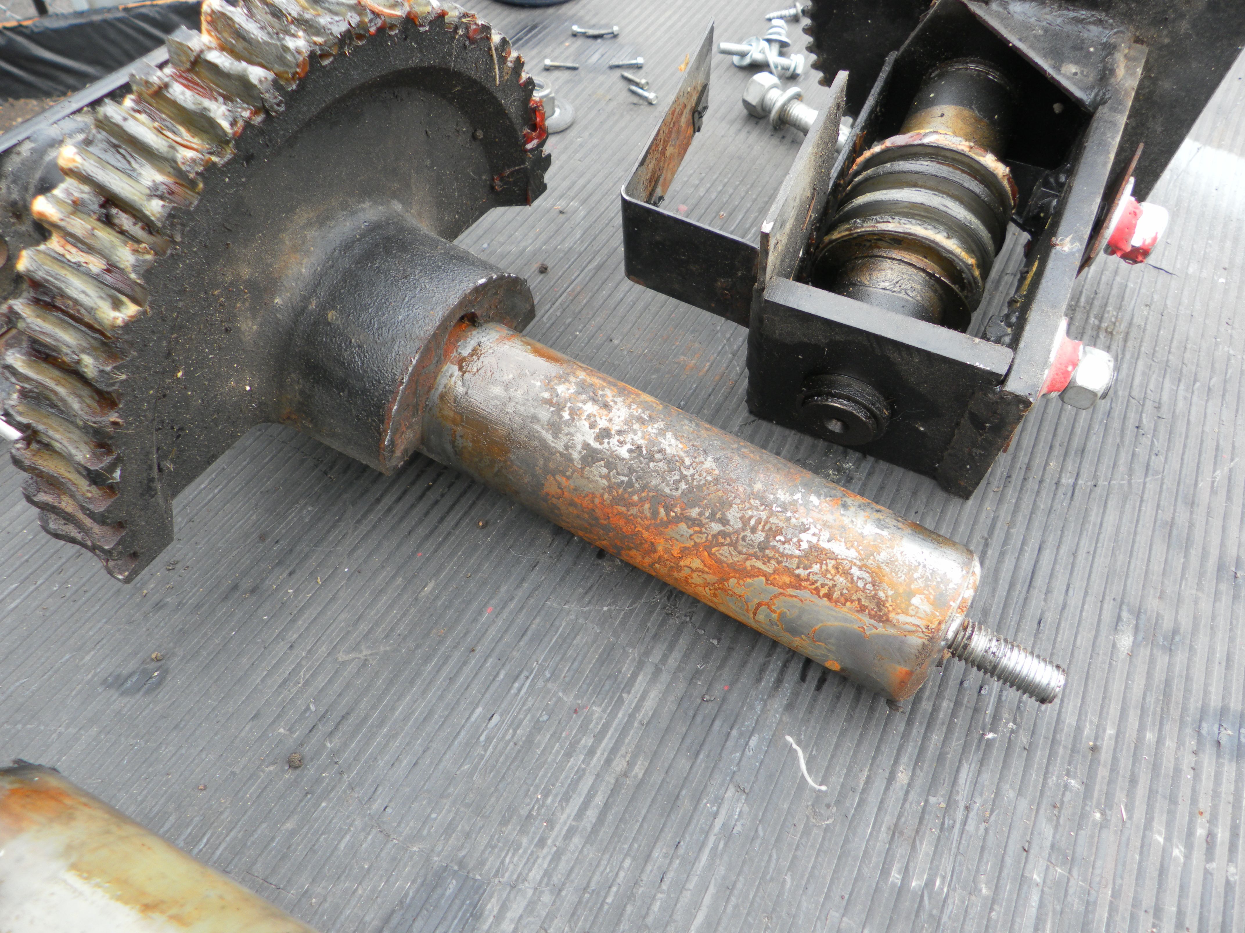

I know you can't do a rebuild on the AJAK mount, but the main shaft is probably your biggest lubrication concern. My 2nd AJAK was a lot better looking than yours is an I found the main shaft seized in it. So if you could find some spray penetrating oil and try and get some into the main shaft area right where the big gear contacts the mount.
I'll bet mine looks at least that bad. I shot it full of penetrating lube and let it sit overnight to see what happens. Thanks for the tip.
