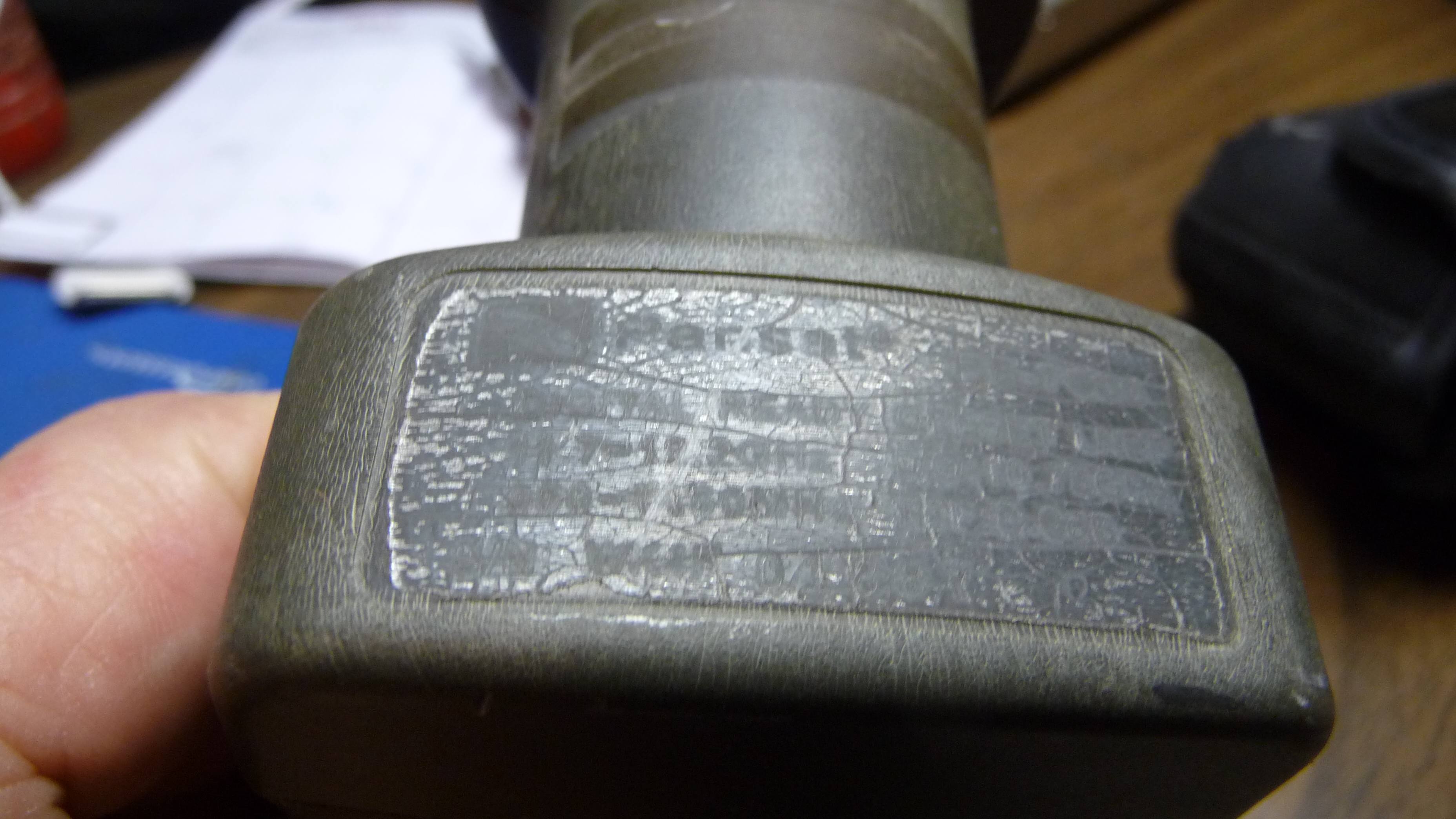

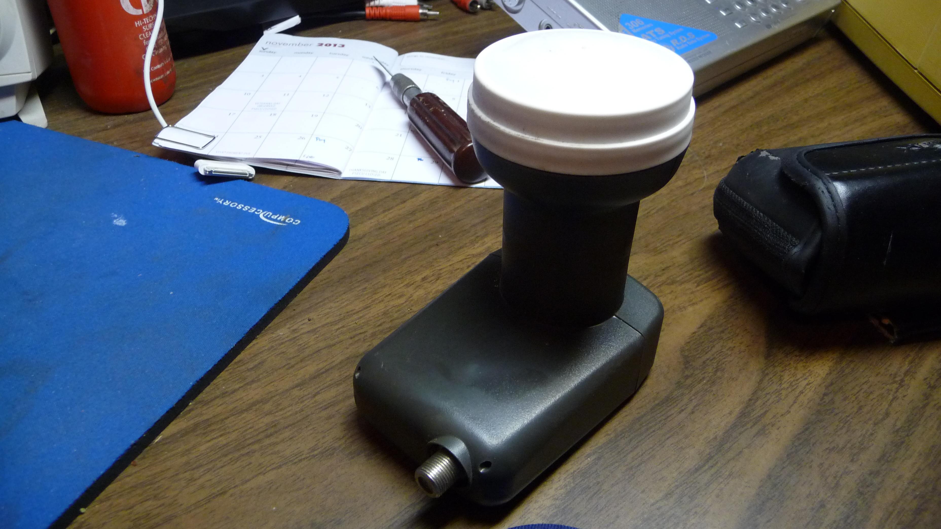

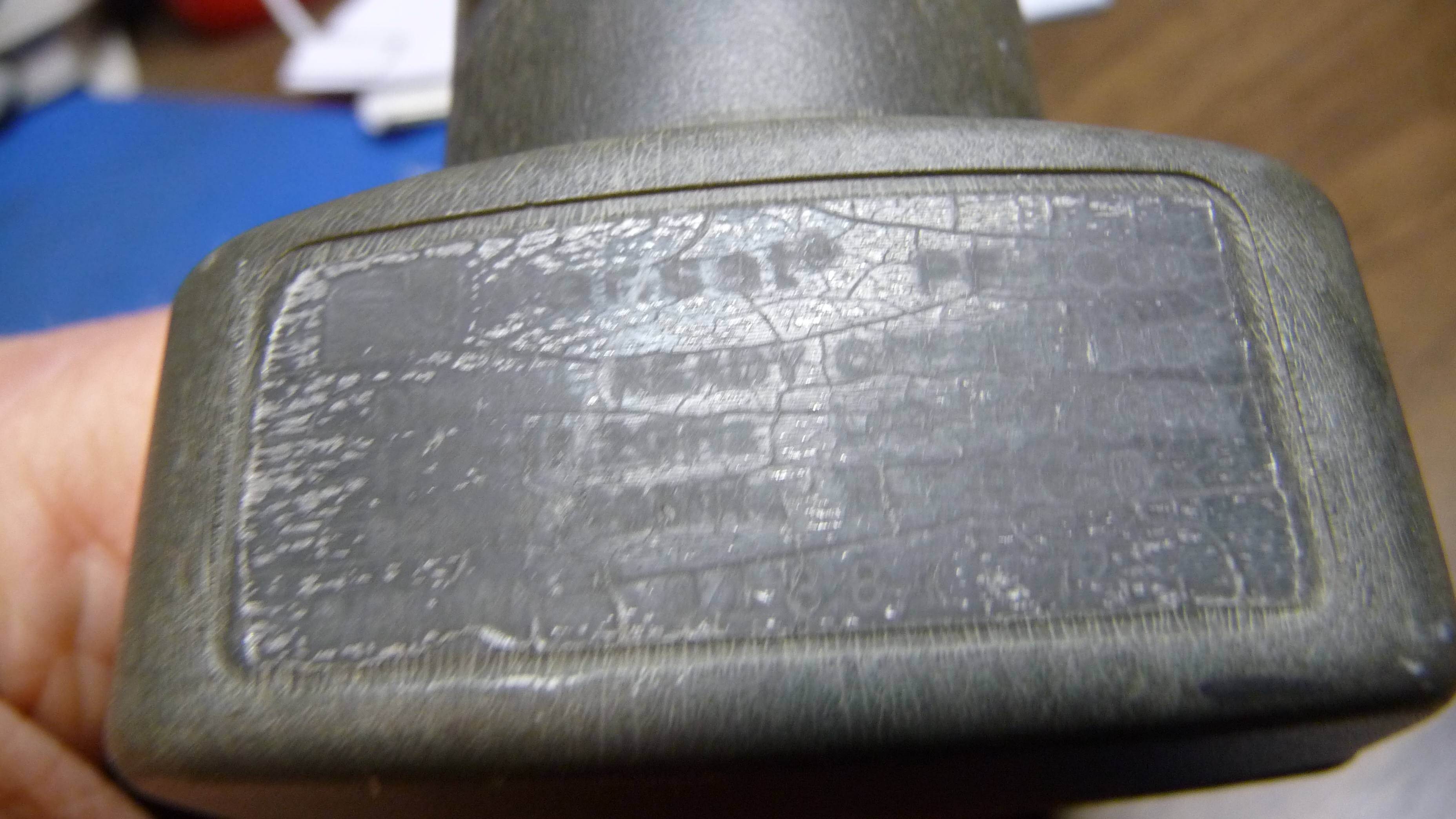

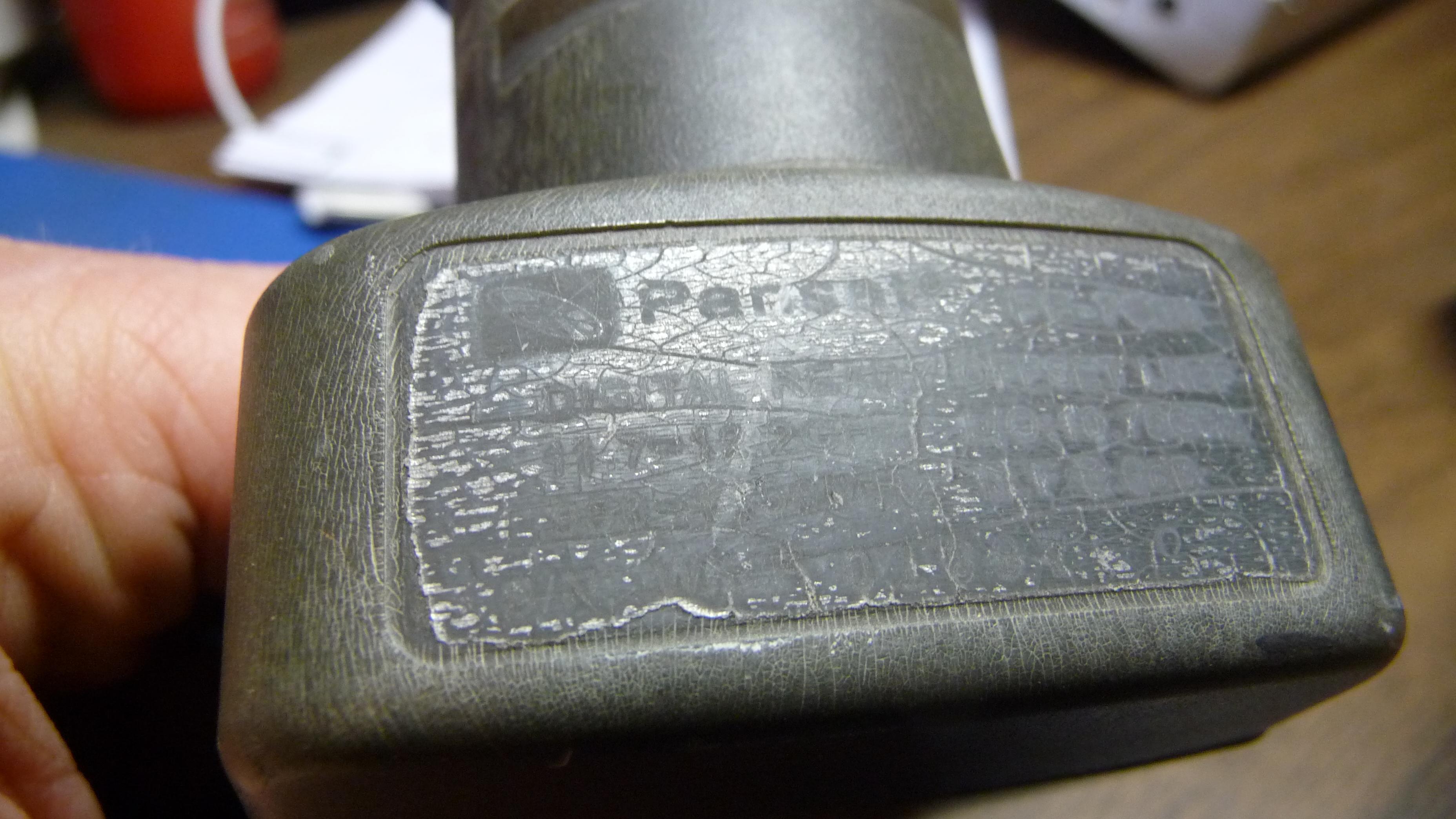

This LNB came with a dish I bought. The label is gone, but remnants of the wording from under the adhesive are still there. I've taken my best guess and best pictures. Can someone here confirm or tell me what I have? I think this is a linear LNB, but I'd like to know for sure before I try to use it.
Pansat PF-7600
Digital Ready Offset LNB
11.7-12.2GHz L/O 10.7??

Probably "Noise Figure 0.6" and "S/N xxxxxx" serial number
The important part is "L/O 10.750" - that's what you enter into receiver in the LNB setup menu - "10.750"
Great. Thanks.
