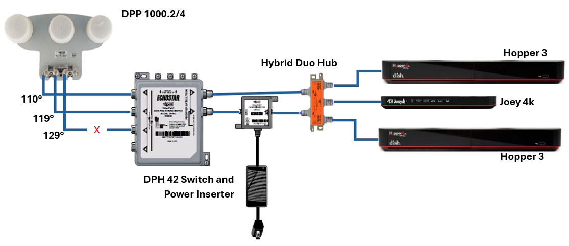

If connected straight from the LNB to a Hopper 3 bypassing the DPH42 switch, where would the splitter be connected for a Joey?
We run setups like that on single Hopper installs all the time. The Solo hub is needed to protect the LNB form MOCA, but it's still one line to the Hopper
No, it will work without it but it could cause issues with the LNB
I remember now. This is the primary setup for the Hopper 3 and Joey setup. I held off getting H3 when they first came out because the DPH42 switch hadn't come out yet for two Hopper 3s. Had to wait about 18 months.
Here's a final update on my two H3 installation.
This is the installation, up and running with this configuration:

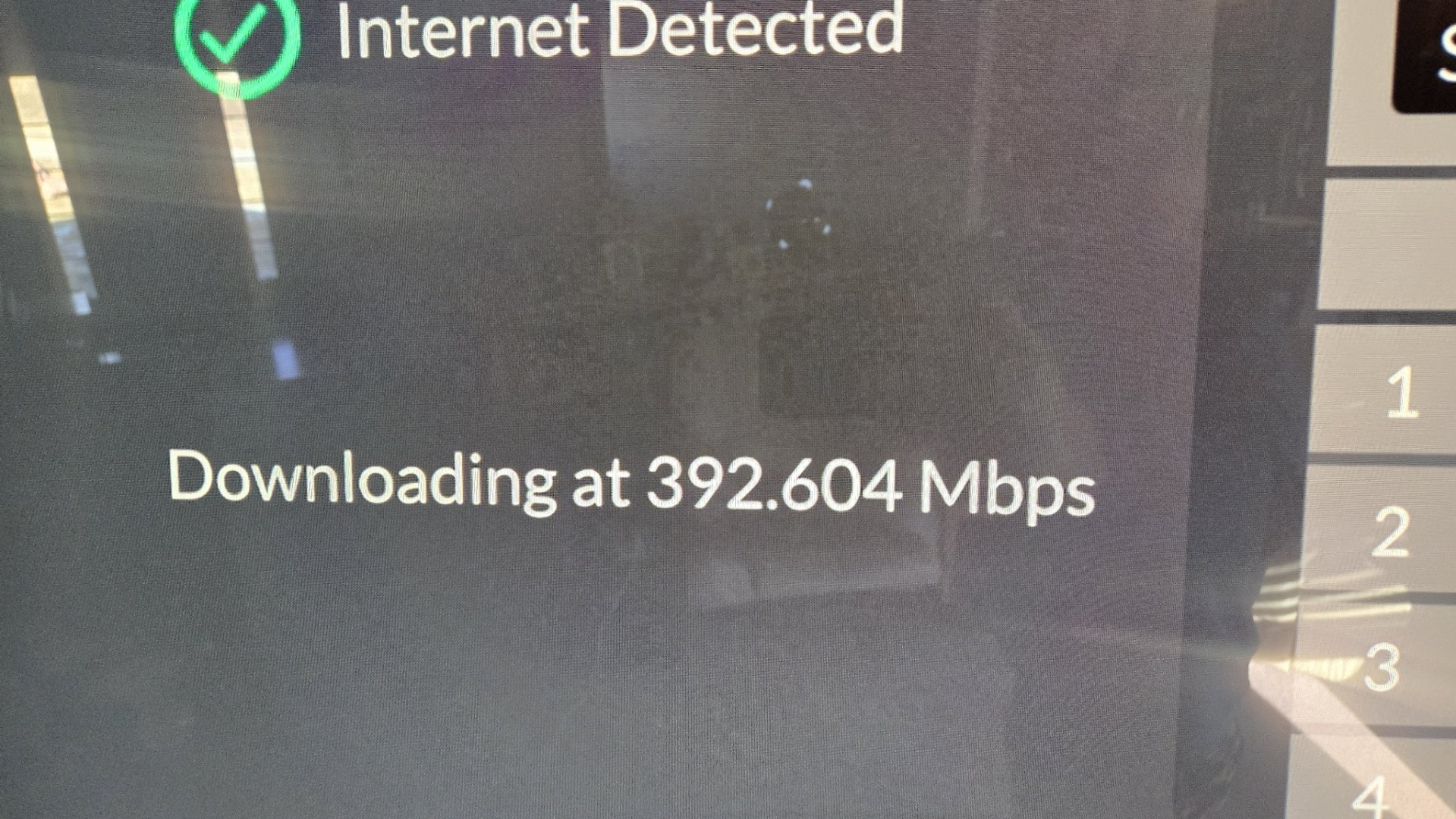

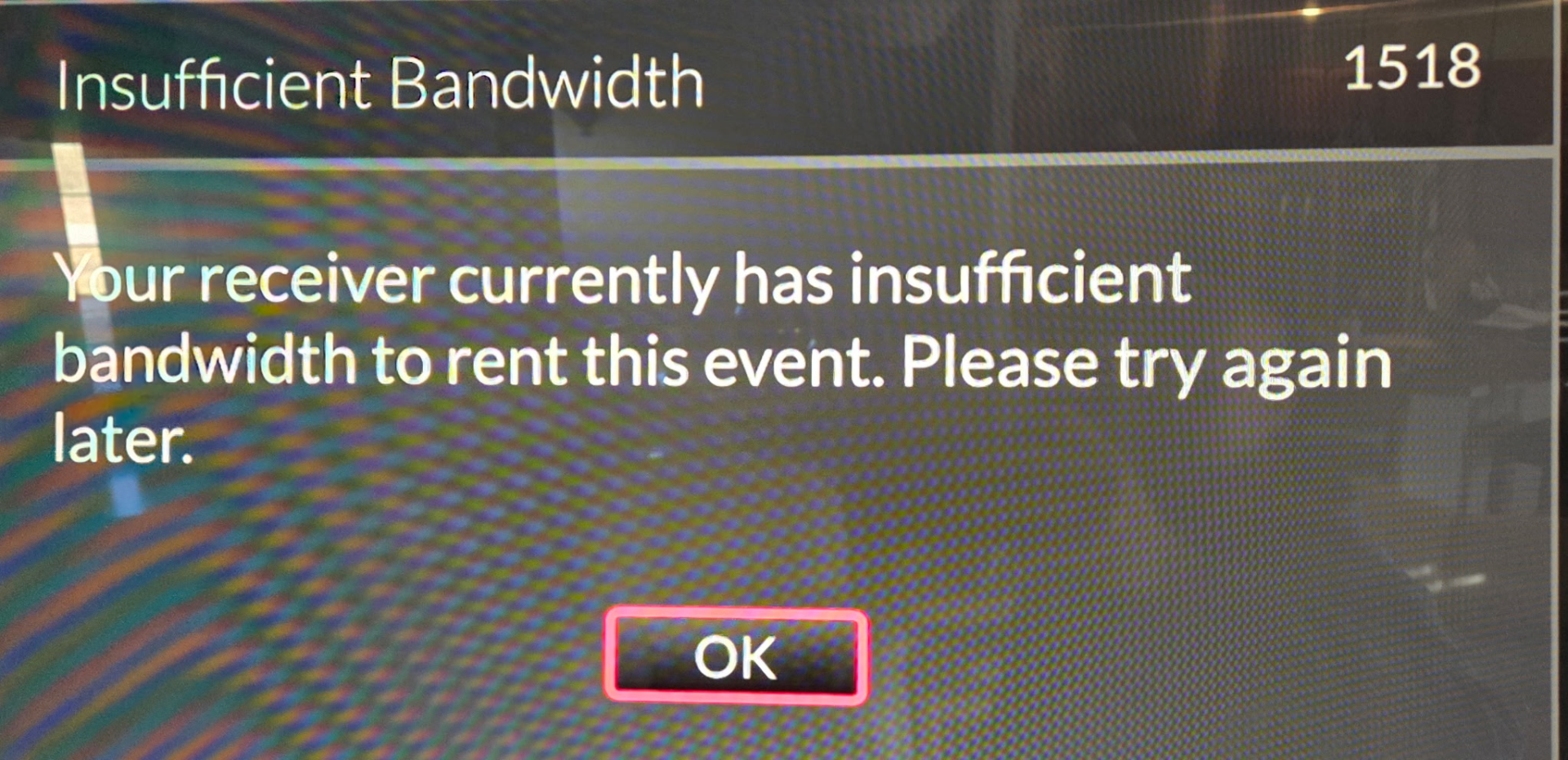

The only functional issue remaining, and it's not a showstopper, is that all the receivers will not download a 4k/UHD PPV or OnDemand show from DISH. It always throws up the 1518 window that says "Your receiver currently has insufficient bandwidth to rent this event. Try again later". I have 1Gb/s fiber to the house that tests at every location at ~900Mb/s. All my locations are hardwired. Both H3s report speeds of ~400Mb/s when transmitting/receiving from the mothership's tech portal.
Any ideas on why the system doesn't to want to download 4k programming? There are no issues when they d/l any other non-4k content.

Is this on all the receivers?

Um, I have a 1 gig plan and I still get that message from time to time. ;)
Well, this is first I've heard of someone else having the "insufficient bandwidth" message. Now I'm wondering how prevalent the issue is.

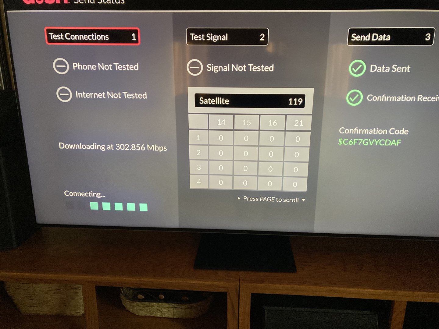

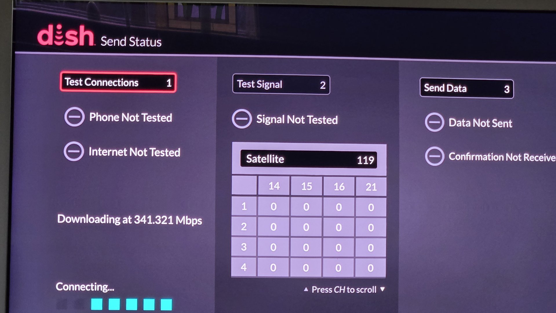

I'm curious what speed you get reported when testing Internet connection.
I have similar. I have my Hopper ethernet connected.
