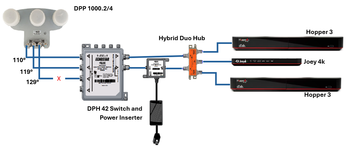

Getting two H3s on one Western Arc dish installed but came up short missing a DP or DPP LNB to feed a DPH 42 switch. I'm waiting a few days to get a DPP WA LNB to continue the installation. What got me here was having to abandon the EA dish for a WA and only having a DHP hybrid LNB for 110-119.
I only have two RG6 coax routed to the equipment room from the WA satellite. A 3rd line would involve drilling another hole through the exterior wall, which I'd rather not do.
My question is- what happens if a DPP LNB is connected to a DPH 42 switch with only the 110 and 119 feeds and then the check switch is ran from the receivers? Will the H3s error out and not complete the test and not tune the connected satellites? Or, would the H3s complete the switch test and just report bad connections for 129, then function OK. The current DHP hybrid LNB only gets 110 and 119 so there is no programming coming from 129.
If anyone is wondering, the setup is pretty much what has been discussed here multiple times with a Hybrid Duo Hub.
Dish says use two Solo Hubs instead of one Duo Hub but as charlesrshell says, it works this way just fine

Which WA LNB without 129 works with the two H3 setup?
I'm not sure a DPH LNB works wit ha 42 switch - it may - but since the Hopper 3's kill the 2nd output on the DPH LNBF normally, I don't know how it would work with the switch. FWIW, Hopper Duo's also kill that 2nd output on a DPH LNB, but that's not the case with a DPP LNB. Meaning a Hopper Duo will work off of the 2nd and 3rd outputs on the DPP LNBF.
So you're saying your LNB is the old DP or DPP? And, it has the 129 eye just along for the ride? Is the third coax connected to the 42 switch?
Third coax is not necessary any longer since the 129 doesn't show up in the check switch screen as you can see in Charles' pic
LNBs are hybrid. My old dish had the old DP LNBs. Yep, 129 is along for the ride sticking out there like a sore thumb, not connected to the switch or dish. I would do anything the get the new two LNB style Western Arc dish. Here is pic with just 110 and 119 connected to my DPH42 switch.

It would be interesting to connect the LNB to one Hopper 3, bypassing the DPH42 and the H3 isolated from the system, then run a check switch to see which LNB is reported detected.
