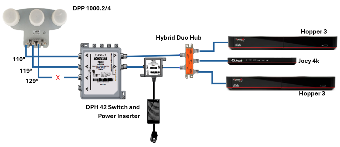

Getting two H3s on one Western Arc dish installed but came up short missing a DP or DPP LNB to feed a DPH 42 switch. I'm waiting a few days to get a DPP WA LNB to continue the installation. What got me here was having to abandon the EA dish for a WA and only having a DHP hybrid LNB for 110-119.
I only have two RG6 coax routed to the equipment room from the WA satellite. A 3rd line would involve drilling another hole through the exterior wall, which I'd rather not do.
My question is- what happens if a DPP LNB is connected to a DPH 42 switch with only the 110 and 119 feeds and then the check switch is ran from the receivers? Will the H3s error out and not complete the test and not tune the connected satellites? Or, would the H3s complete the switch test and just report bad connections for 129, then function OK. The current DHP hybrid LNB only gets 110 and 119 so there is no programming coming from 129.
If anyone is wondering, the setup is pretty much what has been discussed here multiple times with a Hybrid Duo Hub.

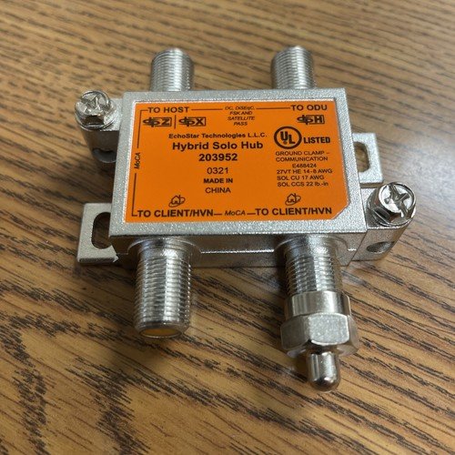

Setup in the pic is what I have. The DPH42 switch will work with the old type and hybrid LNBs

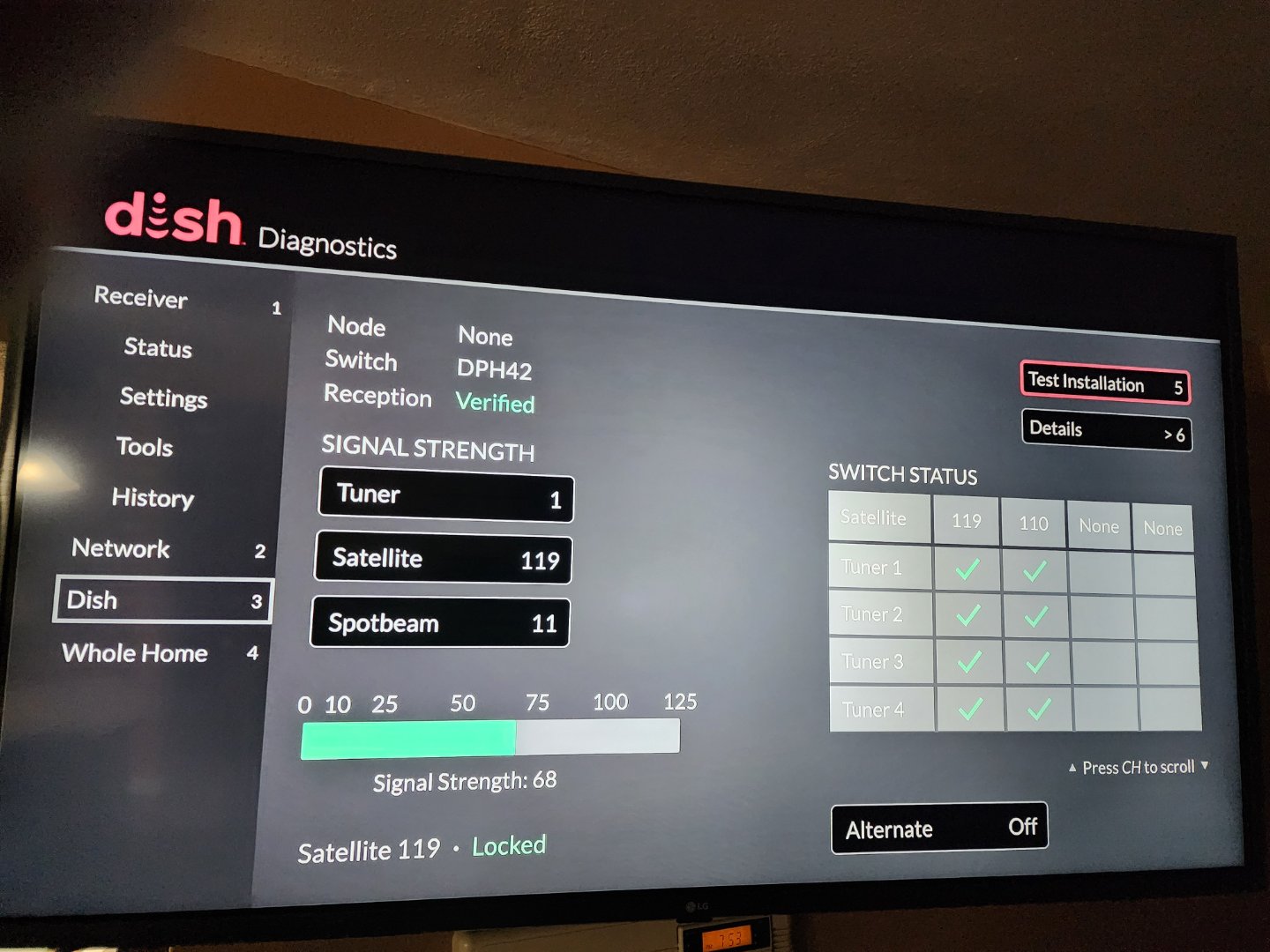

LNBs are hybrid. My old dish had the old DP LNBs. Yep, 129 is along for the ride sticking out there like a sore thumb, not connected to the switch or dish. I would do anything the get the new two LNB style Western Arc dish. Here is pic with just 110 and 119 connected to my DPH42 switch.

That kind of REALLY changes things as they apply to my configuration, as in they don't. My old configuration is pretty much what you now have. I'm asking about getting 32 independent tuners from two Hopper 3s operating as Charles does. The range of available equipment and their (in)compatabilities and similar nomenclature leave a lot of room for confusion in both trying to communicate for humans and equipment. ;)
Thanks, this answers my question, that if the 129 is not connected to the DPH 42 switch then the switch test will still complete successfully. I've got the Duo Hub and everything sees everything, I just can't feed the 2nd H3 the LNB port 2 output, yet.
