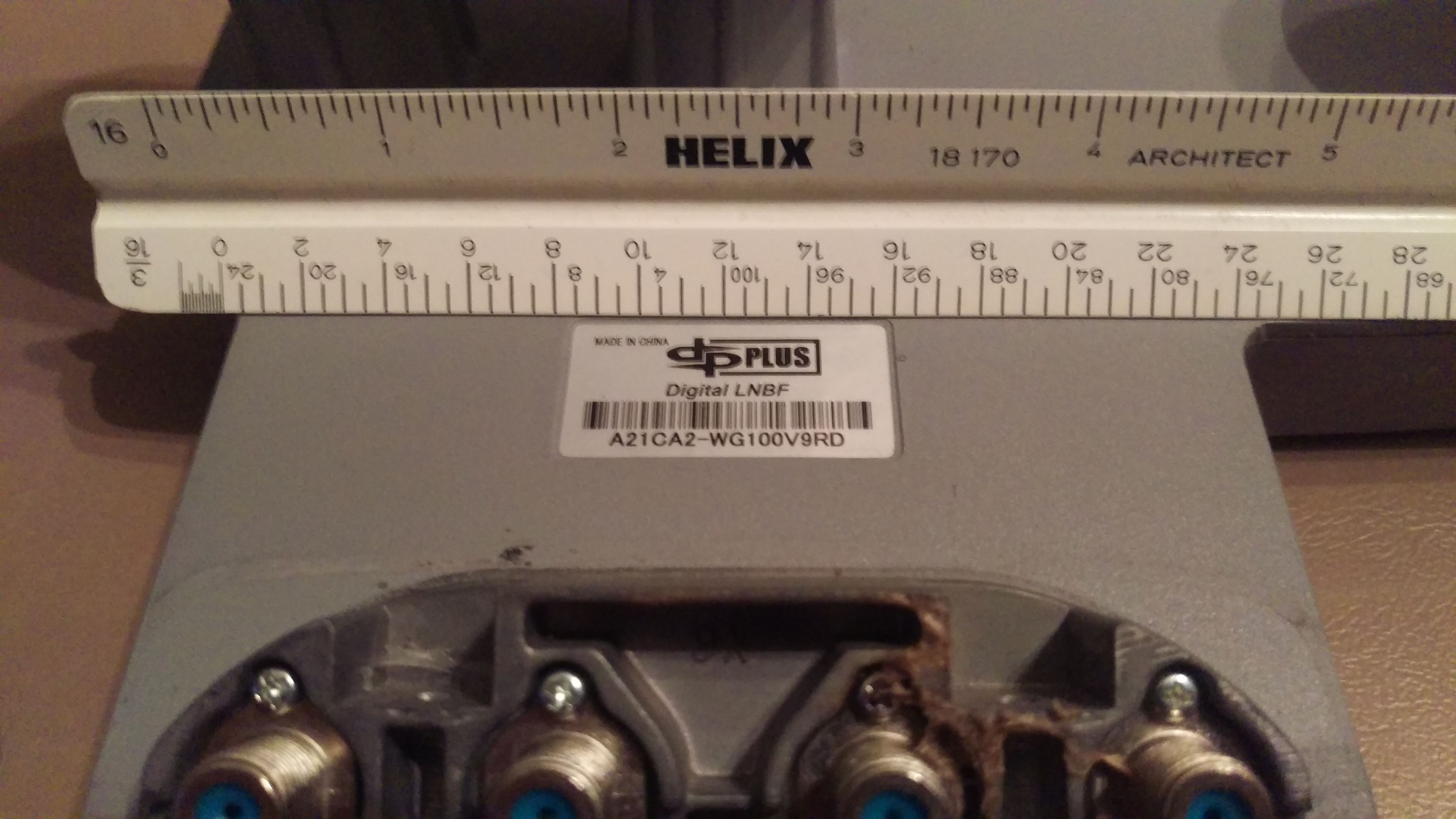

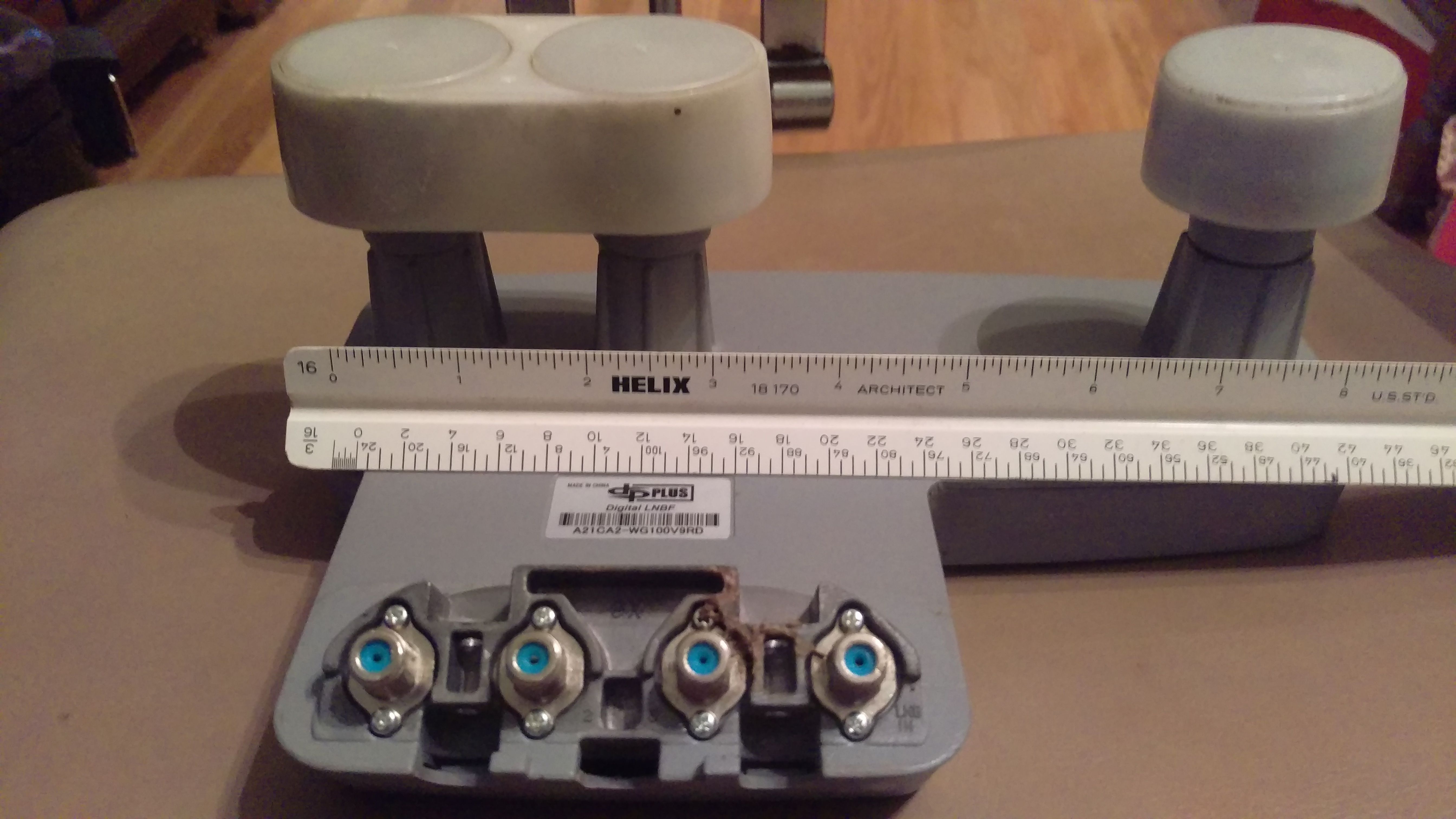

This LNB was on a Dish Labeled Turbo HD (one that has the fine tune adjusting screw for elevation).
I have searched and searched and read and read and I am still confused.
I have an older MPEG2 Receiver, I think the 625, and can't use the Eastern Arc. My question is, will this LNB allow me get 110 and 119? I think that all of the SD channels on WA are on 110 and 119?

In that LNBF the switch is setup 77.0w = sat 1 72.7w = sat 2 and 61.5w = sat 3 You would need to use the 72.7w LNB and the 61.5w LNB and they are backwards of what the receiver expects I believe.

I believe that dish is a 1000.4 I don't think that LNB will work
For the WA you need a WA head. There is one for the DPP 1000.4 dish
I love the 1000.4, still see them around occasionally . Requires a bigger LNB ** Width** but all in all it was nice to adjust those. But putting up 1000.2 WA setups 3-5 times a day( assuming all new connects/movers) a change would be nice.. New model.
OP as many have mentioned it's a Eastern Arc LNB for a 1000.4 Dish Kit

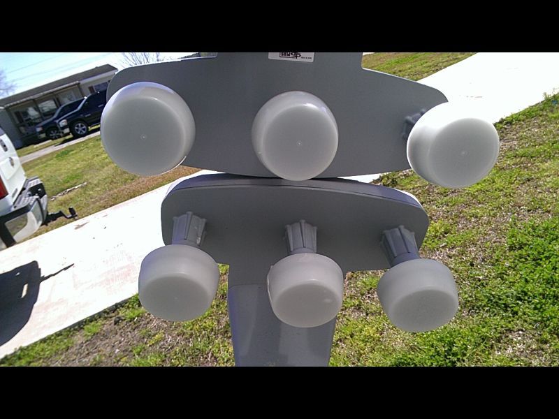

And, he answered you. The spacing is different.
Here are the two WA lnb sets for 1000.4 and 1000.2, the 1000.4 being the larger.

The 1000.4 is easier to dial in for either arc than the 1000.2. It has fine tuning adjustments for the elevation and azimuth that the 1000.2 is lacking.
