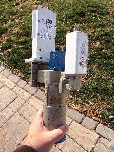

I got this from a local tv station who we upgraded from a old GI 650 which died to a new Geosat Pro C Band Lnb and MicroHD receiver.
They have been very happy with the upgrade!

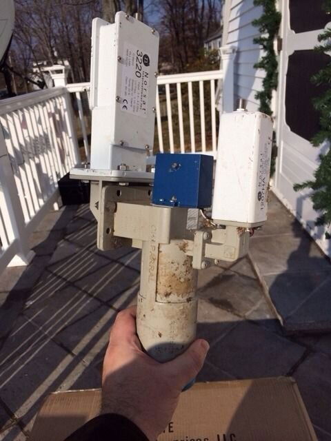

So is this (See photos) good? ImageUploadedBySatelliteGuys1386184214.938128.jpgImageUploadedBySatelliteGuys1386184226.189241.jpgImageUploadedBySatelliteGuys1386184235.089855.jpg
No I have the scaler ring, just not in the pic. :)
It was working when I took it out of service. The issue was the old GI 650 fried, but was using it with the MicroHD only issue was it wouldn't change polarities because of the co rotor. :)
The LNB's are Norsats which should be decent. :)
Yes sir and get you a ASC-1 and you will be set with the micro. :)
No those lnbs are junk. Send them to me and I will dispose of the hazardous waste (no charge).:D
