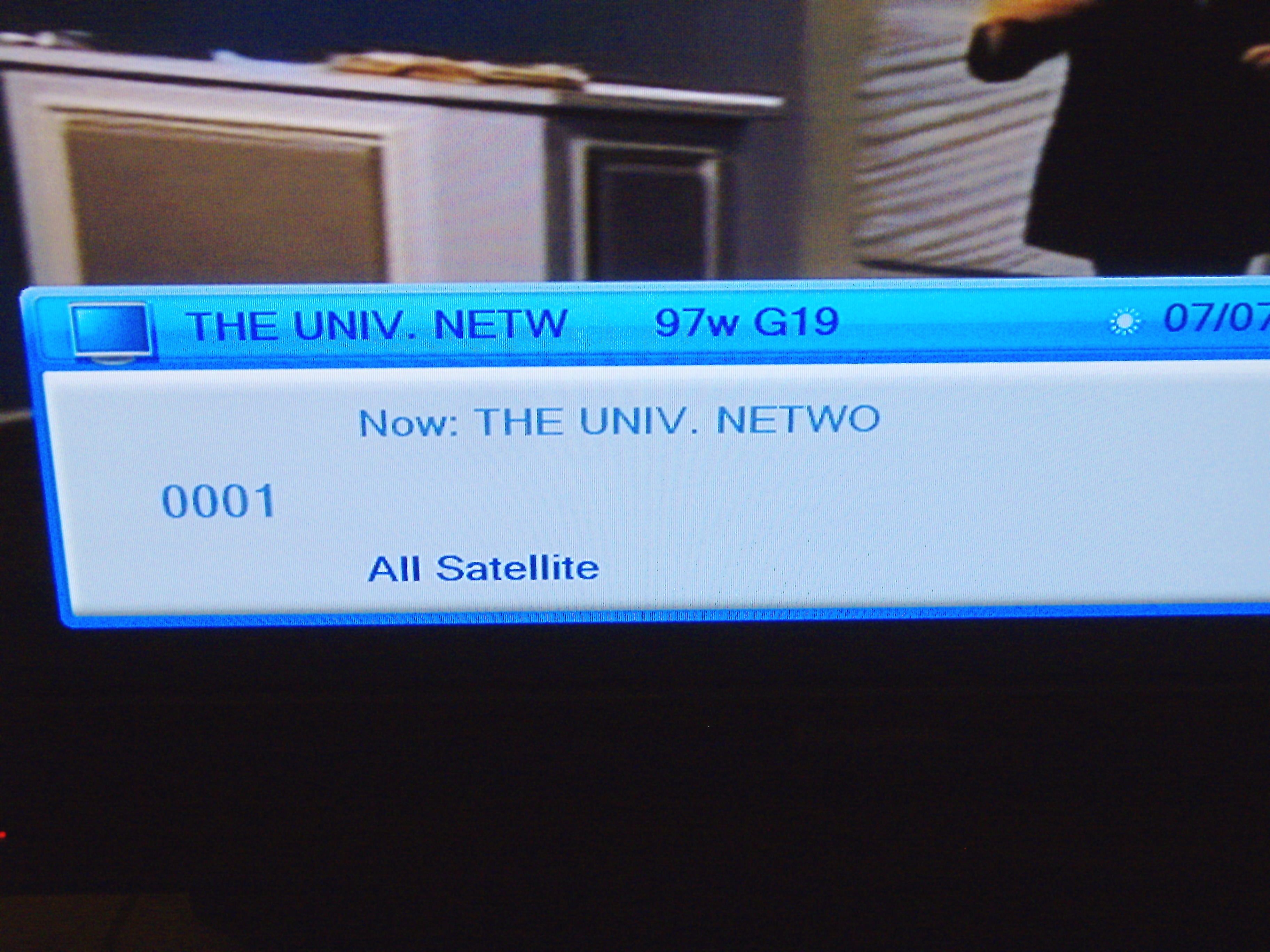

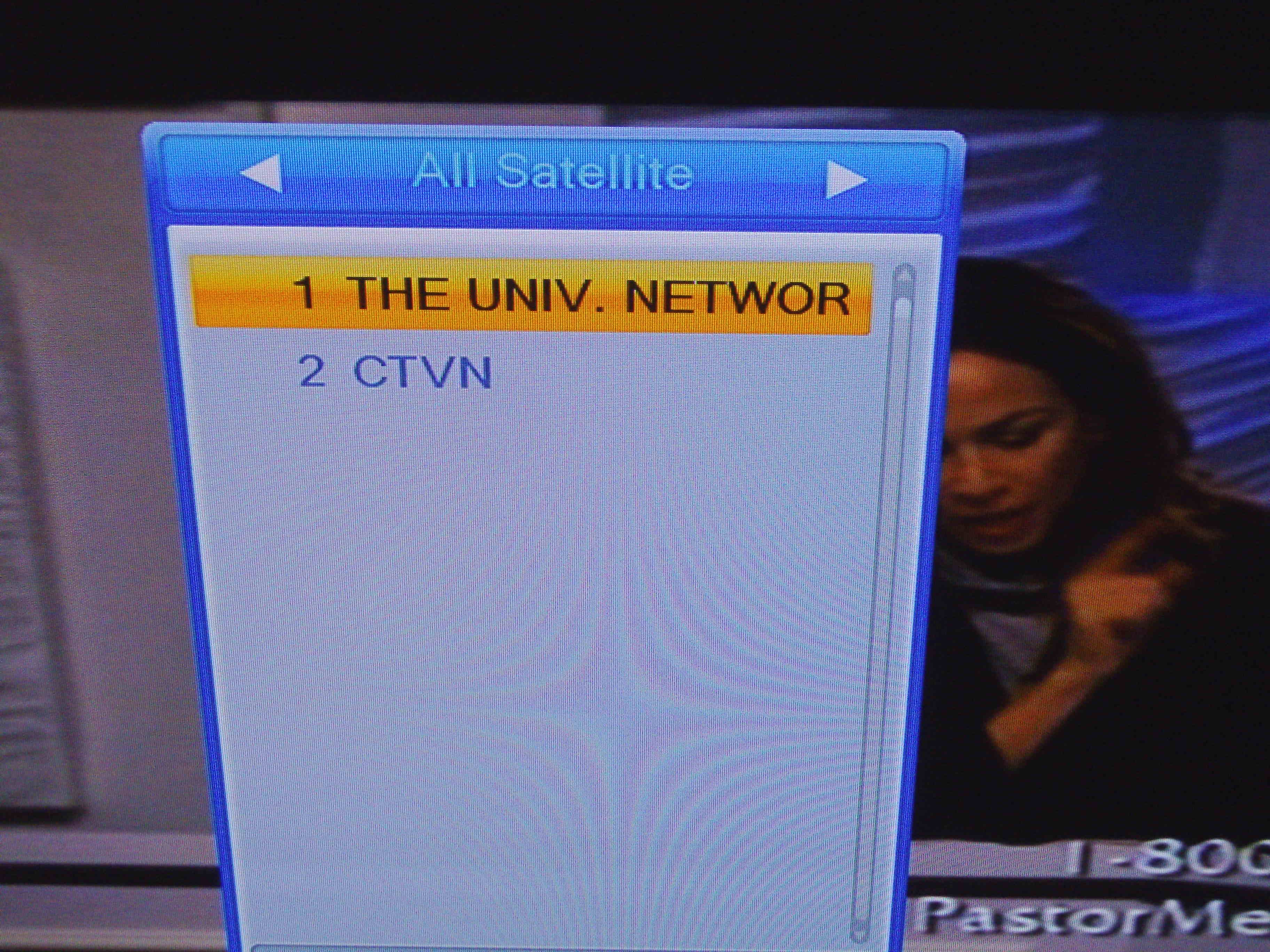

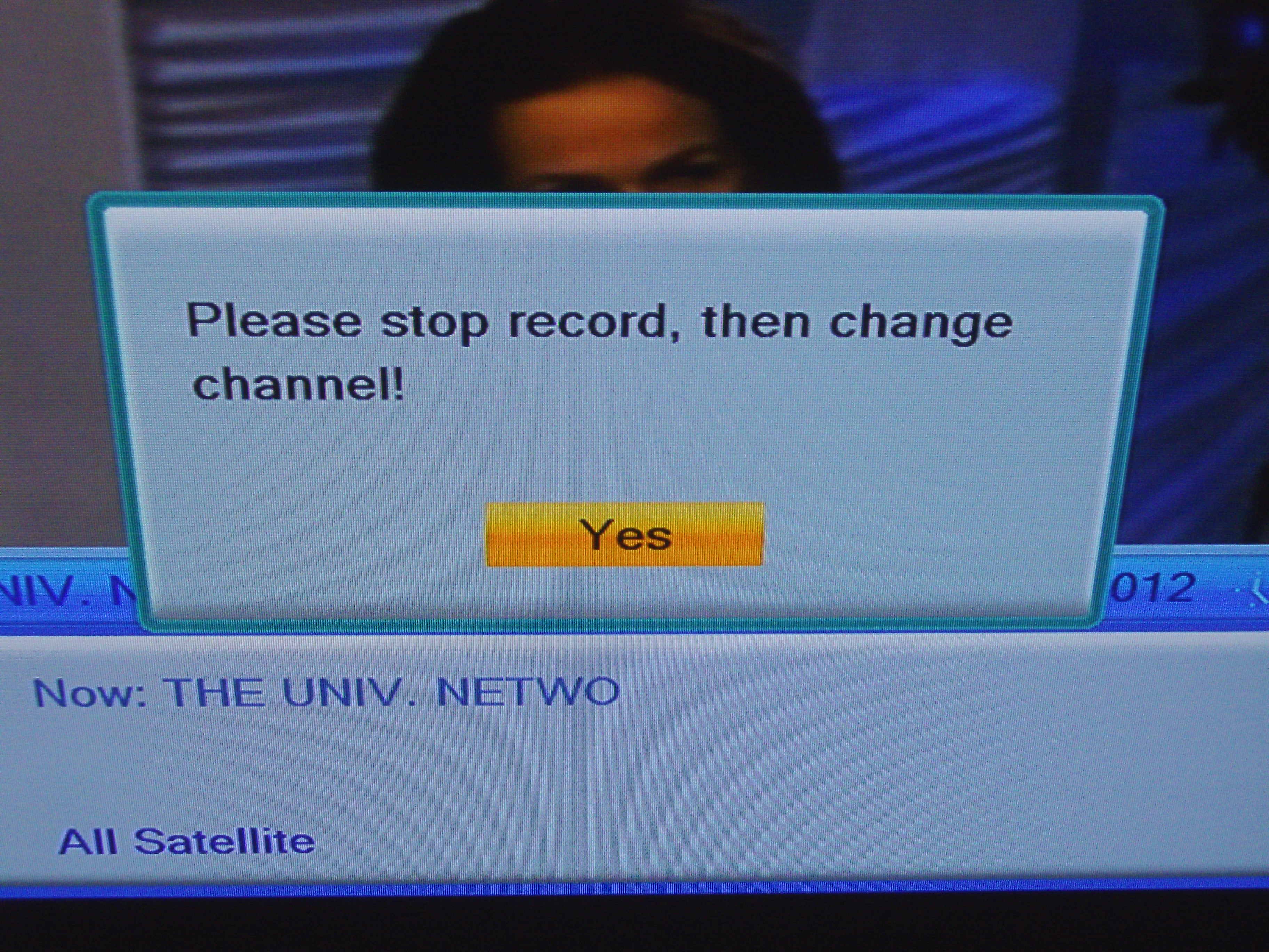

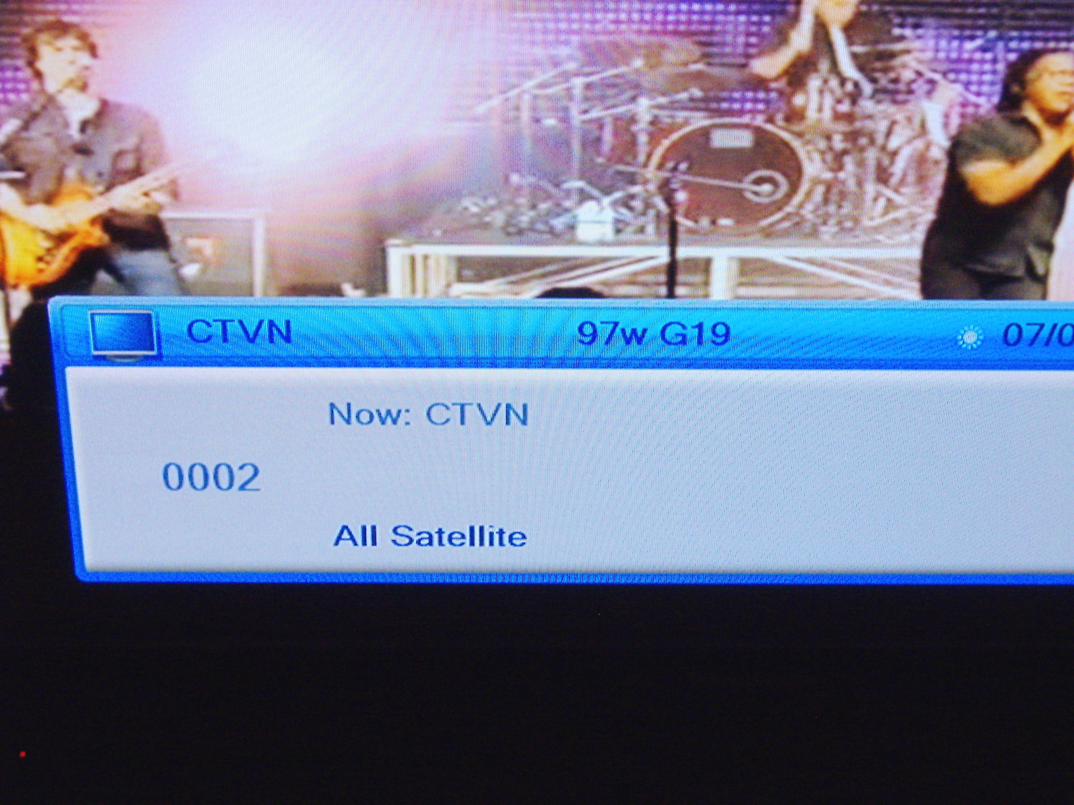

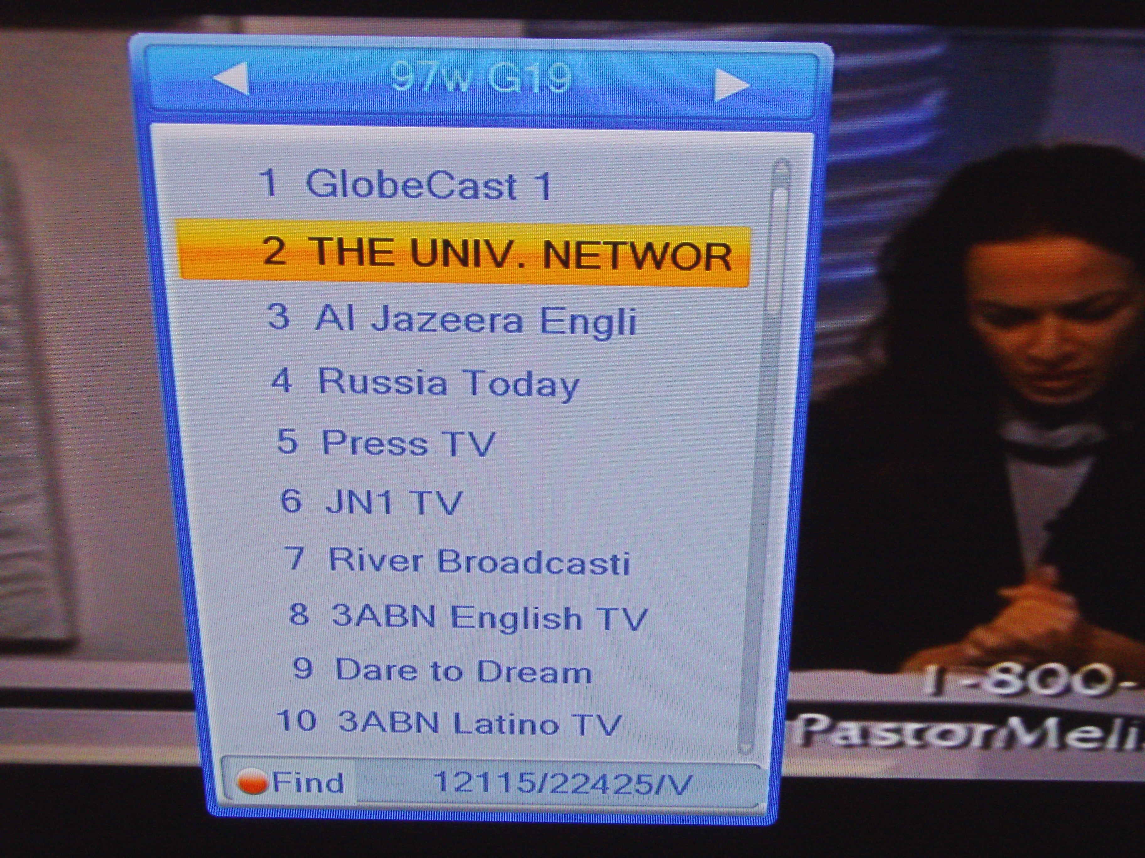

Here is what I mean
with new software
1st pic is my 97W list
I start recording Doc Scott
2nd pic is what it shows when you press "OK"
3rd pic is what it shows when you press channel up or down
so I rolled back to 6/29 software and then tried it
started recording Doc Scott
4th pic shows when I hit channel up...it goes to Cornerstone and it shows channel 002
5th pic shows when I hit channel up again...it goes back to Doc Scott

Here is what I mean
with new software
