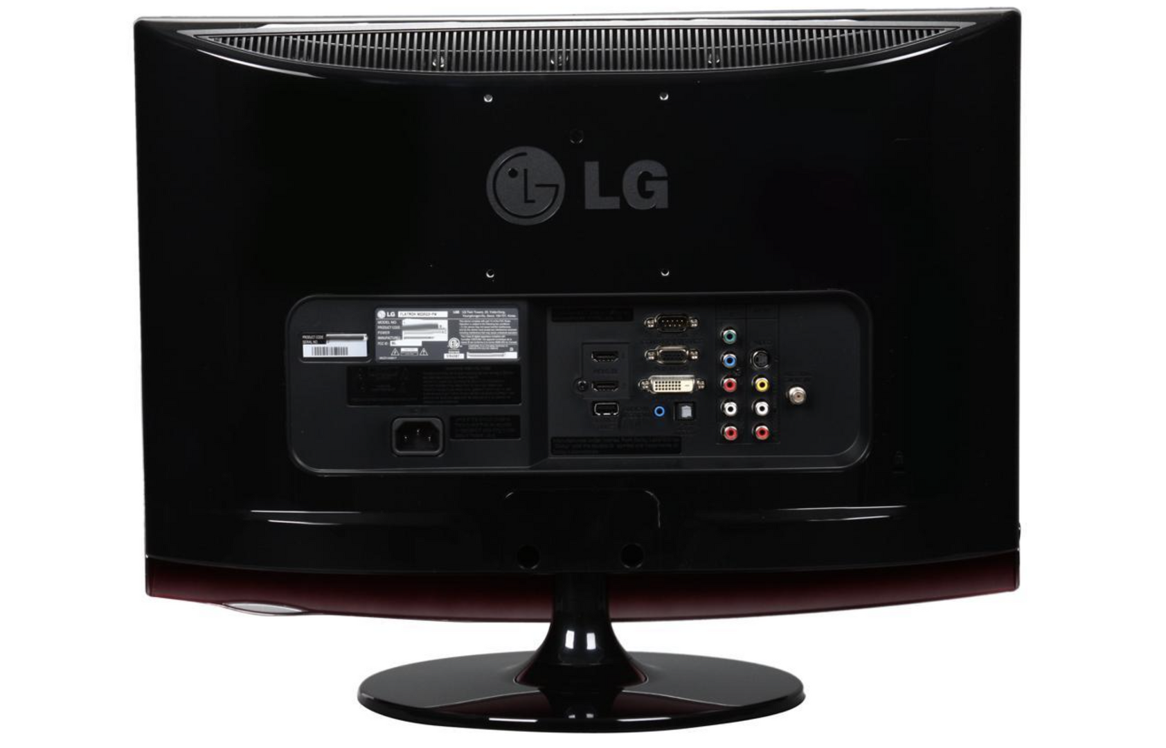

I Googled that and it looks like that had component AND composite out puts...or am I finding the wrong item. Is this a 22 inch monitor/TV?
It sure looks like you are correct.

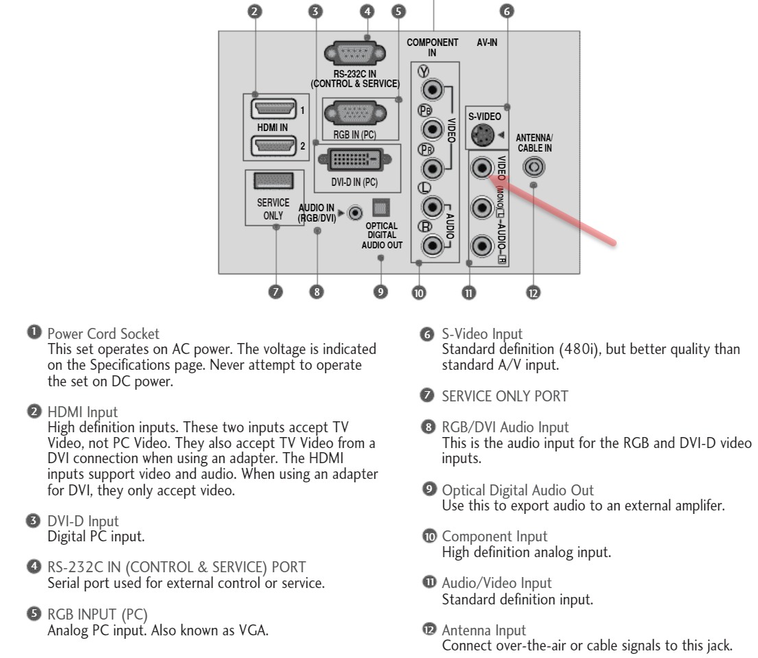

Make sure the yellow cable goes to where the red pointer points to...
If that doesn't work, then it is possible the Video output is broken on the Joey side or the input on the tv side, do you have anything else to test the video input on the TV. Composite video has the processing done on the source equipment while S-Video has the signal processed on the receiving side.

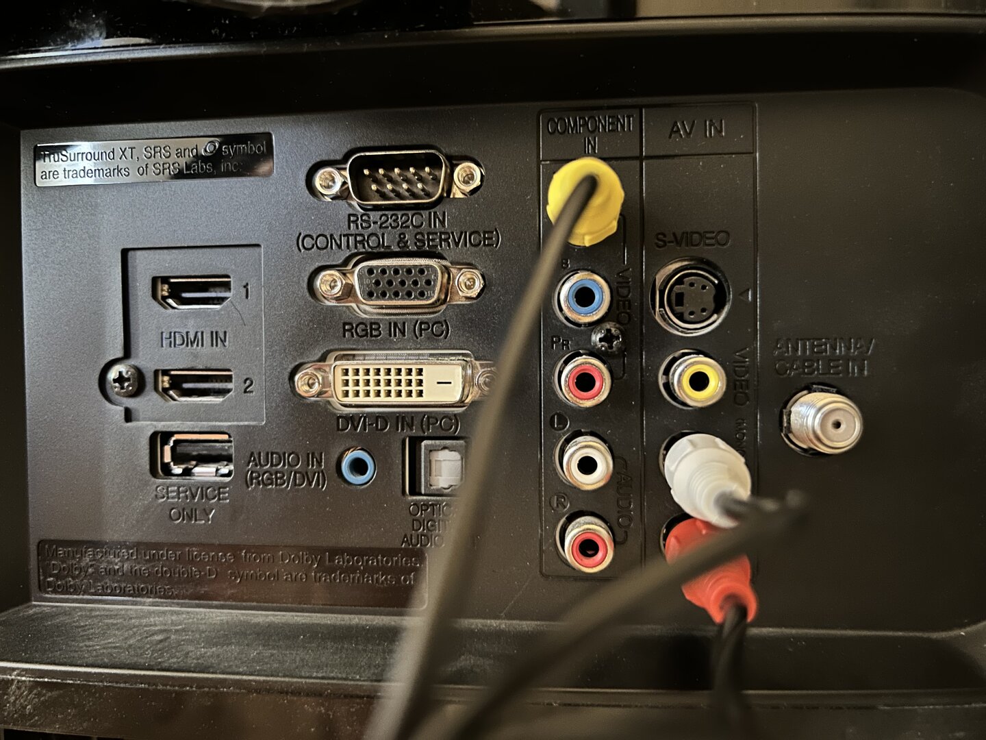

I have done that multiple times. The only way I can get a video signal is to take the yellow input and plug it into the top port on the component section on left. Still only in black and white
Something tells me that dishdude is on to something. I'd bet that your monitor is set to component and not AV (or composite.). You need to go into settings on your monitor and change that.
So if it gives you the black and white on component then we atleast know the Joey sude is good. The fact that you get nothing on av says that you're either not on correct input or it has just quit working.
I'd still definitely do the hdmi splitter. Can get one at Walmart for like $20 and have it fixed in a few minutes.
