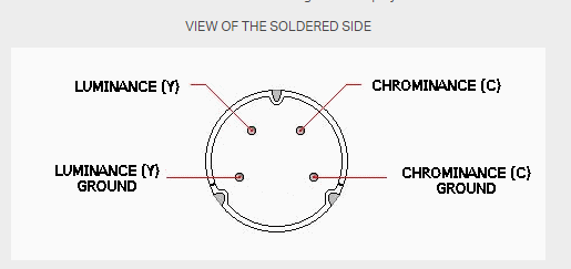

The S-video connector also carries right and left stereo audio.
No it doesn't, only HDMI carries the audio. Component carries the colors in three separate cables. Composite and S-Video are both only for video. From what I understand back when S-Video first came out was if the 3D Comb Filter was better in the source equipment than the TV, to use S-Video and if the TV has a better 3D Comb Filter than the source equipment, to use Composite, atleast that was how it was with LaserDisc Players and SuperVHS VCRs. Here is a good discussion of it:
The audio for both composite and Component can be carried with 75 Ohm RCA SP/DIF or Toslink should it be digital or the regular stereo RCA cables.
"S-video has higher quality than composite video because it uses two channels to encode video information, while composite video uses one channel. S-video separates the black-and-white and color signals using conductors, which improves image quality and eliminates visual defects like dot crawl. S-video is also known as Separate-video, Y/C Separated video, or Super-video."
