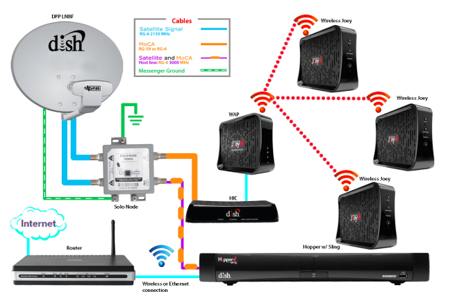

The Wireless Joey use standard AC WiFi.
1. You can reposition the access point, extending the cable
2. You may use HIC - see pic below
3. You may try connecting dish wifi "n" adapter to the USB port and use your own wifi router (never tried that, not sure if will work)
wireless-joey-with-hic-png.102645
