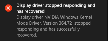

Really weird stuff I have never seen before. Message telling me to use the power button to shut down. Hit the windows key and my logon picture shows up. Lots of warnings from FAH. I'm on my old laptop running Win 10 now. Kind of strange LOL Trying to sort this mess out. My wife was trying to use the computer last night and it all went to s**t. The folding machine had all the FAH errors and no start button operation. My main machine will boot but will not change users.

My next suggestion would be to down load an earlier Nvidia driver and don't let it update to the newest one.
If you just had a Win 10 update, I would suggest downloading the Nvidia driver and reinstalling. If you haven't yet, turn off automatic updates for drivers.

I think what caused FAH to have issues was a failure on my ISPs part. I lost DNS service kind of. All static IPs on my LAN had no internet but all DHCP IPs were fine. F@H was unhappy and screwed up something in windows for a bit. But that was the straw that broke the camel's back. My wife came unglued on me ;) No more F@H for awhile. :(

Well I did confirm not being able to switch users until I shut down F@H. Then it was fine. Afterwards I did let F@H finish the units it had in progress, but did not try switching users during that time. It may have been a priority argument between windows and F@H. F@H was like "Just a minute I have to phone home" And windows was like'No! I want to shut down now! And the power struggle ensued leaving the computer user without ;) But like I said before, there was all kinds of things I have never encountered before and I did not take the time to study it. My wife needed the computer and that was first. There still may be something lurking around waiting for me to start F@H again. The folding machine did windows repair and seems to be fine. The wife was complaining of the heat and we are having a record hot spell this week. I can't believe I want to turn on the AC before the irrigation system.
