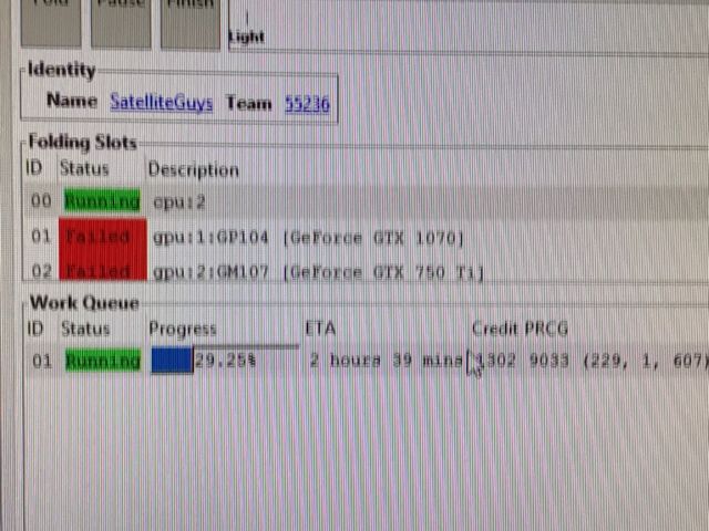

Well this morning I came in and both GPU's showed they failed in F@H.
I uninstalled FAH and reinstalled it.
Immediately one of the GPU's failed. the other one worked. Got it on video.
After that I restarted the failed GPU and started folding again on the first download.
I am at a loss here.
Are you running the newest Nvidia drivers?
I had been keeping my updated, myself, even though there are reports that some of the newer ones get you less points....I never had that issue.
Until about a month ago I kept getting failed GPU's. So went back to a previous driver and all is well.
They have another new one now past the "bad" one(at least for me) I have not tried it yet. No real reason to though, as I don't game on that PC.
Yeah, over on the Folding Forum there's an active "WARNING: Do not Install NVIDIA 375/376 Drivers!!!!!" thread. The problem is made worse by Windows 10 updating things in the background. I haven't update my NVIDIA drivers on my Ubuntu nodes as the newer versions have the same issue under Linux as Windows with the new Core21 GPU client.
It pretty much kills the GTX 1050 cards as you need the latest NVIDIA drivers for the card to be recognized.

Arggg not the way I like coming in on a Monday. And that is with the old drivers. :(.
Scott Greczkowski go into configure and then slots and remove the CPU. See if that stops it from failing.
Are your temps looking good after it has been folding for awhile?
