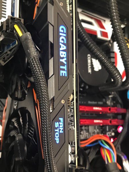

Glad I have a clear window looking into my computer so I can see the motherboard and cards. I just looked over at my GTX 1070 card and seen it displaying "FAN STOP" in lights light on it.
I loaded on an graphics card overclocker tool and have got the fan running on it again. Temperature is down to 34 degrees Celsius and the light is off again. (Note nothing is overclocked on this system)

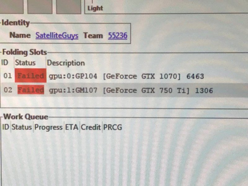

Not sure how long it was like that. Although I notice both my F@H slots on this computer are now reporting failed.
I have changed the resolution going to my monitor to 1920x1080 as it was in 4K Resolution (I got a 32 inch Samsung 4K monitor a few weeks ago) and hope that helps as I can't afford a new video card right now.
Now I need to figure how to get the folding going again on this machine.
Still not folding. Also found the fan was stopped on the other video card so something funky is going on.

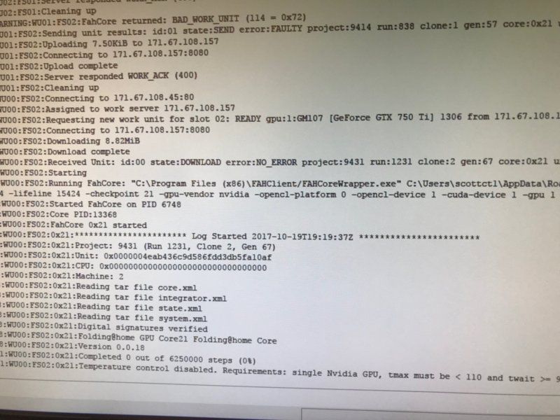

So did some research on this and had some people say they fixed this by rolling back the NVIDIA drivers.
I went and looked at my drivers and see that Microsoft replaced my drivers with microsoft drivers, so I am now installing the NVIDIA Experience and NVIDIA drivers again. I hope this helps.
Reactions: Foxbat
Ok NVIDIA drivers installed and system rebooted.
Folding@HOME is working again and Fan Stop light is off, fans are running on both video cards without using the overclocking tool to control the fans. :)
