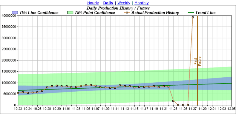

Well...my home setup has gone to crap apparently. Checked the stats this and realized I've generated almost nothing for a few days now. :confused:

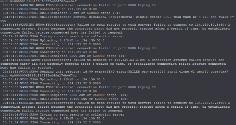

Got home, checked the logs, and just getting this over and over. No changes in home setup or network in weeks. Anybody have any ideas?

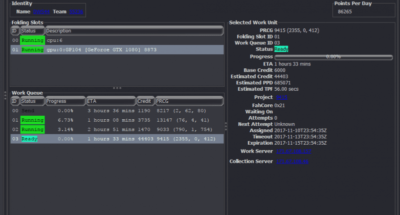

Main status screen:
The error log says that Stanford is not responding. That usually means one of two things:
1. The server is down
2. The FAH client's ability to phone home has been cut off
The work server is responding to pings but it isn't responding to HTTP or HTTPS requests so I'm guessing the web server portion of the work server is down.
As it turns out, I'm having a similar problem with the same server! It is timing out on an HTTPS connection and the server is "actively refusing" an HTTP connection. Fortunately for me, I'm part way into a unit so I'm still folding.
It looks like you have two WUs in your work queue that might be causing problems. Queue entry 00 is ready to Send, but as you saw, it isn't able to send. There is a thread over on the Folding Support forum about the 134.139.52.2 & 134.139.52.3 servers not accepting Work. Re: unable to upload to 134.139.52.2 or 134.139.52.3
Regarding Work Queue entry 03, that looks like it probably needs to be released to allow someone else to process it. There was a good write-up on how to make this happen earlier in our Folding thread.
