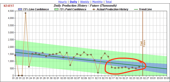

KE4EST, did something happen to one of your rigs? You were out-Folding me by a couple of hundred-thousand PPD, now you're output has been slashed in half!

My Dell T7400 has been under the weather, so to speak. When the power blipped Sunday morning, the workstation did not reboot like my MacPro did. I spent the last 36 hours or so trying to restore it to operation and found out that the LUbuntu 17.04 I was running was past its support date, even though I had burned the DVD back in October. Well, that inhaled-greatly, so I downloaded a new Ubuntu 18.04 LTS (Bionic Beaver) and proceeded to re-re-install a Linux bistro for Folding. After many hours of trying to remember the "sudo apt-get" commands for the various packages, and trying to get Python support loaded for the FAHControl, I had a machine that would not recognize the NVIDIA cards in OpenCL or CUDA. Then it came back to me, I had to Blacklist the default Nouveau Graphics Driver included with Ubuntu distros. It appears to be be Folding on all cylinders again. It will probably take a few days to see how successful I was.
For once, I did a minimal install, no email, Office, Media players, nothing that should be needing updates every week, and a bare minimum of the required things to update. That should help. And it's nice to have Gnome back, LiteDM wasn't bad, but things look better for now. And the Dell not coming back? It was hung at the "F1" prompt because the CR3202 coin cell on the MB was bad. Replaced it and now it finishes POST with no issues!:clapping

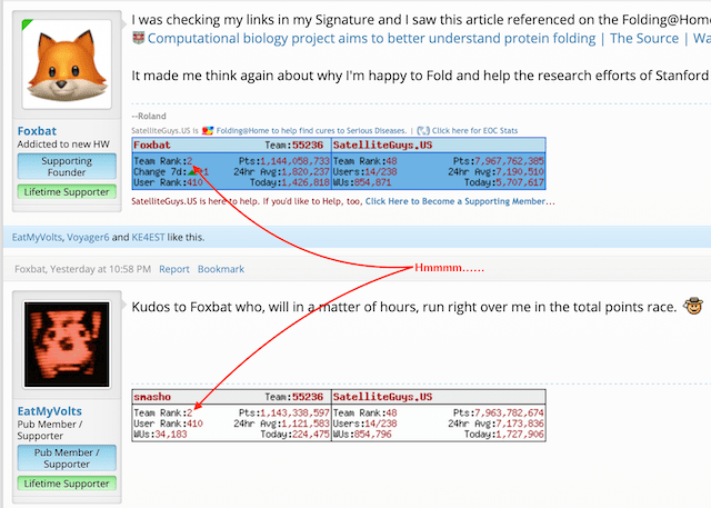

Kudos to Foxbat who, will in a matter of hours, run right over me in the total points race. :hatsoff
Reactions: KE4EST
(I guess we'll call it a Tie!)​
I was wondering when someone was going to notice… :D This is the result of rebuilding both of my Folding workstations, ending up with Ubuntu 18.04 LTS (Bionic Beaver) on both the Dell (it was first since it was powered down) and then on my 2006 Mac Pro. This required loading Ubuntu versions 14.04 LTS, then upgrading to 16.04 LTS, and finally to 18.04 LTS, a process that took several days to achieve.

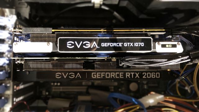

FAH Control shows the RTX 2060 is generating about 1M PPD. Amazon has the EVGA for $350 or so. Of course, I bought it the week before the GTX 1660 was announced, looking back I probably would have gotten one of those and saved $100 or so.
Considering it took a GTX 1080ti to get the same PPD a few years back (and you're talking $800 for one of those,) I consider the RTX 2060 a bargain.

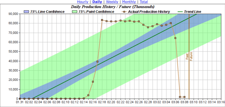

It looks like the Team is going to be at #48 for a while. "Snakes on a Complex Plane" just got their heads cut off:
I wonder if this was another bogus team like the FTL team a few years back? Either way, the top 7 user names on the team were all strings of 32 random hex digits and haven't logged a Point a a couple of days now. Those that remain active are not enough to challenge SatelliteGuys!
