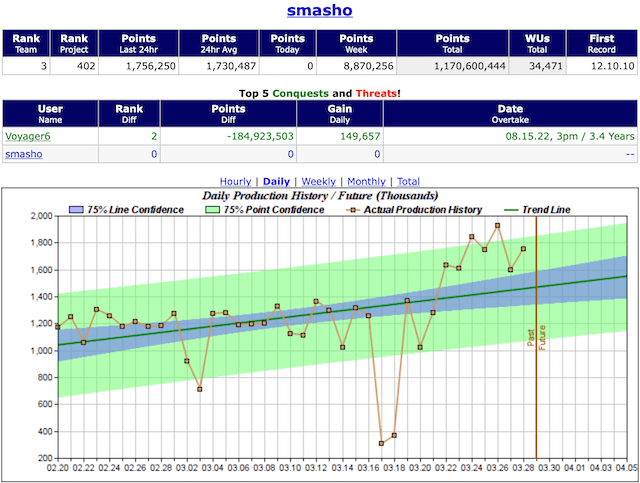

Ouch, the Project 11733 has claimed both my RTX 2060 and my GTX 750ti slots. I expect today will show a huge hit, maybe 40%-50% off where I should be.
What beta takes away, it also gives. Folding the Project 11733 when it was working showed almost 2,250,000 PPD! :D
