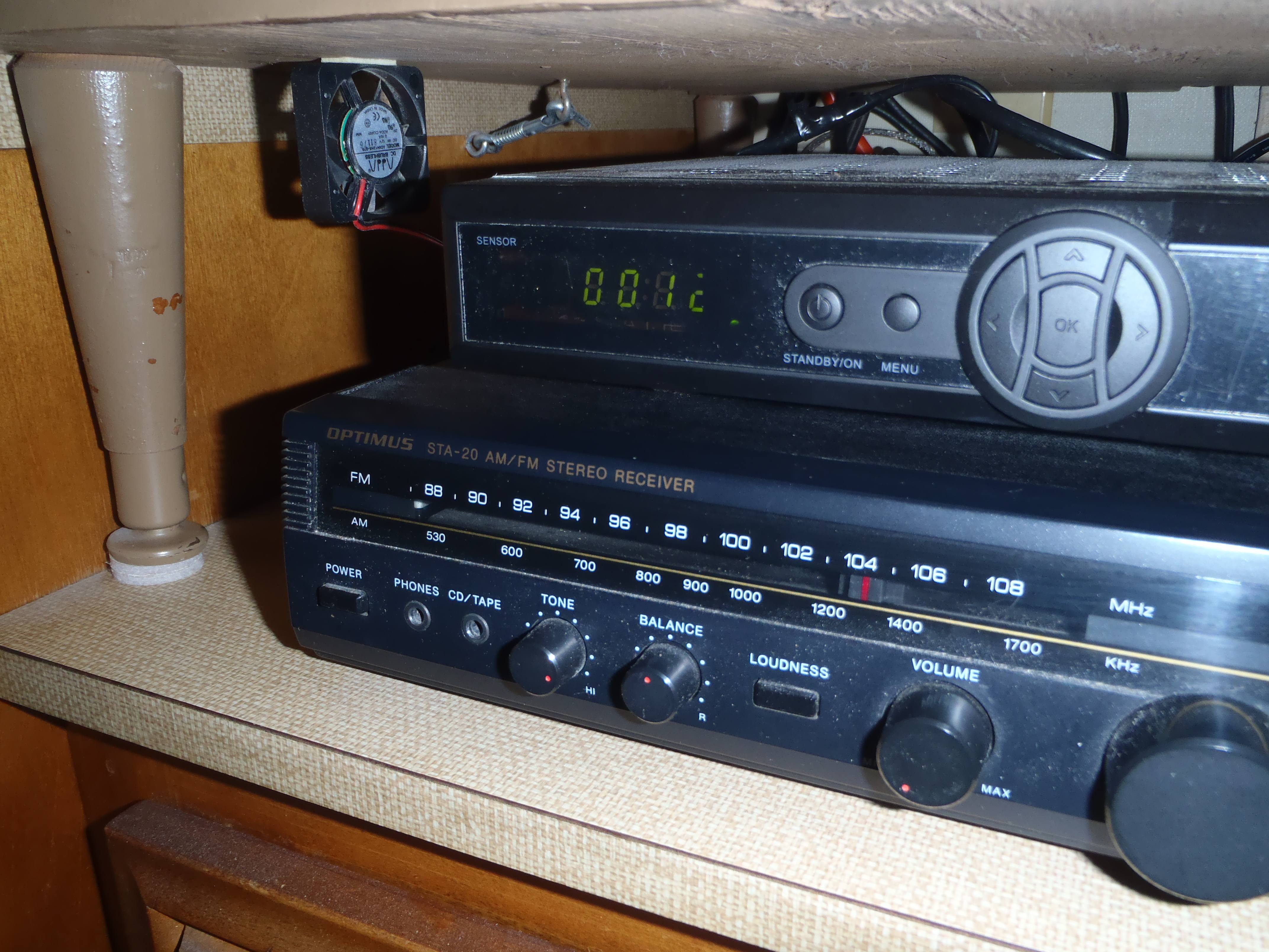

Something that I did and will recommend everyone is to get a real small fan (i got a 6" 115V completely plastic for $7) which is on top and ON 24/7
Agreed on the heat produced! Another VERY cheap way to cool it without modifying or opening is to get a small 12-volt PC fan at a hamfest or PC store, (mine was two bucks) and attach the appropriate wire/connector, and just plug it in to the back of the receiver! Openbox has a jack for DC voltage on the back for which I can't find any other puroose!
My S10 has stayed cool, with NO adverse effect on LNB voltages, and the unit seems "happier". (quicker than when it's running hot during channel changes and menu options.) No extra AC outlets used up this way, and plenty of air moves! Mine is shown attached to the underside of the RV's entertainment shelving with just a piece of two-sided tape!
