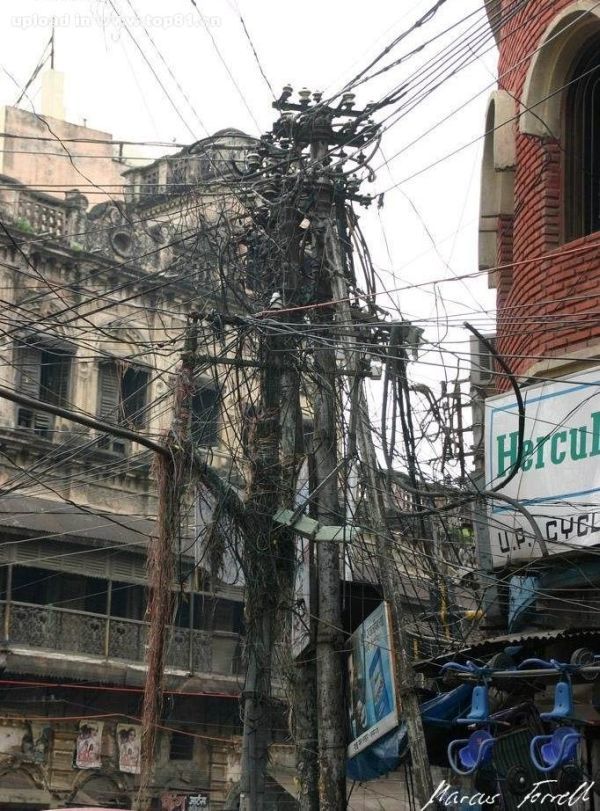

I'm sorry.. how do you compare even the worst in the USA with power (though I've seen some POTS & DSL portals that just make even this picture tame) ... but power.. to like this third world photo?
if i were a lineman of anykind in that city i would hang myself before even attempting to repair something on that!
