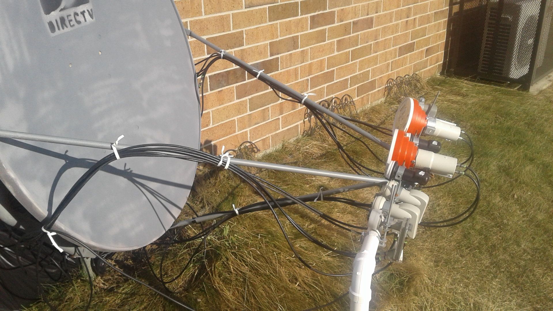

Nestle toll house lids work great fits it like a glove.
Here is a picture.

If you turn it you can pick up more without adjusting the lnbs.
