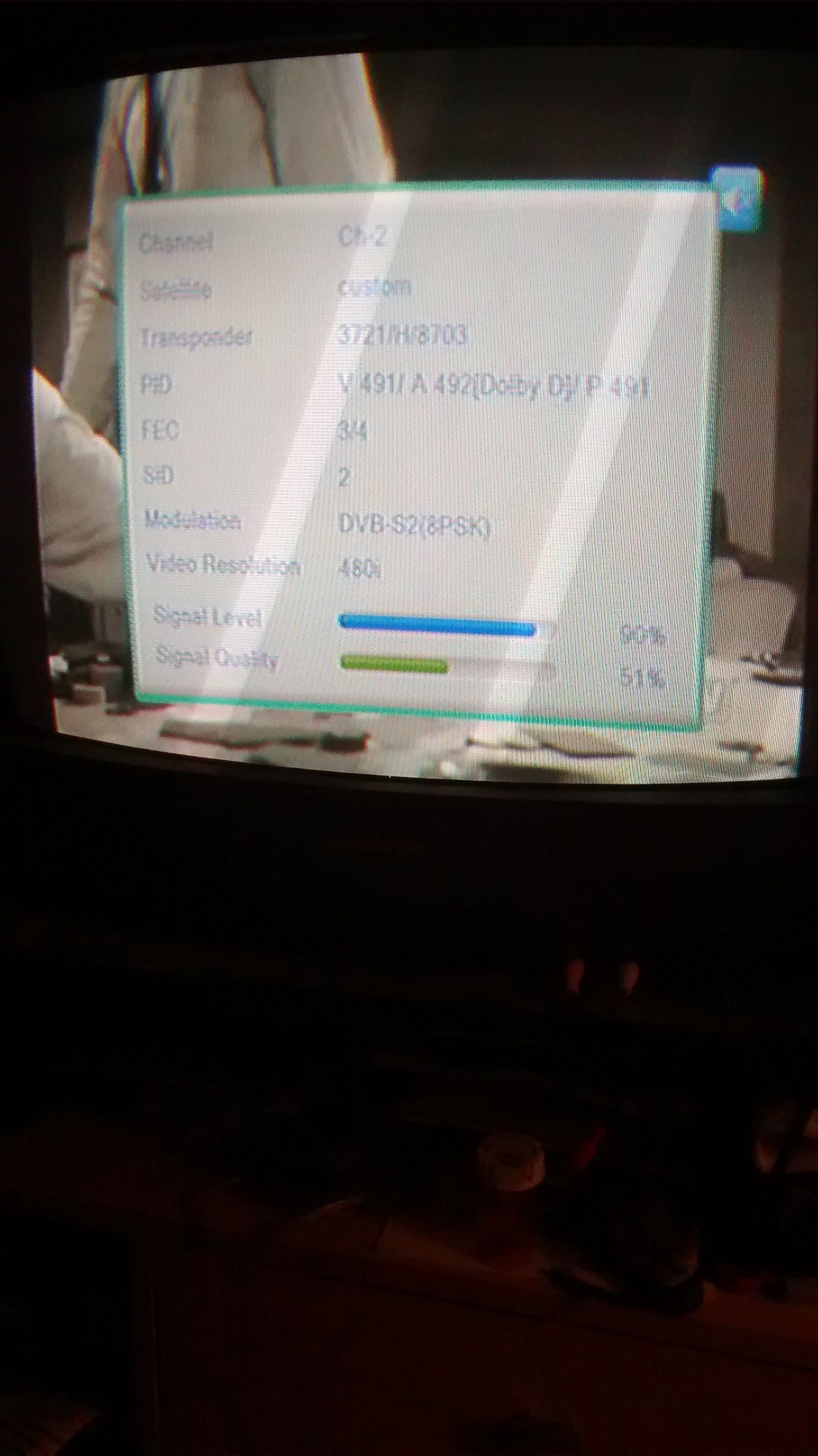

I have been working on this for the past few months since I got the titanium c band lnbf so here it goes. this is my review. First channel I got right off the bat with my dish and lnbf was krbk out of the Ozarks that is what I was looking for. I blind scanned and I got about 50 channels it was an improved over my others that I have tried before nothing in the high symbol rate you would need a bigger dish for that. Since I live apartment I can't have a big dish so I stuck working on the small scale. This lnbf works out great for a small dish I am able to pick 6 or more sats with it on the c band side only the strong transponders. If you have a small ku dish this would work out great for it. I recommend this lnbf to anyone in this hobby.

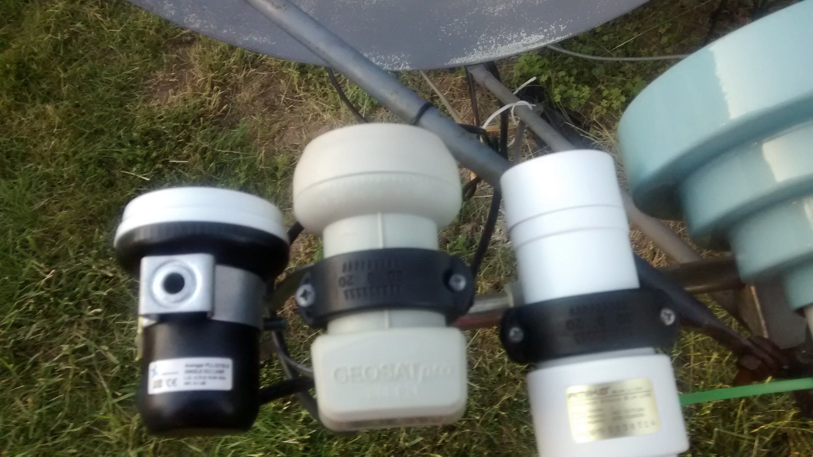

Amiko is at 91w, geosatpro lnb 87w, avenger is at 83. I got 73 to 74 q on 91w at the abc news news transponder. Lpb on at 87 0 to 15 q barely anything on 83w.

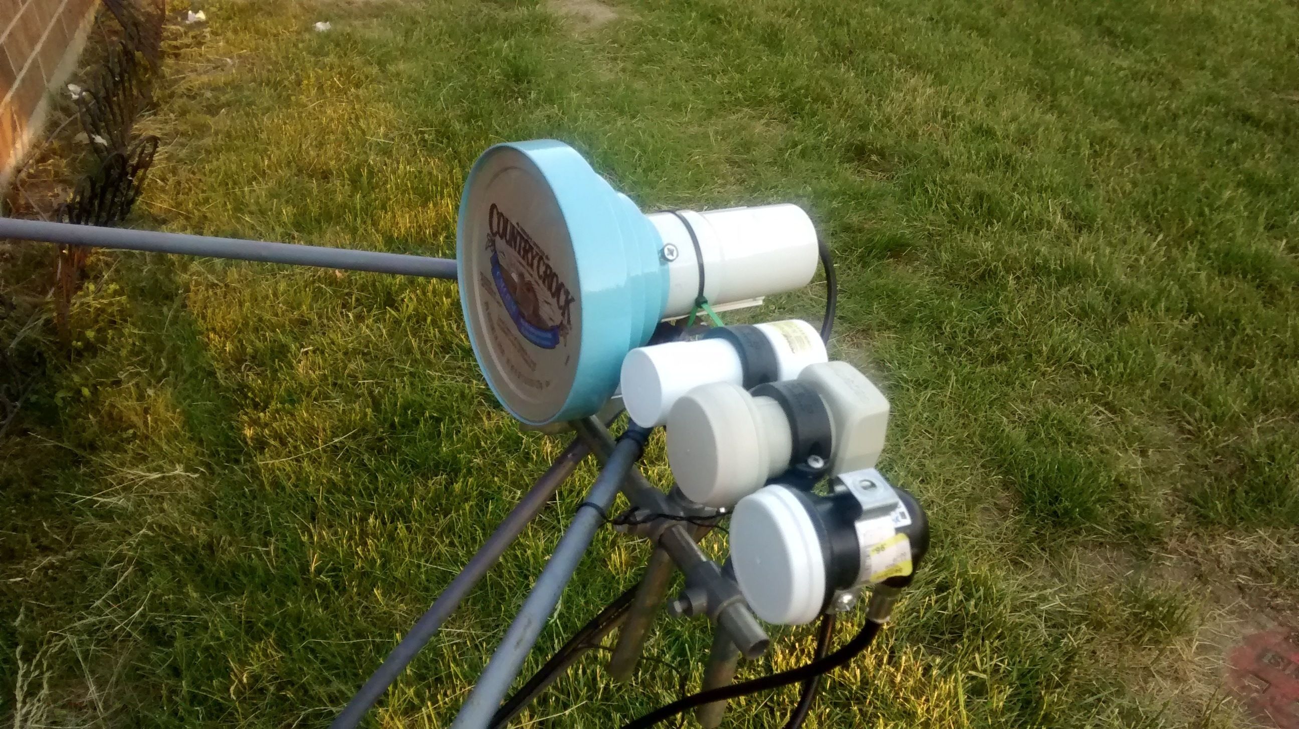

Cool set up..Congratulations!!.. Did you test the signals without the "butternut" cover to see if your quality improves little bit?

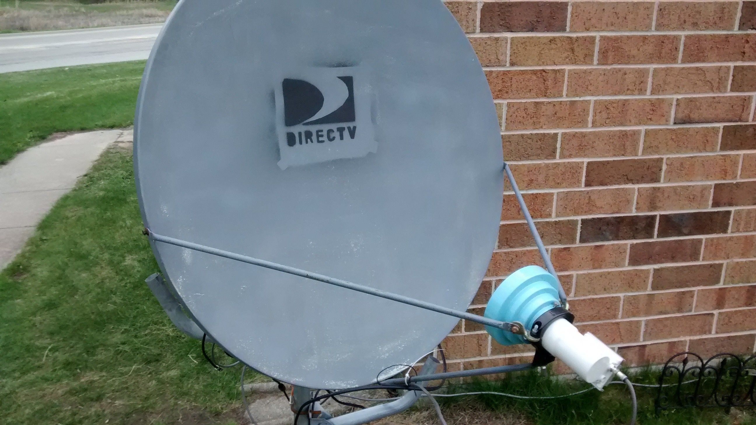

Please look at the dish its a fake logo I painted it on there. The cover does' t block the signal works great I say I get most of 99w expect the high symbol rate stuff.
No it fits just with a little bit of fanagling it pops right in no cutting or modifying. Signal goes right thru with no problem.

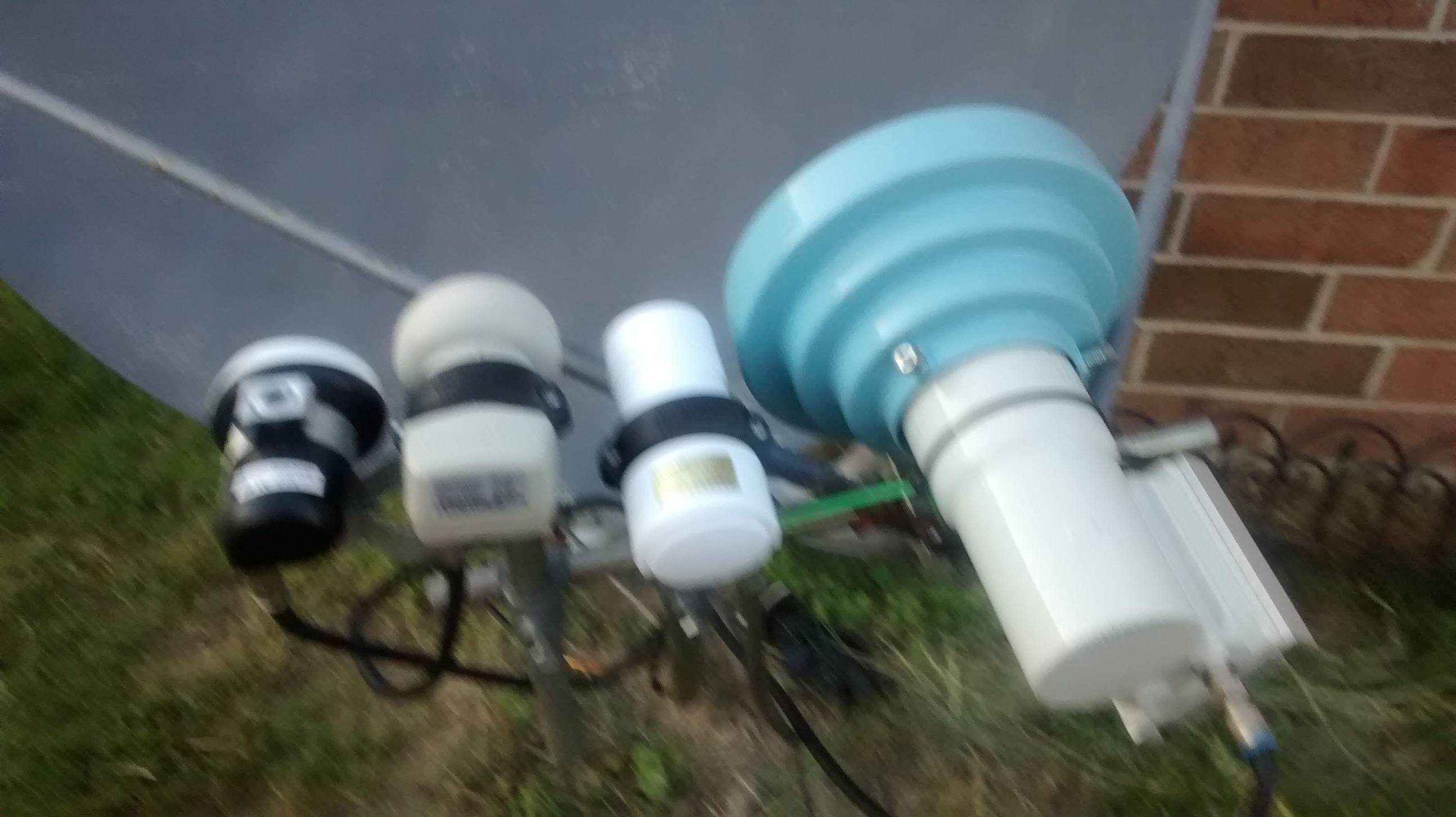

Dan. I got to do the same. At least attempt to do cband on small dish. HOA will not allow Cband and unfortunately have 10 ft in garage. Anyway, I am curious as to how your sidecar is affixed to your satellite. I can't tell by the pictures how you attached to the lnb holder and/or arms. Is it possible to get a closeup picture that better demonstrates this? Thanks.
Reactions: danristheman
Please check out pic 33 it shows how everything is mounted on there. buy a bracket fit it on there the best you and do the measurements there. Send me a pm if you need more info. Twist ties help out and zip ties also.
Thanks Dan. That helps. I thought I saw twist and zip ties. I have the same bracket setup. I can figure this out. If I run into any issues, I'll give you a hollar.
