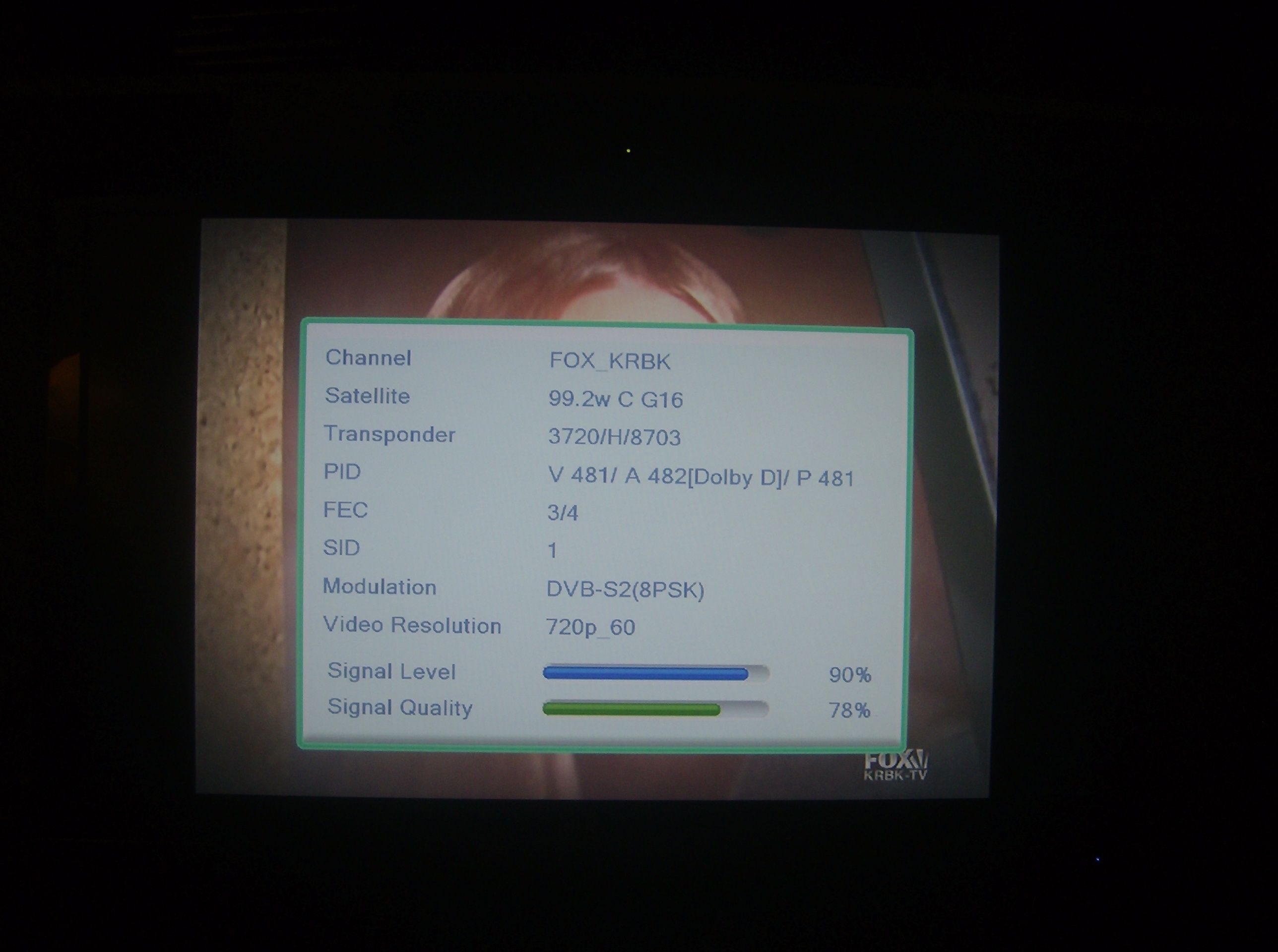

I rescanned 99w and the 3720 H 8703 transponder is taking quite some time to lock. Service logging is hit and miss. Doesn't seem to be associated with the firmware version.
We have made a TS recording of the transponder data and provided for the factory engineer to review. We will work with them to determine how to make the signal lock more reliably on this transponder.
I logged the FEC as 3/4 on a blind scan and renamed the channel. Interesting that some users have different results.

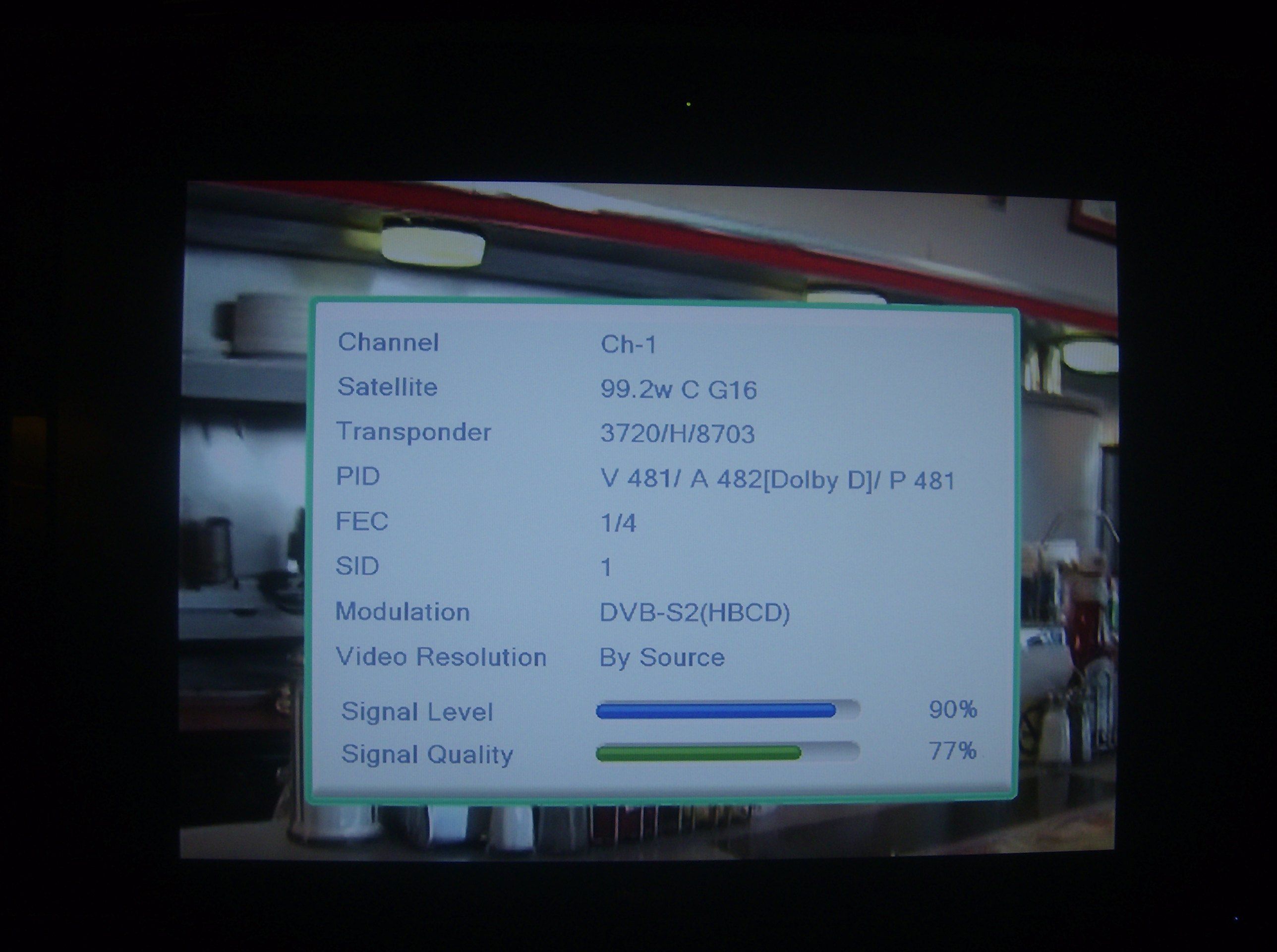

Okay Brian this won't help you at all,using AZUltra originally scanned with auto fec.Went to sat/tp edit,tried every fec,they ALL locked,100% Q.Deleted tp and tried again,again every fec worked??? So I don't know what's going on there,usually wrong fec no lock.:confused:

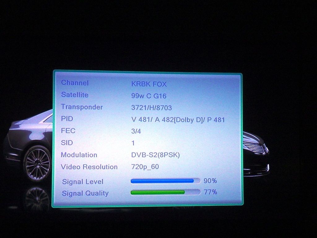

I manually entered the TP and found a new channel, KRBK (see pic). It took a few seconds for the meter to light up, but there it was.KRBK - 99w.JPG
