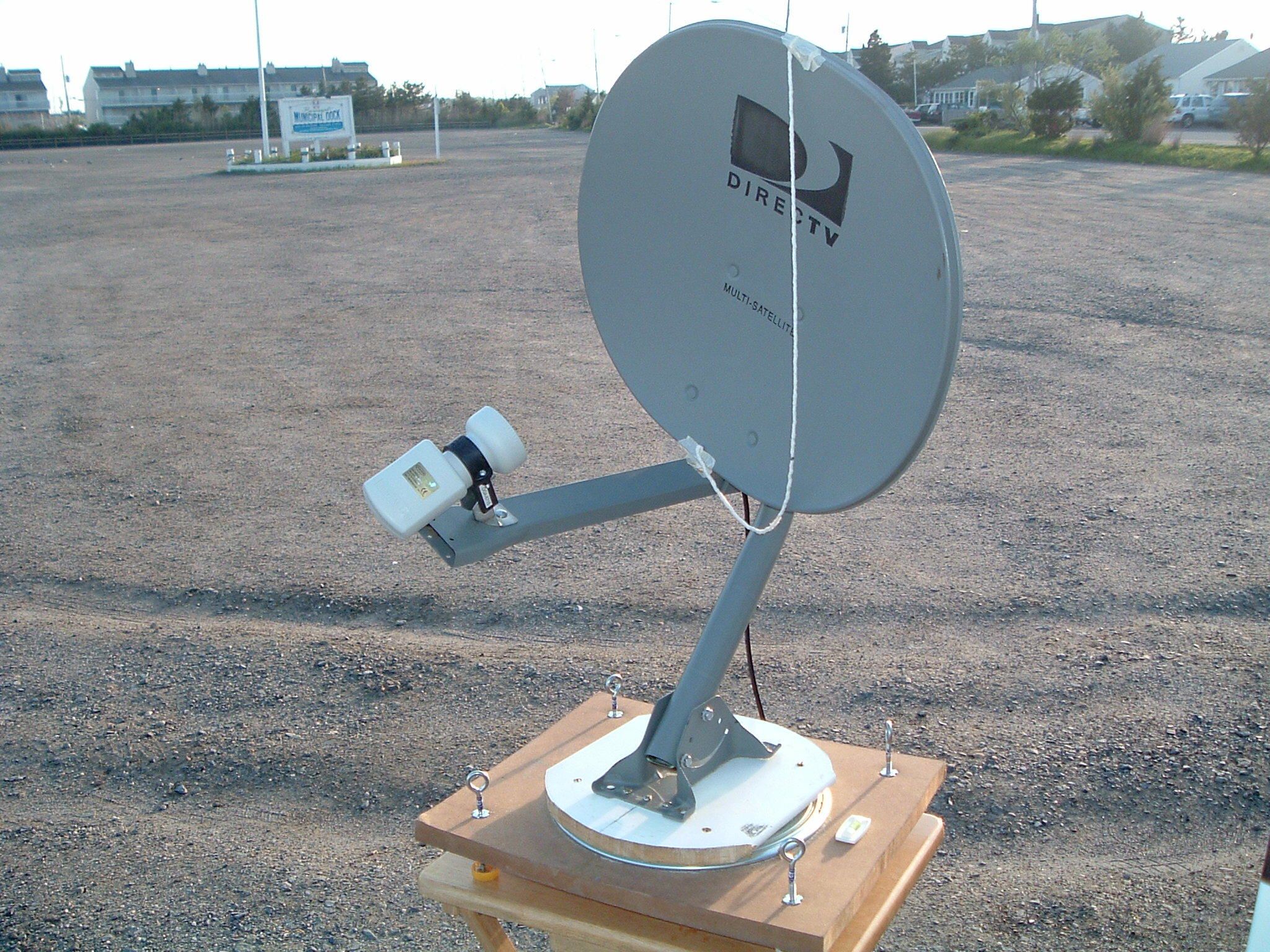

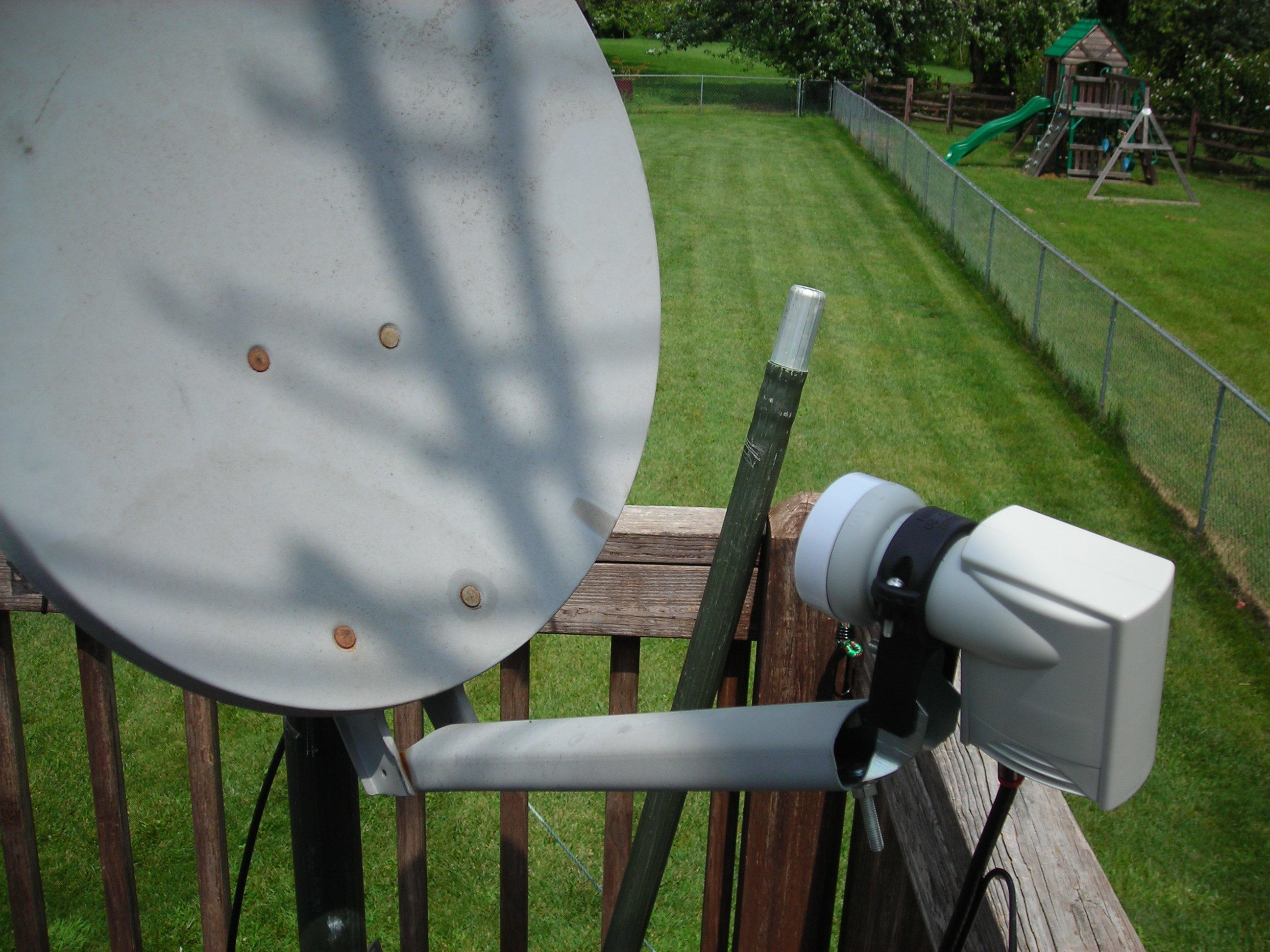

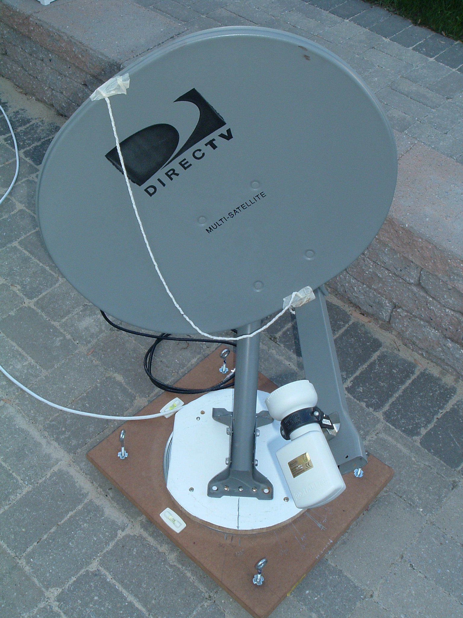

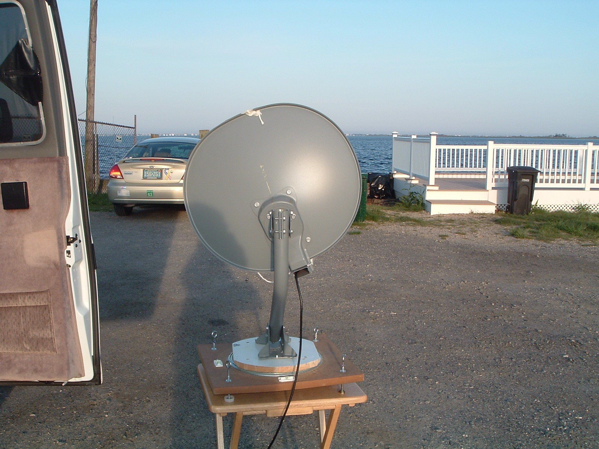

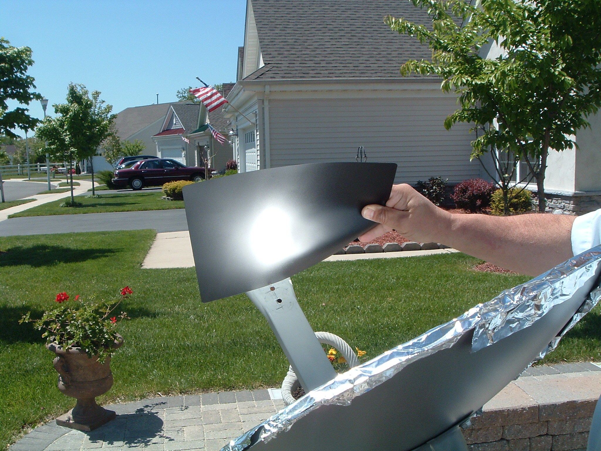

I also used it for satellites that do not have a good LOS from the front of my house. I travel to a location that would have good LOS and use the DTV dish. Look at the pics, included is a pic of an experiment on finding the focal point by tuning the dish with the sun.

As to your DirecTV dish, that appears to be the same 20" wide (18" tall) Phase III dish I used in my Whitesprings experiment (link above).
I was very careful to put the LNB mouth at the exact same location as the original LNB, and yours seems quite a bit more forward toward the dish.

Last month I was visiting my daughter in Charlotte, NC and I bring along the 18x20 DTV dish with a tripod and a motor. I motorized the dish and was able to get an arc from 72ºW to 123ºW.
Actually the LNB is in the original LNB spot. I used W1GHZ trick of taping a string from the top of the Dish to the DTV LNB and taping it to the bottom of the dish. If you observe the arm of the dish you will notice that there are 2 screw holes. (check sun experiment pic) There is approximately 3 holes each spot can be used for mounting the LNB bracket the hole closes to the reflector gives the best signal quality.

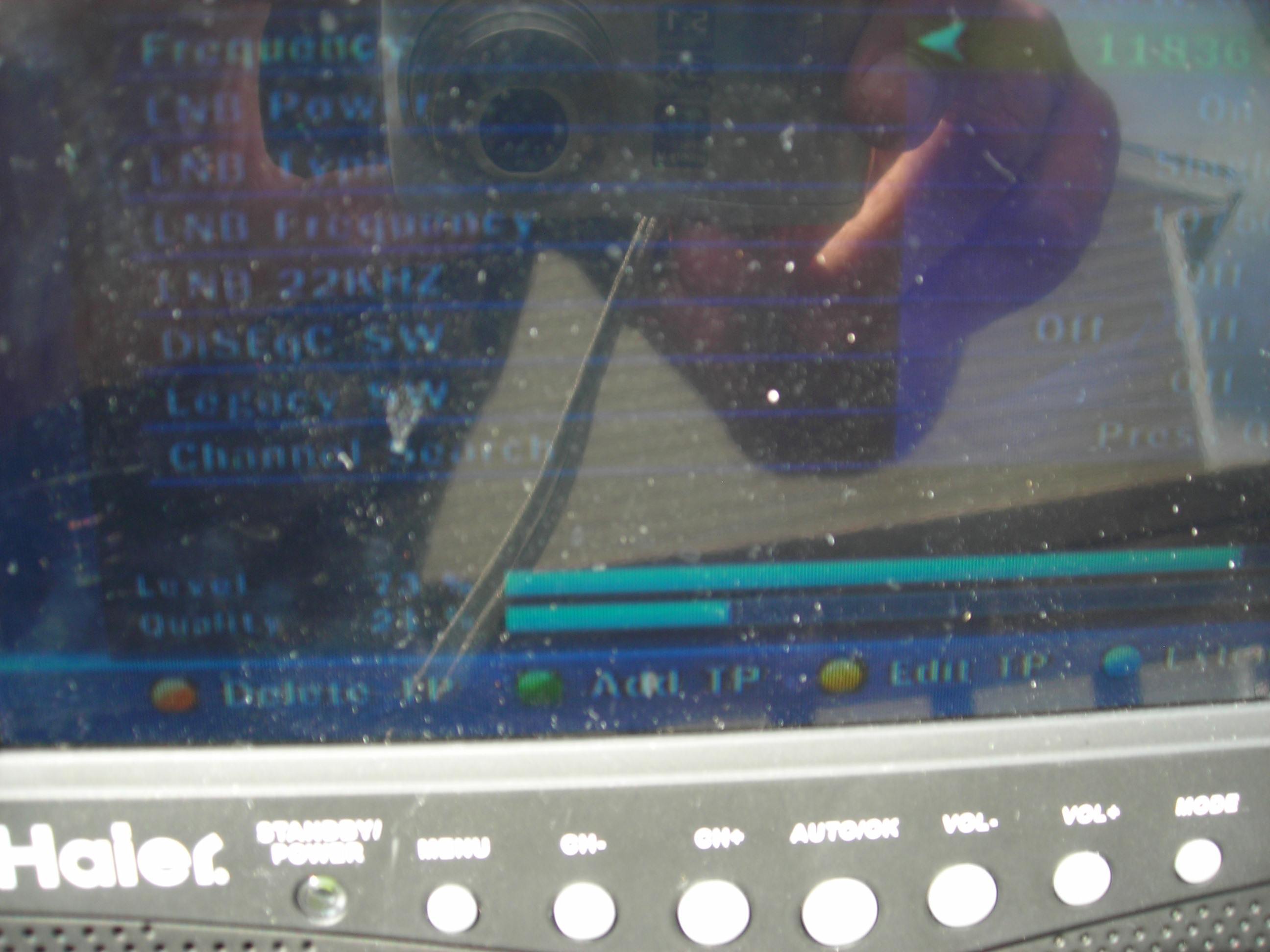

Here is a followup on my experimentation with a 18" Direct TV Dish with a Ku Band LNB and adapter bracket. I was able to get a 73 % level and 24 % quality. The TV signals breakup often but the radio side seems to be pretty stable.
I can't experiment with the Directway Dish due to the dish is in parts and the four nuts and the wedge and bolt needed to assemble it are missing.
But anyway...it was a interesting experiment...more later

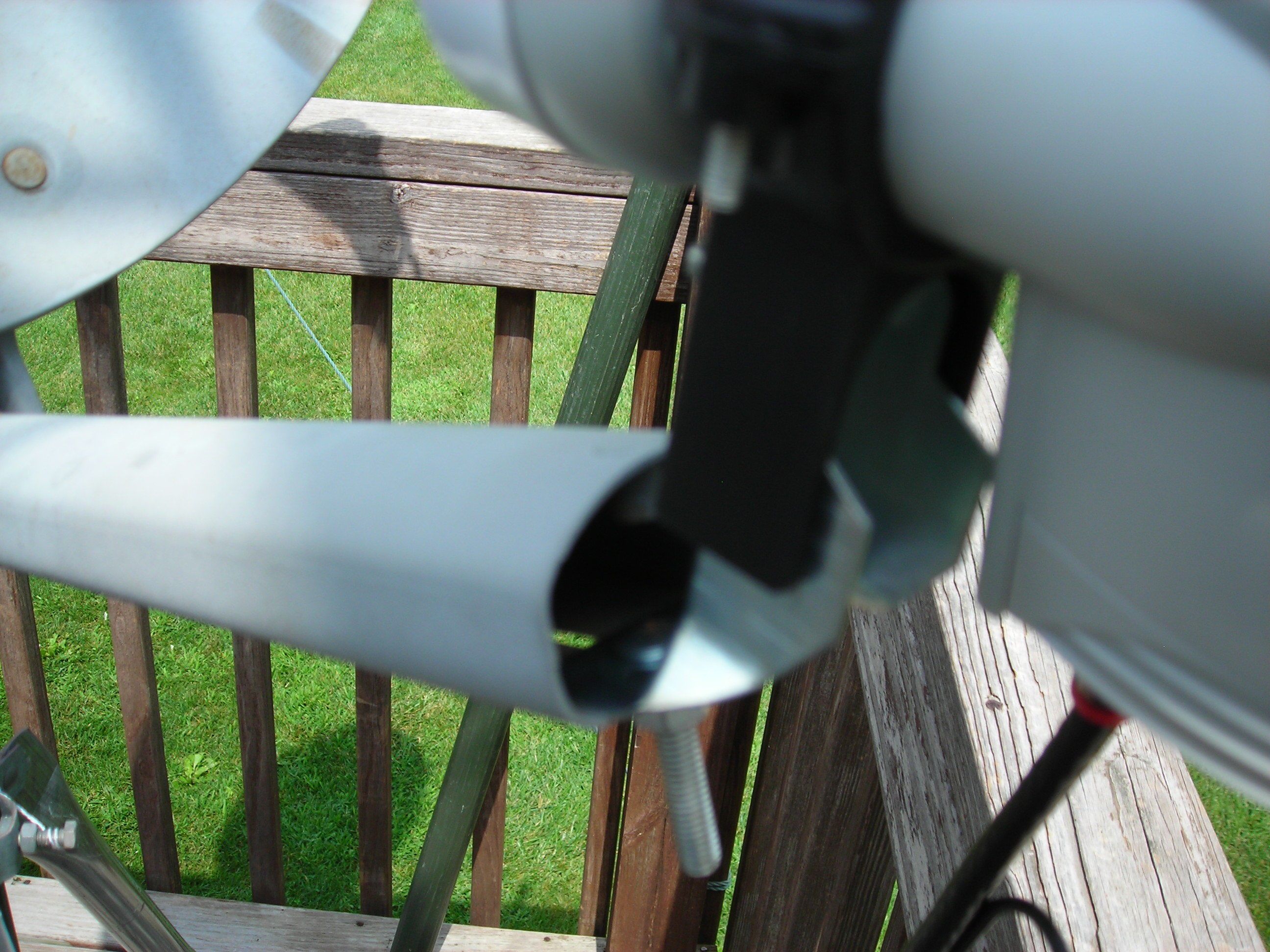

What sat/channel were you aiming the little dish to? Not too bad for an experiment.
