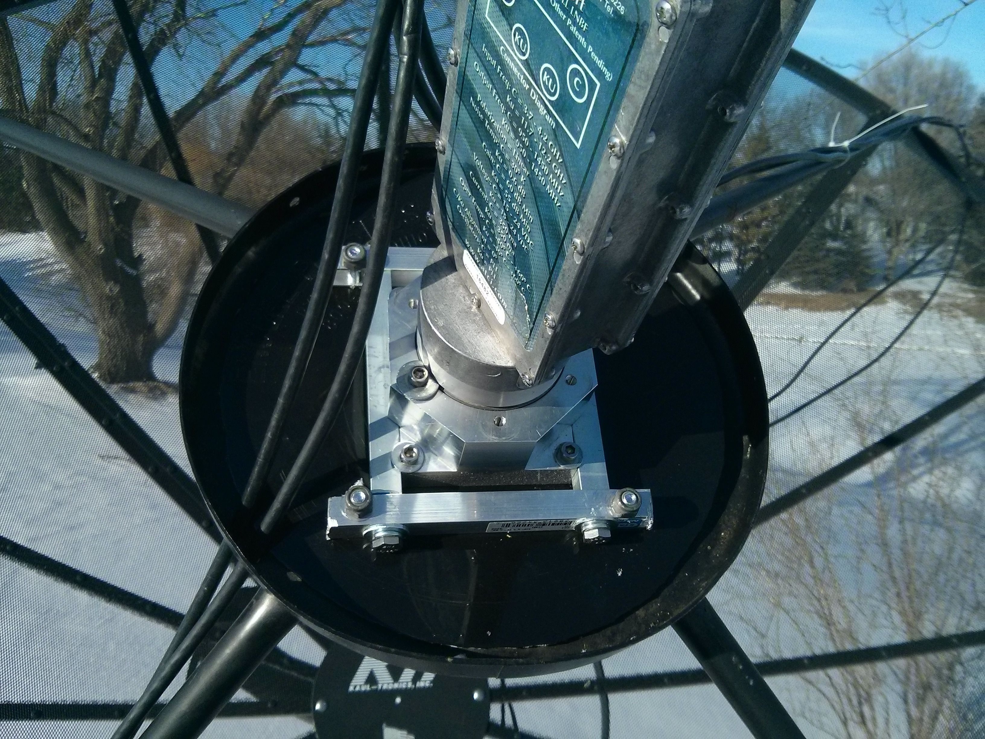

Switched out the Norsat dual Ortho setup for a Quadraport prime focus C, Ku LNBF this weekend. After messing around in this hobby for 9 years now, trying offset LNB's and several flavors of BSC621 I'd say the quadraport LNBF is the ideal solution (never tried the Bullseye II). My dual ortho setup was perfectly tuned and pulling in nearly everything a 7.5 foot dish can, so my goal was to adjust the quadraport to the same cband specs and hope the Ku signals would be good enough.

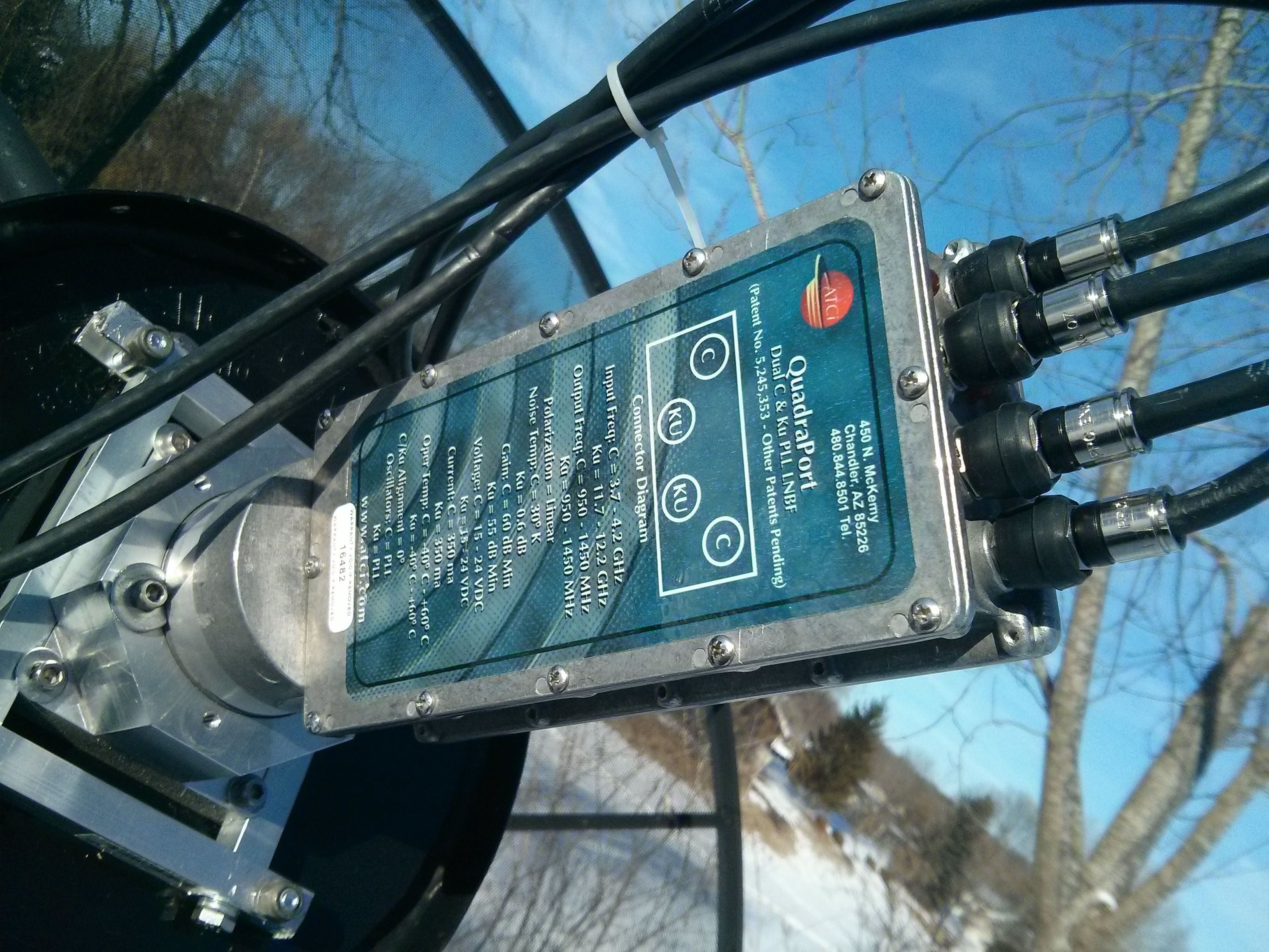

Information on the Quadraport:
http://www.atci.com/simulsats.html
http://www.idyd.com/page/view.asp?code=14&idx=134
4 outputs C-H, C-V, Ku-H, Ku-V. Two power circuits that need 15-24 V. It is designed for simultaneous reception on large dishes, where the LNBF slides on rails. I had to make my own mounting system from aluminum stock. Not much of a scalar ring. Apparently they are made differently for dishes based on focal point and f/D ratio, I have know idea what mine is set for.
I am using a modified Spaun SMS5802NF Compact 5x8 Powered Multiswitch to combine and power the 4 ports.
Results: Everything on Cband seems to be the same. CBS 29860 HD 422 feeds, everything on Galaxy 16, CTV, NBC/Telemundo, GCI on AMC7. Ku has been quite good. Able to get everything on AMC21 and 97W. I even get good Ku on SES-2, WTTG and LPB, come in.
For the most part all transponders will tune in at one exact spot with the actuator/vbox (C and Ku), but I only have 2 or 3 clicks of leeway (dual ortho seemed to be wider beamwidth, meaning 3-5 clicks of leeway).
To do... investigate more signal across the arc, figure out how to weatherproof and power Spaun switch at dish OR investigate stacking solutions and in house power supply for LNBs. SES cband issues... Also noticing lower than normal Strength reading on certain satellites (not signal / quality), thinking there could be issue with cband noise. EDIT: SES-2 issues were azbox / luken related. Still need to adjust a bit more to get CBS 9/10 transponders. Changing out multiswitch for one with lower noise / weatherproof housing.

Nice project thanks for the pics.

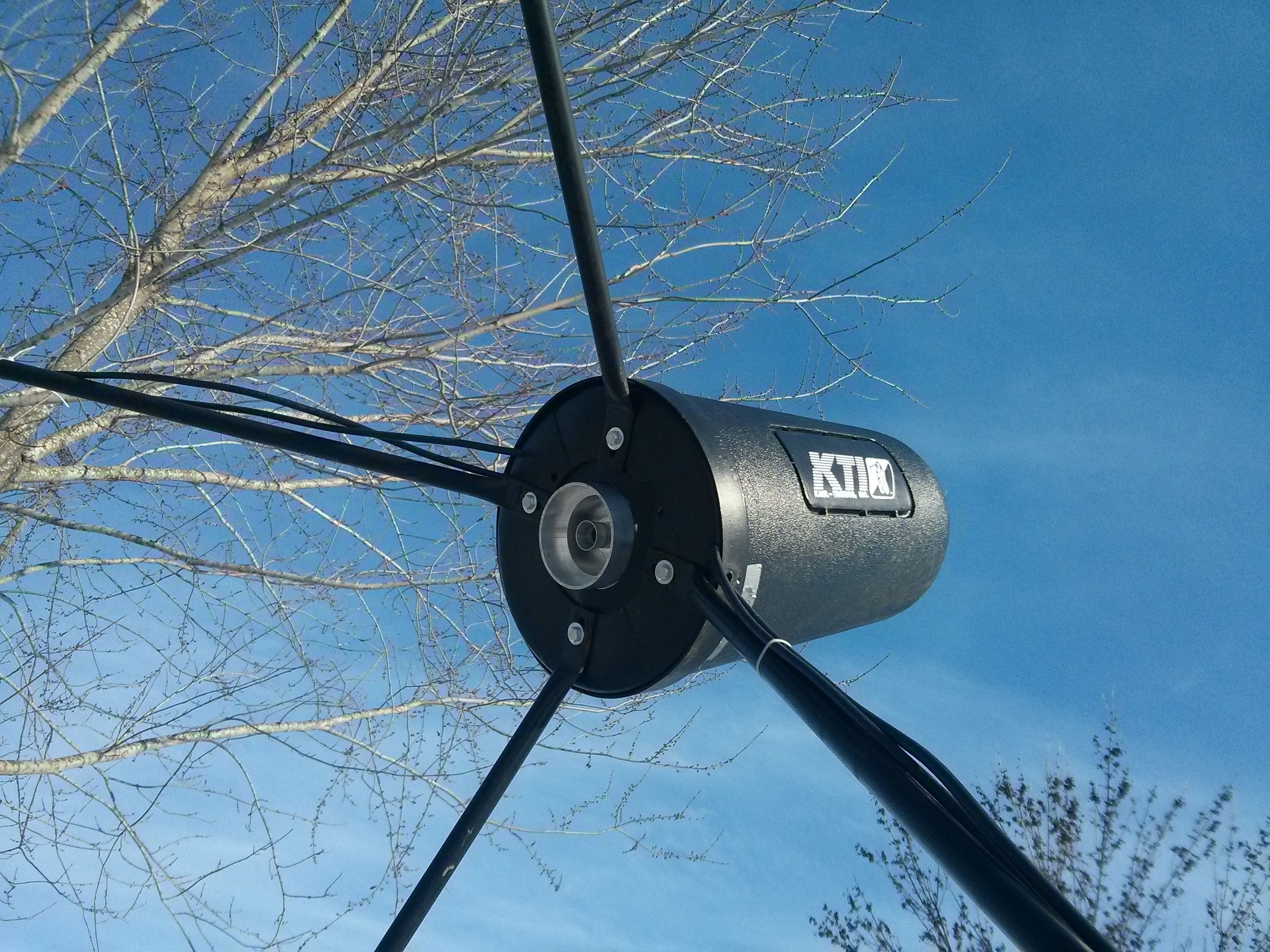

The feed side reminds me of the National ADL RP1-CKU feed I used to use. Similar but not exactly
That beast must have set you back some moola.
Reducing Sidelobe reception can sometimes be had by setting the F/D on the feed a bit higher than what is calculated. .36-
.4 instead of .34 for example. At the cost of some gain.
UGH. Appears to be not adjustable by what I see.
ref:
http://adlfeed.com/fp_feed_pat.htm

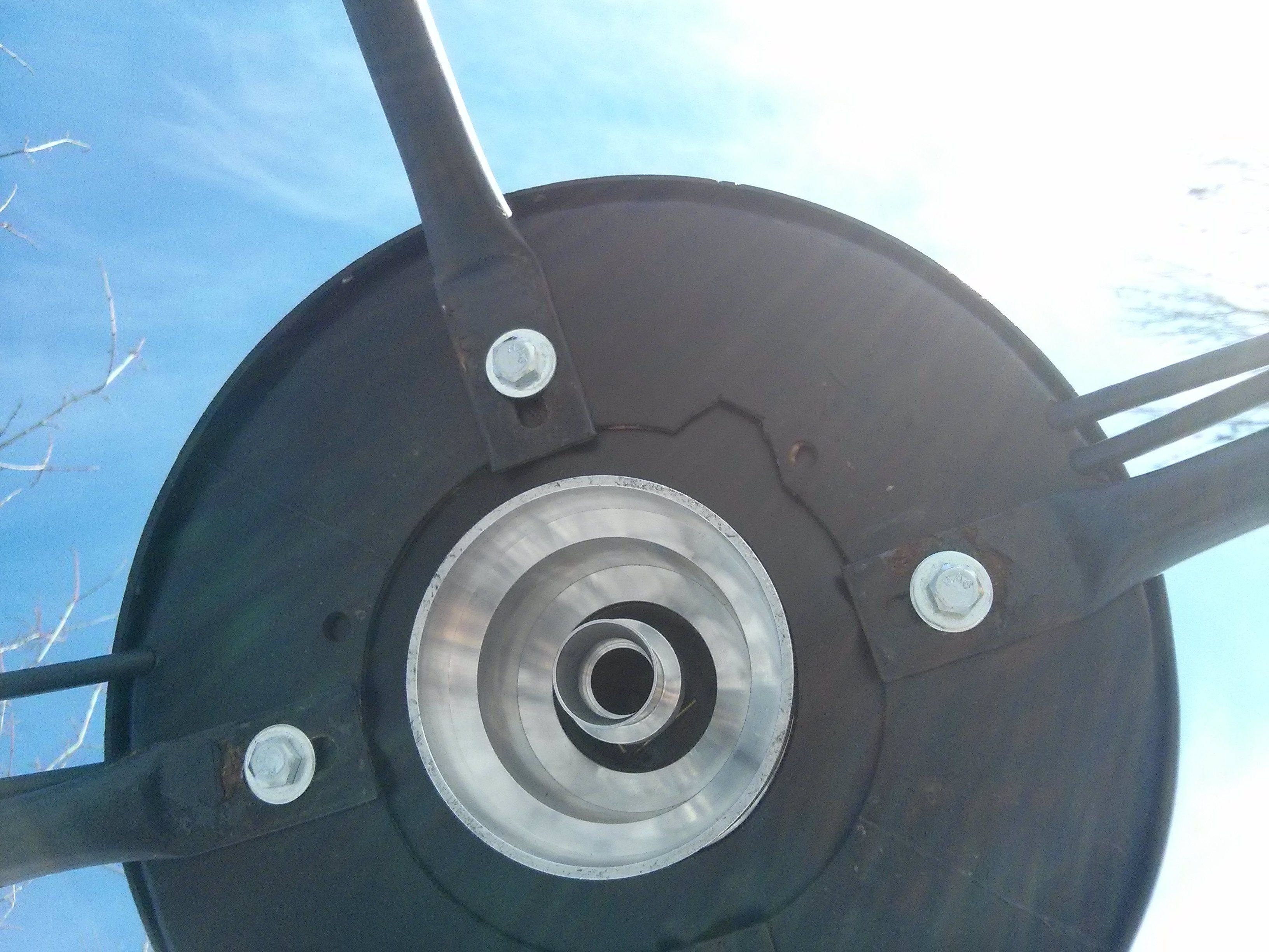

does that ku waveguide extend past that first step in the c-band sortof scalar? if so, bout how far?
He uses a modified multi-switch to power the LNB(S). I use a modded switch to power 4 PLLs on a Bullseye II. The FTA box can't tell the difference :). The multi-switch still senses what the receiver wants and switches to the correct LNB.
Could this concept work for the older Birdview highblock LNB's where voltage was fed UP the horizontal side only, but always "on?"
These were the later ones, compatible with anybody's receiver. I've always wanted to play with one of these and FTA, but didn't know
if a power/polarity self-switching system could work! I have a bucket with many multi-switches in it....if that can be made to do the same!
Just dreamin' ...probably easier just to get one of the new PLL C-band LNB's and call it done, take Ku off the big dish.
The C and Ku power systems are independent and are powered via either of their output ports. So any multi-switch will work as it will get the 18 Volts from the H port (no power inserters needed like Bulls Eye 2). As it turns out my modified power inserter is not needed, but I did this because my previous setup needed it.
Yes the Ku waveguide extends into the "sort of scalar" part of the feed, about 80 mm further than the start of the cband feed.
I might try adjusting the focal point by adding longer screws and then counting turns on all four bolts... might be a PITA to do.
