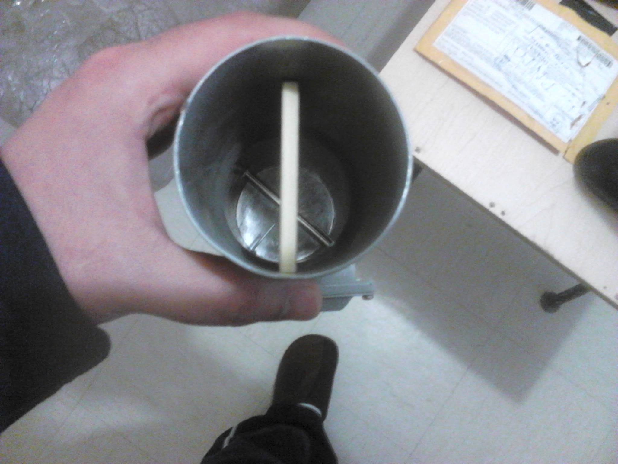

Hi everyone, I was trying to catch the SES6 but that bird is circular so I need a dielectric plate for my LNB, but the problem is that I don't had it, I know most of you will tell "cmon they are cheap just buy one", well the problem is I live in Mexico and no one sell them here, I searched the net, but only on ebay sell them and the shipping price to mexico is ridiculous $55 shipping for a $10 plate, So the question is, Can I made a dielectric plate with something that is on my house? Or I should go on and buy a complete lnb with the dielectric plate included(ebay price $75 shipping included)?

You can make one also, I used a credit type card when I made a linear ku lnbf into a low band circular lnbf.
If you have the outer plastic shell of a Bic Pen, they can be cut or filed down to the correct length to fit into your C-band cavity. Just make sure it is installed halfway between vertical and horizontal wavefront (45 degrees from either) by first testing polarity on a nearby satellite such as 37.5, 43 or 45 West.
I've found that some LNBFs have different sized dielectric plates, because the throat/opening is a slightly different size for some LNBFs. Something to consider.

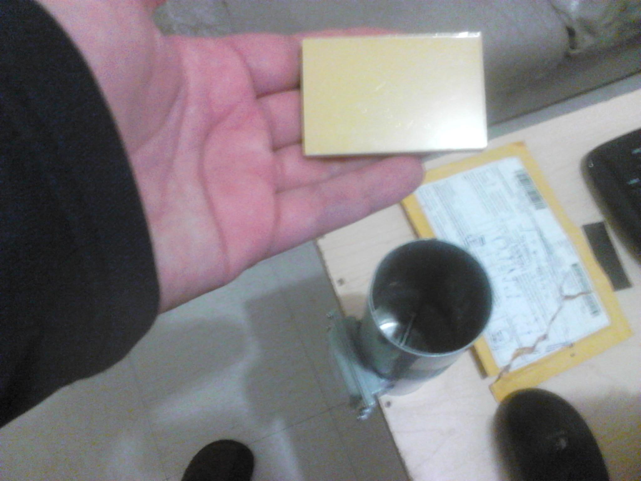

Hi everyone, I just received the dielectric plate that "TITANIUMSATELLITE" sent me for free, and it fits perfectly (see pics below), thanks again guys, also I did some test and I got 40% quality, I need to do some fine alignment, but at least I can got a few tp, also I tried using a old credit card as one of our members said, but I can't get over the 25% maybe if we use 2 credit cards I don't know, So far I just want to say thanks again to TITANIUMSATELLITE for the free plate, and everyone for their ideas, I will do a new post once I had free time to do some more tests, and I believe this concludes this post.
