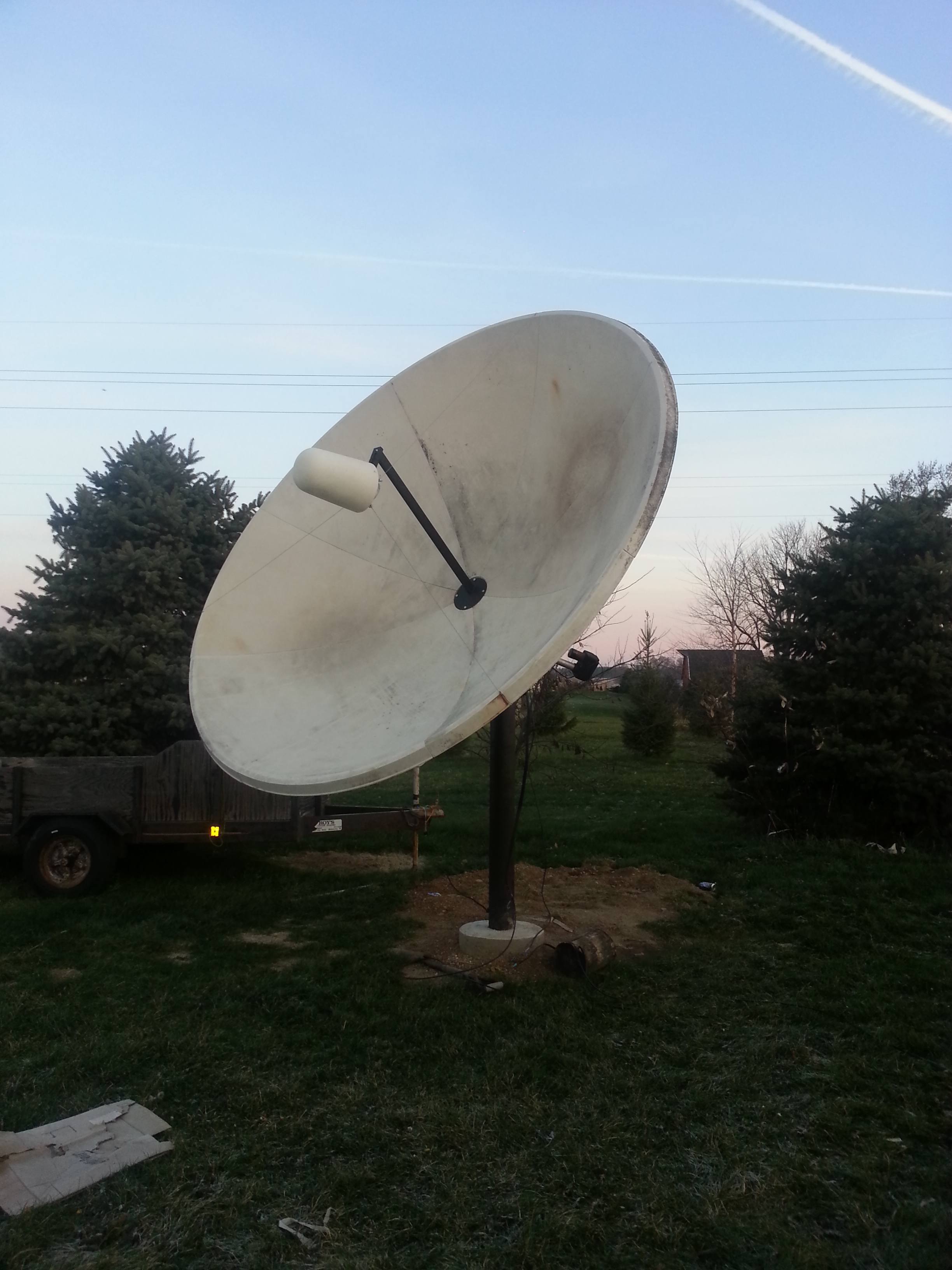

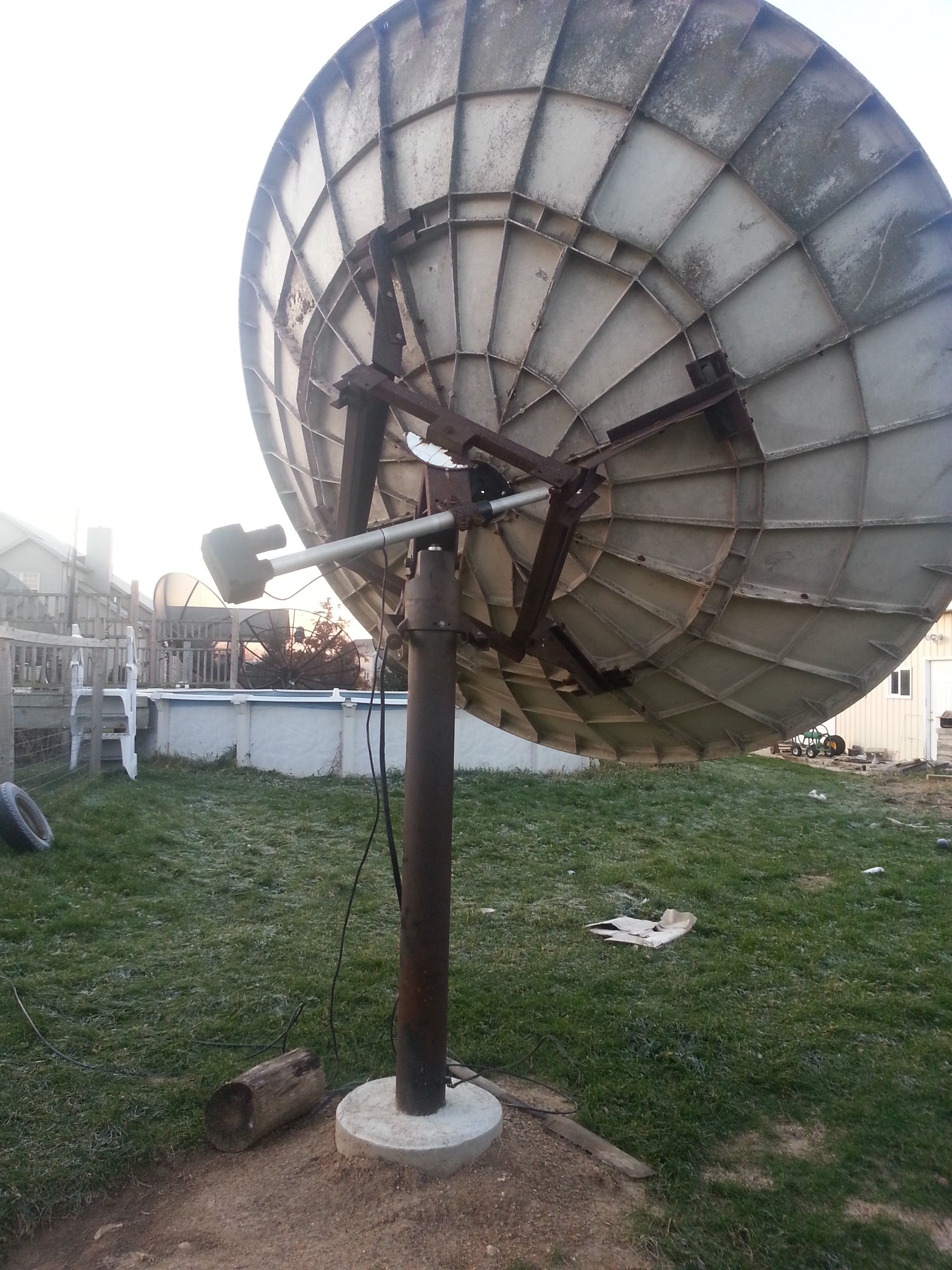

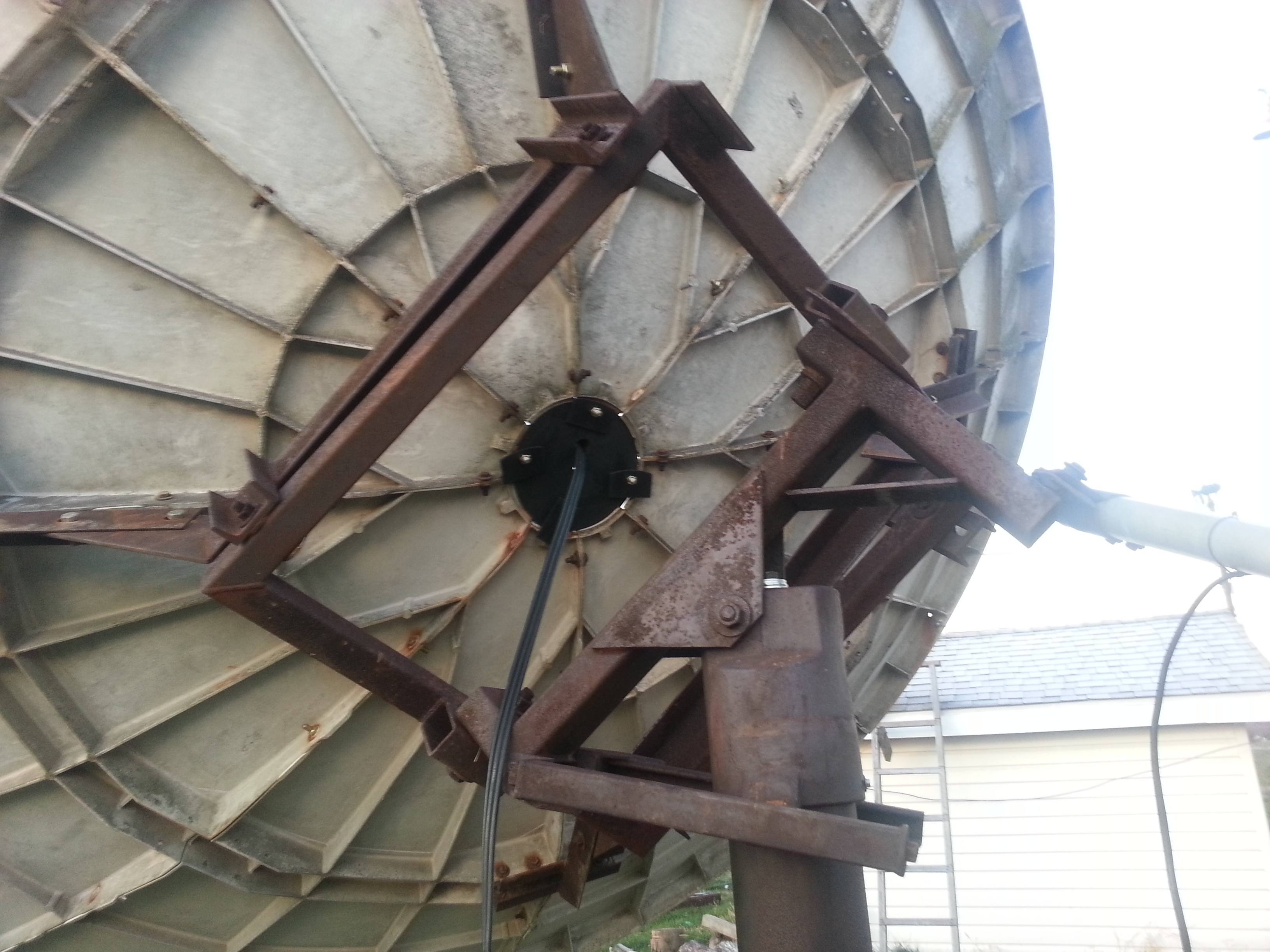

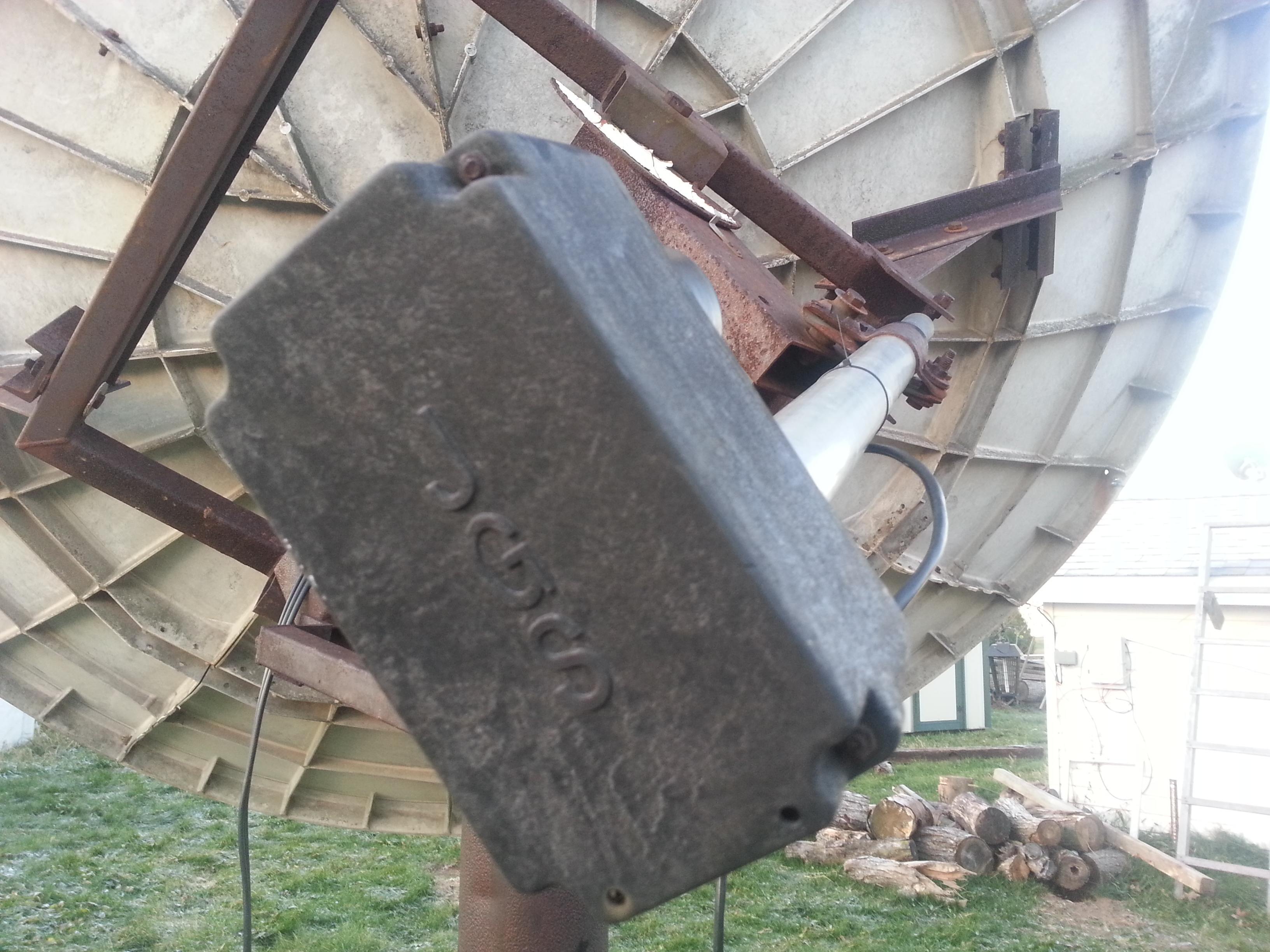

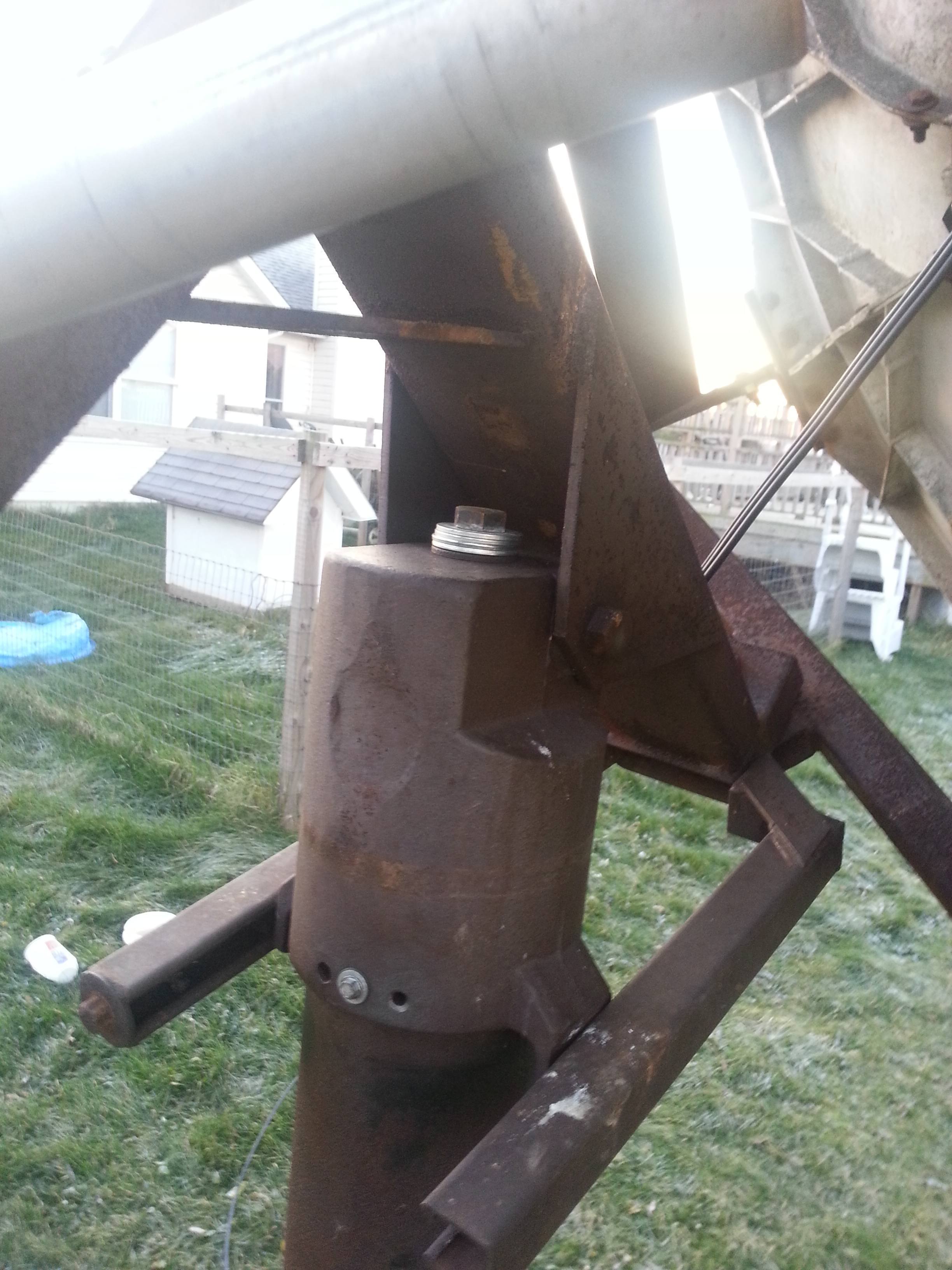

Heres pictures. I got the dish from just down the street. It looks like it was pointing at 74W when I took it down. I thought it would keep the arc when I put it back up.

I would start over and use 83W to start with then start moving east and west adjusting just your az. Make sure that pole is not moving at all and is plumb. I had one do the same thing one time. What was happening was it was fine on one side(I think it was west in my case also), then east it would start losing it. I kept scratching my head cause it was almost perfect for all of the sats to the west, so why is the east going crazy? Turns out the weight of the dish was causeing the pole to move slightly as it came over to the east.
LNB cover angle??? Hope the feed horn isn't on that same angle?? Could be I'm seeing a parallax error from the photo but it looks like something is really wrong there.
The feed horn is on straight, the disc it screws into has a broken bolt. That's the next thing on my list to fix.

That feedhorn must be centered also. If it is sagging that could change your effective elevation (may also be your issue). A lot of people use guy wires on the feedhorn to solve that problem.
