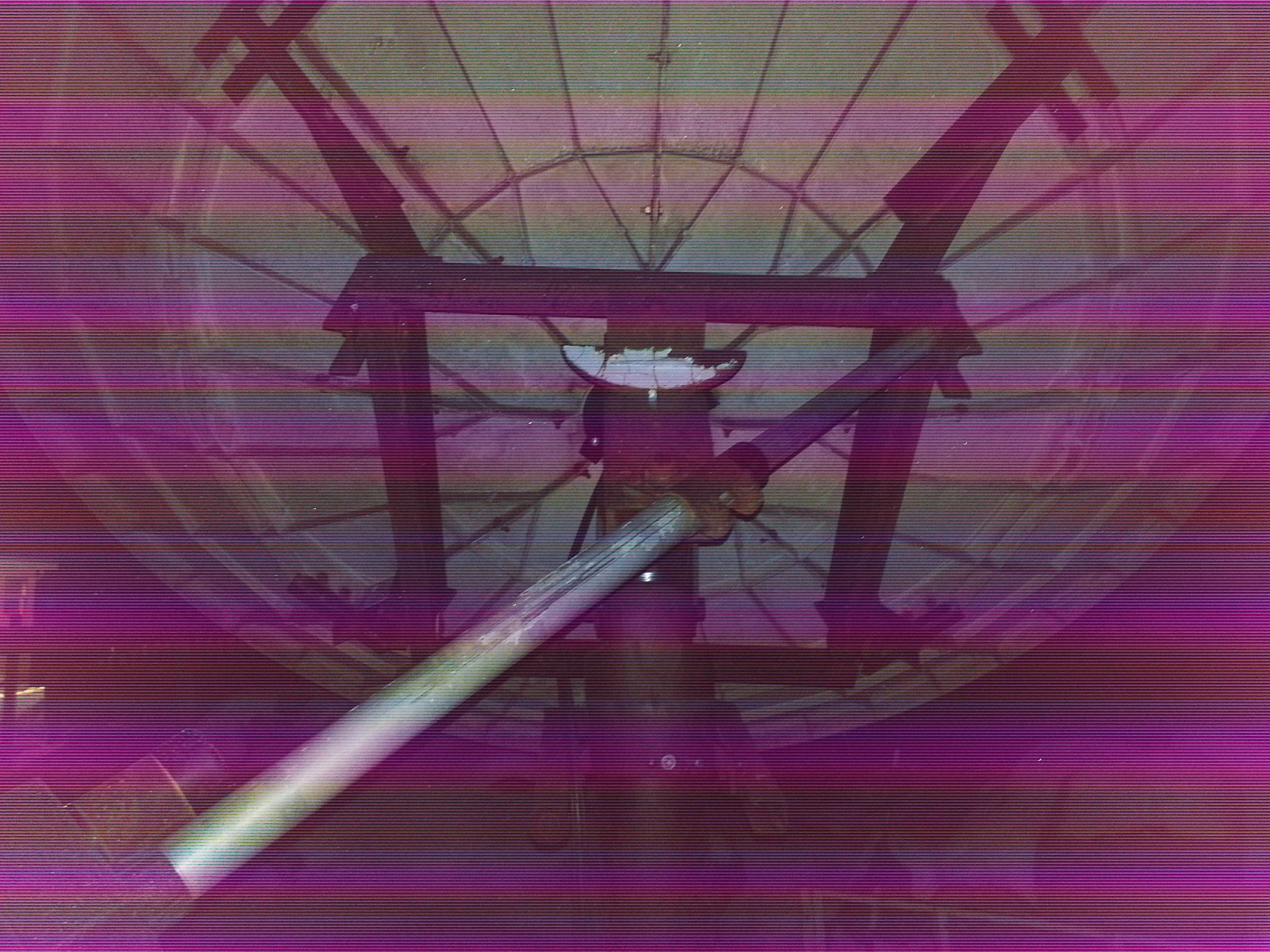

I have been reading back in this thread and it seems to me that your elevation is still off. My guess is that when your dish is at its zenith you are aiming high and to the east. According to google earth, N liberty Indiana is at 87 degrees west longitude which would make your true south 87w. When your elevation is correct, and the dish is at its zenith, you should be able to rotate the polar mount on the pole and find 87 w. Once that is correct you will be able to see sats on both sides of the arc. Even if your declination is off, you will still get sats on both sides of the arc near your true south sat.
Here is how it looks when aimed at 87W. I'll try lowering the elevation tomorrow and see if that does anything. Sorry about the bad quality picture, this phone has been to hell and back countless times. 20140211_222039.jpg
