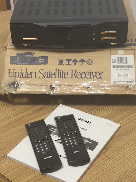

Update I found a brand new Uniden Supra Receiver still in the box manual and 2 UHF remotes.. I paid 50 bucks for it, when I open the box the unit still have an old VC Plus 2 decipher in it.. of course that was the first thing I remove from the receiver I connected and programmed all the satellites it works fine except for one problem the unit has been sitting for over 20 years in the box, and the motherboard battery was dead so when you save a bird and unplug it will lose it.. So I ordered the motherboard battery.. But what a great fine...
