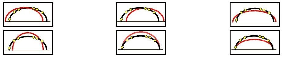

Probably your motor is, in fact, just very slightly off the arc. See attached image. When that close, especially with a motor installation, don't try to physically move the dish any more. Very slightly edit on your receiver the orbital position of 125W only and I'll bet you could get full signals from PBS and you won't affect any other satellites.

Makes sense. The motor is set to 43 degrees (same as my lat). I really dont feel like going up and down a latter for the next 2 weeks adjusting the motor 1 degree at a time.

Don't edit your longitude configuration for your USALS on your receiver since that will affect all satellites. Only edit the 125W position in 0.2 degree increments in the Satellite List on your microHD.

Because his problem is only due to a miniscule error. In theory, you're correct. In reality, I'll bet it works. The reason is because changing the azimuth by a teensy amount changes the view of the satellite. That's my scientific analysis.
