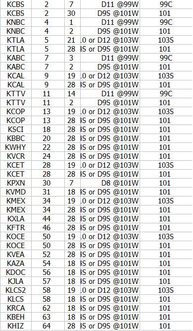

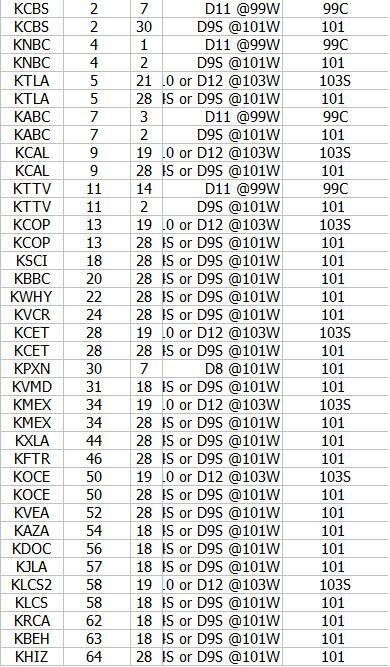

I was looking at the list Iceberg gave me and was surprised to see that KTLA is on D10 as well as as KCOP and KCOP but on a different transponder, 21 vs 19 for the other two. If I am looking at 103 for HD and can get KTLA but not the other two does this make a diffrence because of the 19 vs 21 transponder? It would seem if I can get 103 then I should be able to get all of the transponders. Please enlighten me and show me the way. Thanks
Is 19 spotbeam? Did they tighten up the beam over last year? This will stop me from going nuts over why last year no problem and this year a problem. Thanks
from the list I have all are on spotbeam except for the Big 4.
If you look at the attached pic right column it shows the sat
99C means 99W conus
103s means 103W spotbeam
101 shows the 101 satellite but to the left the satellite says "D4s" or "D9s" which means the spotbeam sat

Thanks Iceberg. I now know these two stations are on spotbeam and they probably did something to tighten up the beam. Last year I could pull these in 500 miles from LA with no problems. This year, nada!
500 miles? Wow, that's a lot further than I thought any spot beams reached. Where were you when you got them that far away?
