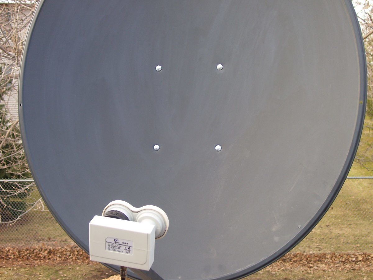

Since your dish is stationary and aimed at AMC4, there is a very simple solution for you to get G19 (97W) without moving your dish or adding a motor.
The solution is this:
You will be able to receive signal from two satellites at once with this Mono-block Duo LNBF.
Easy to install & setup. In your case, just clamp the left side LNBF on this unit. That will be your AMC4. Adjust the skew a couple of degrees. The right hand LNBF will receive G19. The unit has a built-in DiSEqC switch. Setup your receiver accordingly.
Rec'd the above item today, some issue setting up, don't reallly know what I'm doing. Clamp left side LNBF on unit, is that left facing dish or from the back of the dish? I would think facing dish. I have tried both ways. Also what settings do I need to change in receiver setup. I have several Coolsat receivers, the one I am setting up I believe is the 6000.
The left side is the one facing the LNBF as you look at the picture above. If you are standing behind the LNBF facing the dish, that would be your RH lnbf.

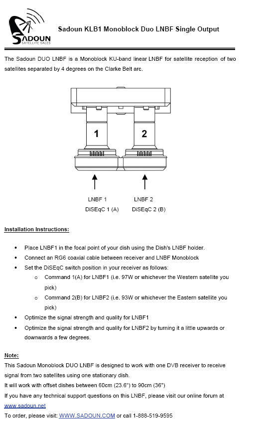

Since these are UNIVERSAL LNBFs, you should set your LNBF type to Universal:
LO Low: 9750
LO Hi: 10600
22KHz: ON
Then setup the DiSEqC switch commands. See attachement:

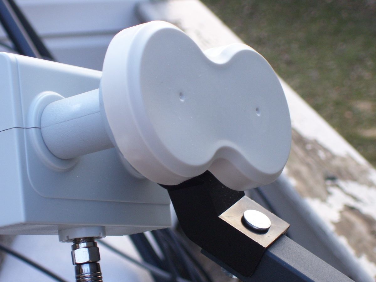

I can't seem to get this right. Now that I think I have it set up correct, when I scan 97W I get the AMC 4 channels and when I scan 101W the only thing I get is an Echostar test pattern. I must have it backwards. Looking from the back of the dish towards the LNBF I have the right hand LNBF in the holder is that right or wrong? Thanks for the help!
that is wrong
when using multiple LNB's they get put OPPOSITE of how they are in the sky
the left LNB should be on 101 if behind the dish. This puts 97 to the RIGHT when looking behind the dish

This is still very confusing to me, but I will get it. So what I am getting now is 101 and 105. I will have to reverse.
correct
you are getting 105 & 101. Move the LNB so the right side of the LNB is in the holder
