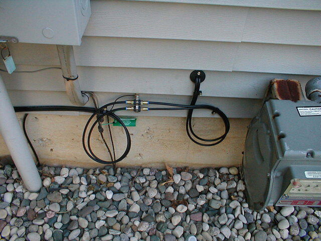

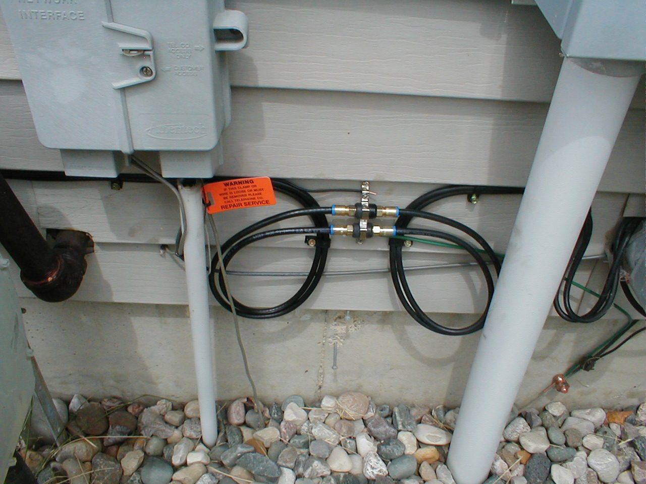

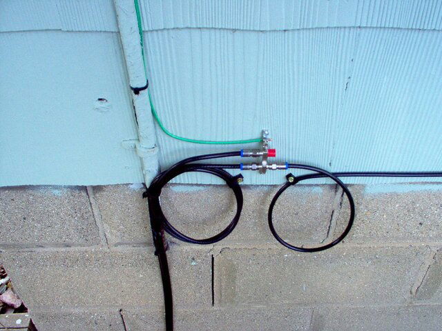

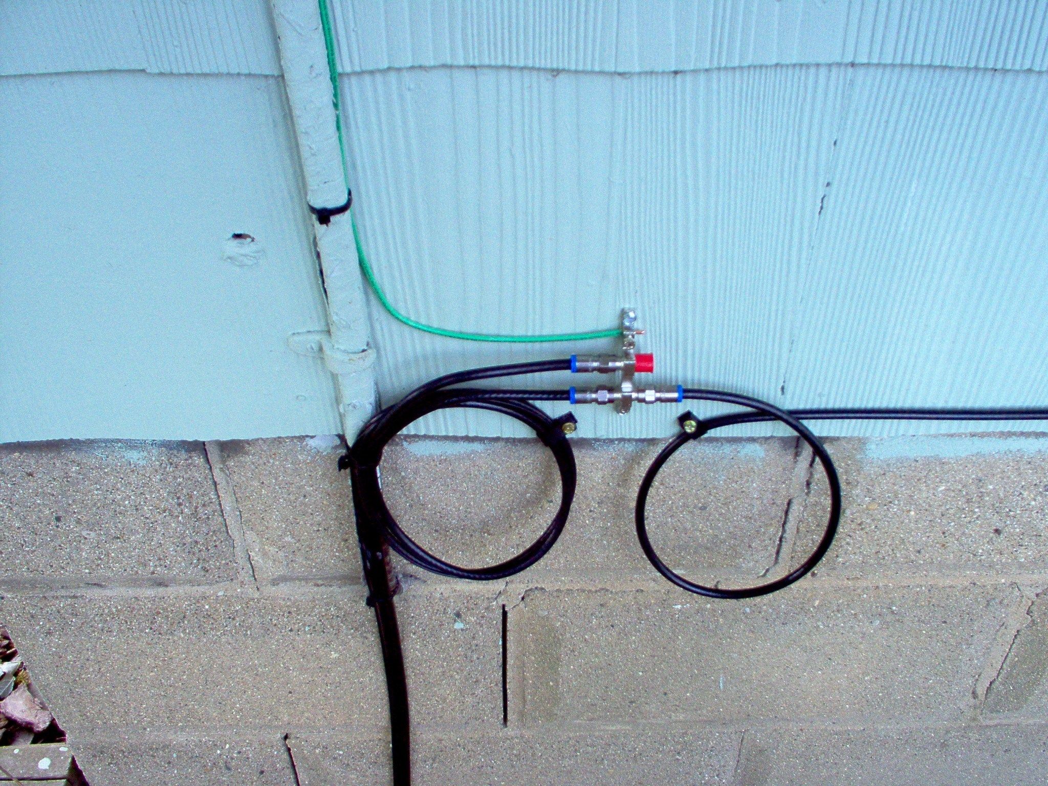

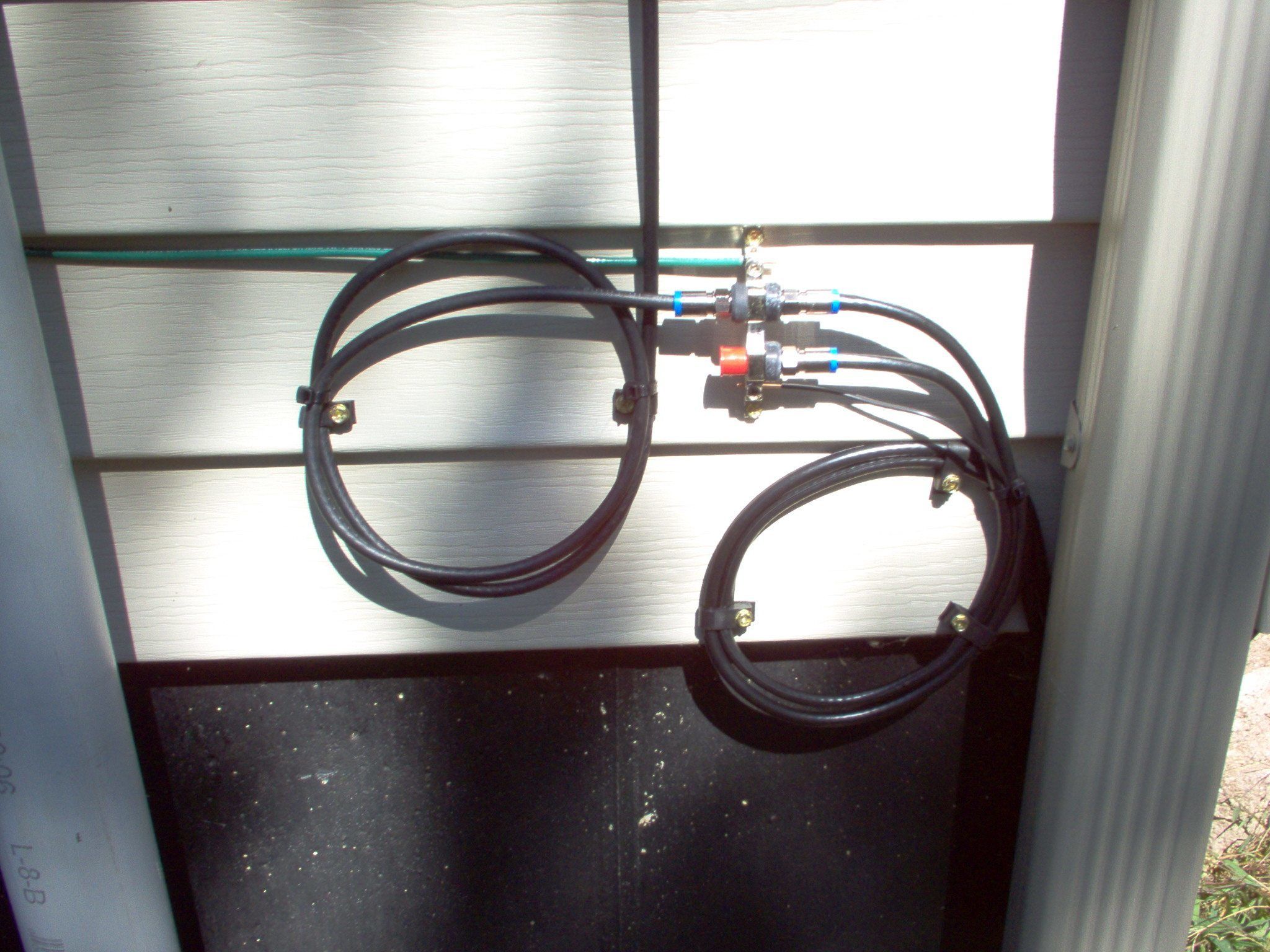

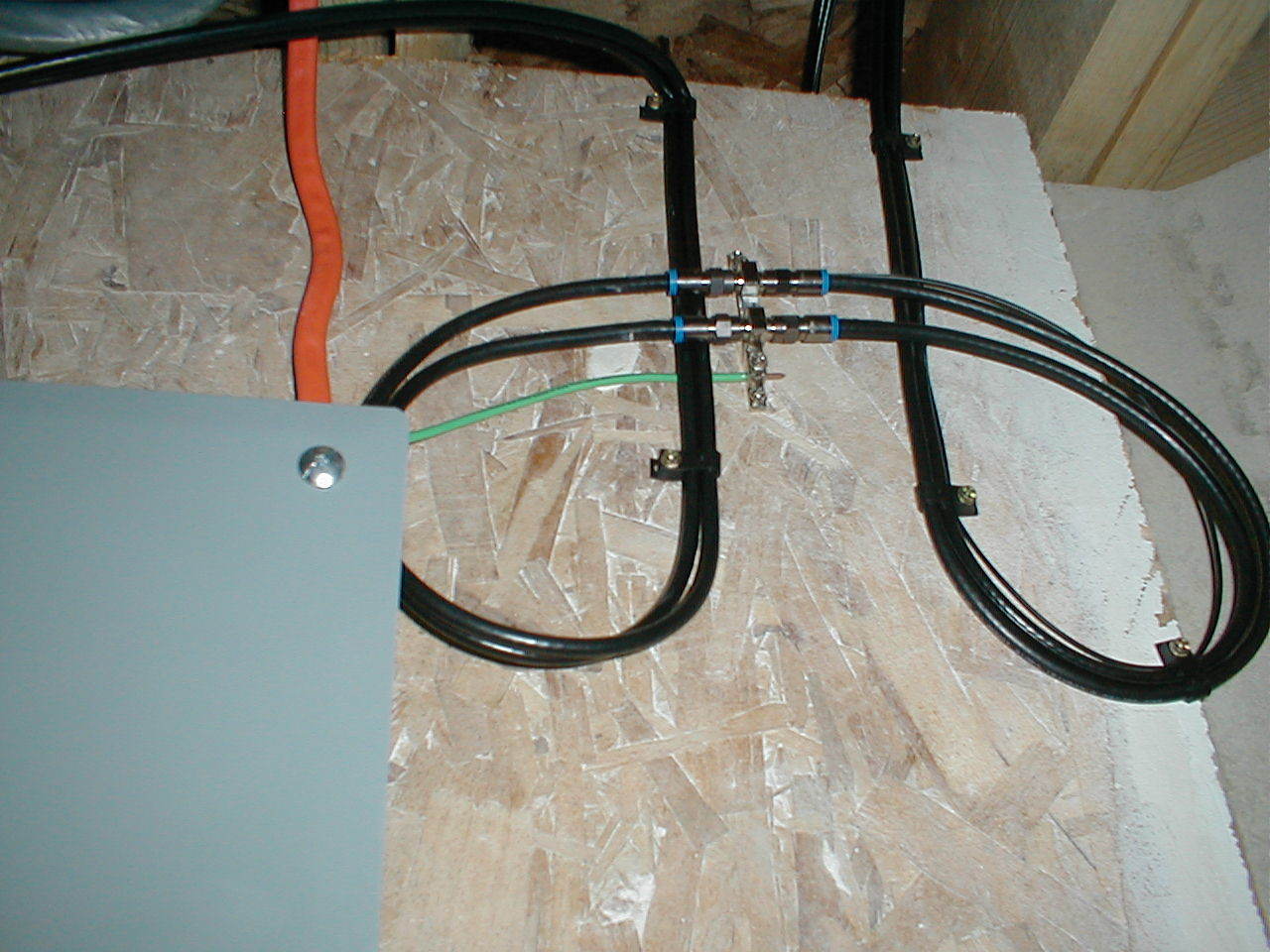

MPORTANT: The United States National Electrical Code specifies that coaxial cable that is exposed to lightning shall be connected to the grounding system of the building as close to the point of cable entry as possible.
With this in mind. Why don't E*and D* Techs follow any of these rule. I've yet to see a grounding block Grounded.! None of my systems are!
This is why good installers have such a hard time. There are to many poor installers in the field, that get away with this kind of stuff. You have been lucky enough to get the poor installers and not the good ones.
Before somebody jumps on here and starts the retail vs. dnsc vs. subcontractor thing. It does not matter where the tech comes from that will say if they do a good job. You have good techs and you have dab techs, and they can work at any one of the above.
Here are what some grounds should look like.

Thats nice Work!

Mine looks very much like your fourth picture (after being redone by the most recent installer). Except the green wire is connected to a separate rod that is sledgehammered pretty deep into the ground. Prior to the rework the cables just came down from the dish, made a shallow U, then went into the house. At least they were sealed with silicone where they went inside.
