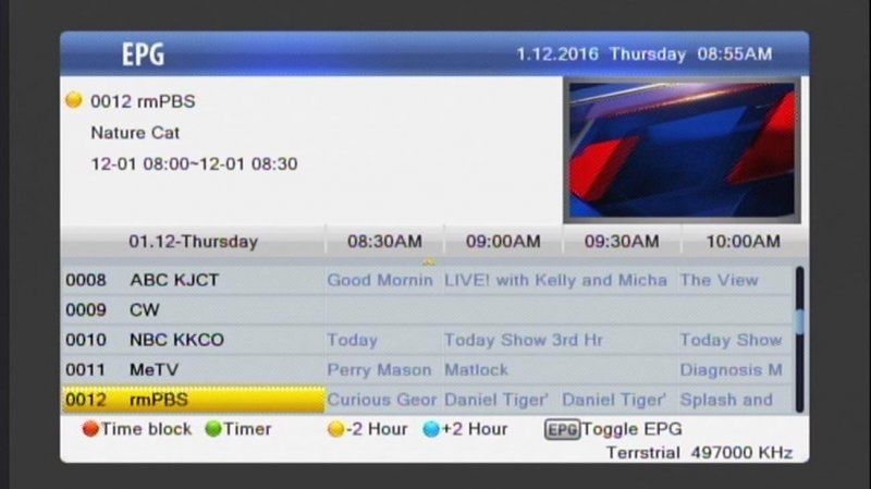

I've been playing around a bit with my 9000i Local. It's a good box so far. I'm hoping it'll be good enough to eventually replace Windows Media Center as my DVR, since the box will use a lot less power than the PC.
Until I get a bigger hard drive, I'm using an old laptop drive in an enclosure. The box has no problem powering it through USB (no external power for the enclosure).
The OTA EPG is pretty good, but not fantastic. So long as the channel is broadcasting the info, it'll load. It seems the longer you're tuned to the channel, more programming loads. However, if you turn the box off it forgets the EPG. It'll also forget the EPG if you mess with the clock. To record a show simply highlight it, hit the green button, and save the event.
(poor picture quality in the screenshot is from the capture device, NOT from the receiver!)
The OTA tuner seems a bit more "forgiving" than the two Hauppauge tuners I have (or it may be my PC software). If a signal is weak on my PC the video will freeze up, while the Linkbox will play it as much as possible, with more "garbled" video and audio that you can kind of follow. Just like on the FTA side, if you scan your antenna channels in again, it'll rename everything it finds.
